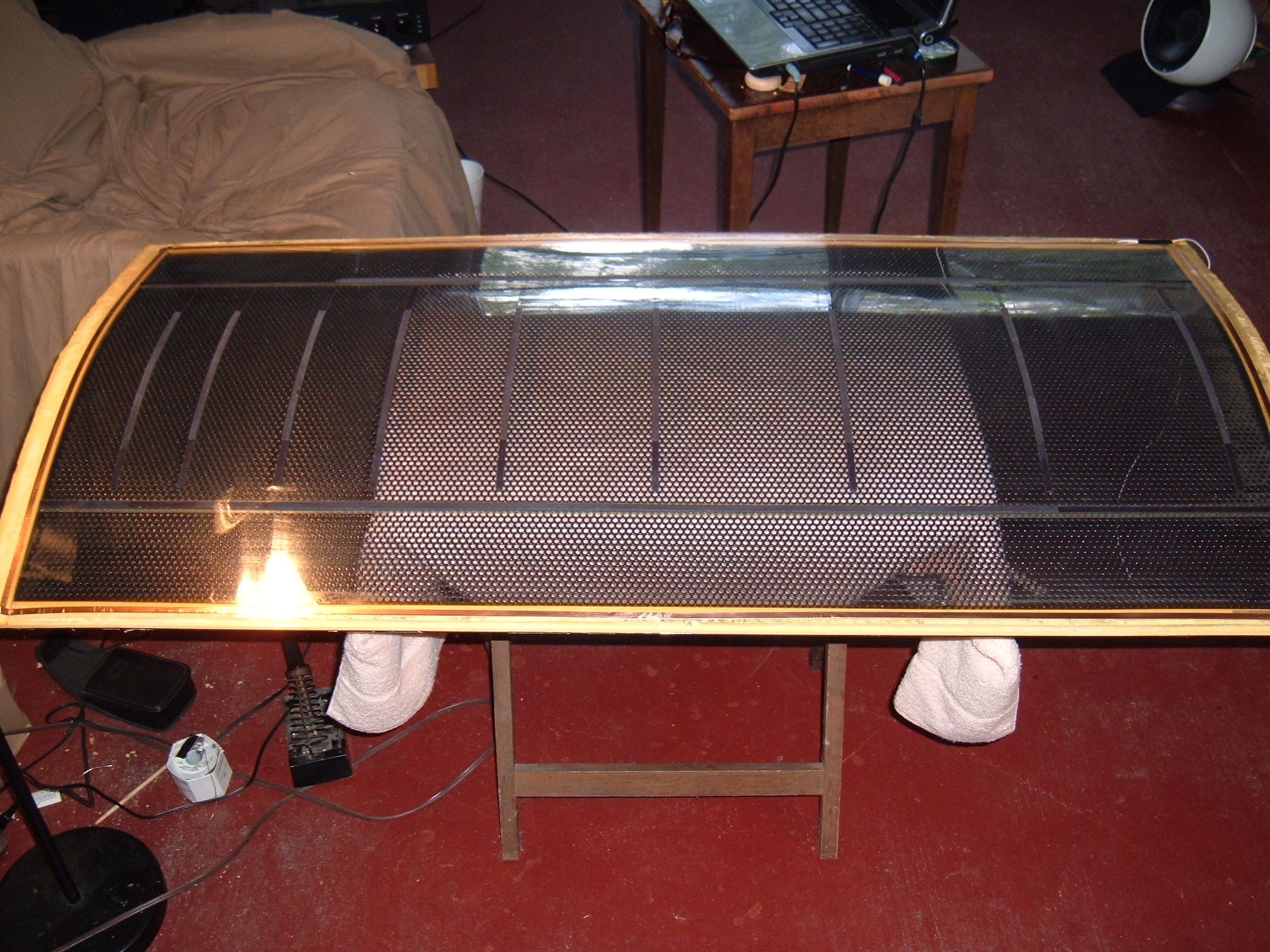

There are patches of parallelogram shape and a slanted H shape adhered with the left and right sides on the inside of the backside stator of Martin Logan CLS2a. They are made of a similar material to the diaphragm. I think they are dumpers for diaphragms of bass sections. Please let me know the function and effect of those patches on the frequency responses and/or distortion? Did anybody compare the presence and absence of those patches?

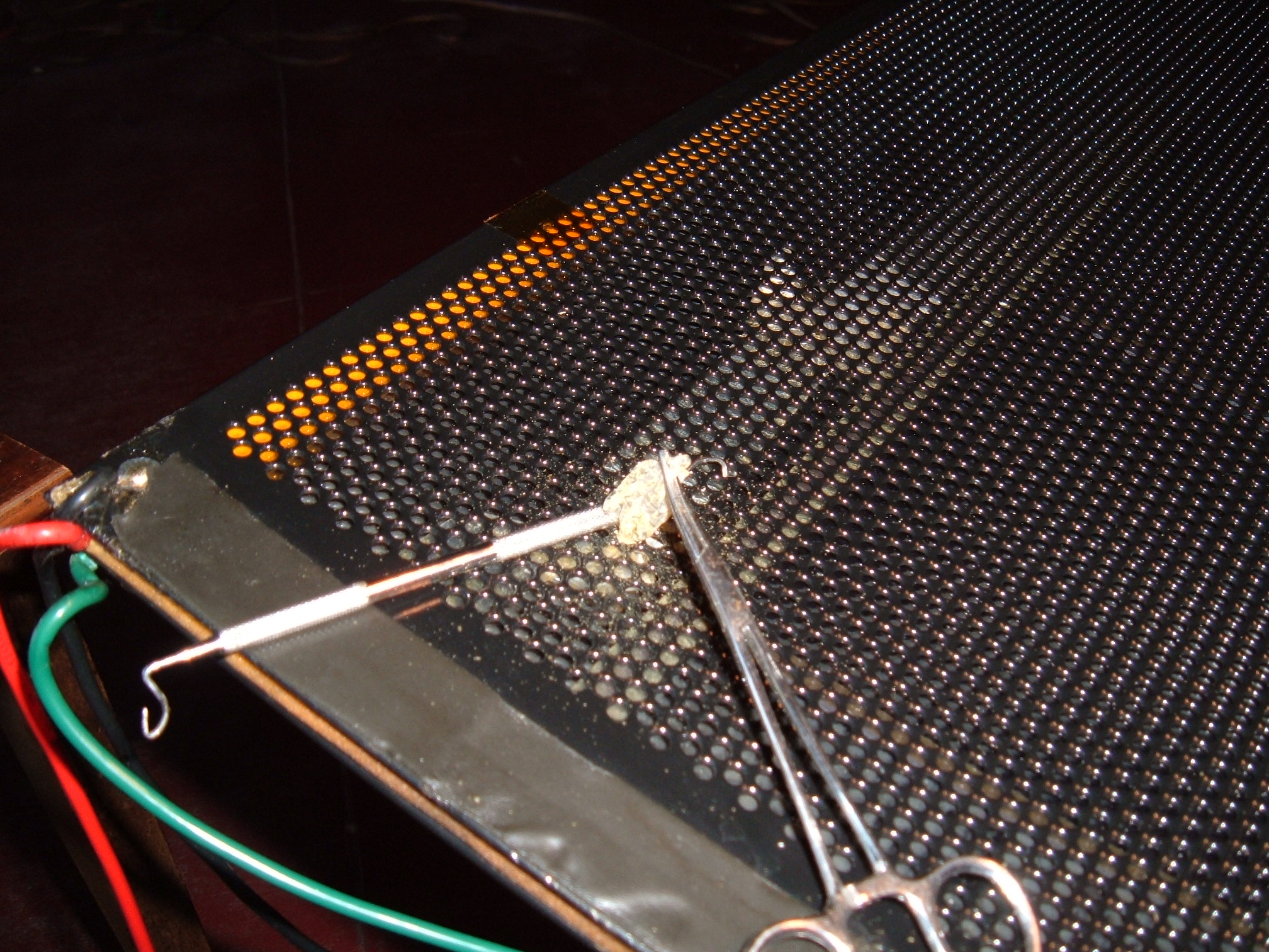

For years I have spoke of how ML put so little bias feeding copper tape on the panels mylar.....on the 16"-12"X 46" just one side...
After reworking The ML CLS panels.....there is some thing here for a ESL panels Diyers.....
The CLS has bias feeding copper tape running ONLY....down the sides an across the bottem....NOT the top....I look at this an side it must run all the way a round for best bias feeding an to get full out put....
So I got new copper tape...an put all the way around....well,i was shocket!
I lost some of the high frec magic.....No how could this be...it work great
sounded vary good.....but...but...some thing was missing..
Could it be.... that any thing put on the mylar even on the sides ,top an bottem... after it was it was stretch tite....an ready to put the coating on would change the sound......YES....it made the mid move out more...at frist I like it....but I had to go back pull the top copper run out.....to see if I was right...that I had lost something...
An the sparkel was back....Less is more ...better image ,sweeter tone, you may think this is a little thing......IT NOT...
All just one mans finding...my reworked CSLs

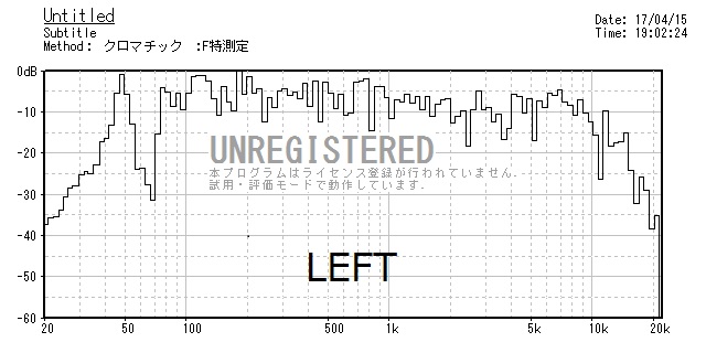

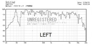

I have a pair of junk ML CLS 2a. The sound was favorable for me. They had rather flat response but with a certain level of distortion. They produced sound of more or less 75 dB, about 10 dB lower than the QUAD ESL 57 pairs that were briefly repaired by myself.
Now one of the pair has been disassembled.
I will remove the patches on the backside stator, since I will be able to stick them outside of the stator afterward to compare their presence and absence. I will also try different ways of stretching the copper tape as you've suggested.

Sounds like low bias....I put the Acoustat type 5k bias in all my CLS....going to day to get a pr of CLS 2....So more work for me is a head....
Also I never pull the ML stock mylar....you well never get the soind ...or out output.. with new mylar!...even if you have to replace mylar...new bias feed copper yes, always.....it tuff to get to work right....I only pay vary little $$ for ML...if mylar rips...I get only parts...I never re-mylar!...
I re-coat the stock mylar..right at the new bias feeder an panel..Soap & key cabon...I NEver re-glue the panels back to gather...the frames well hold them togather.. I use tape on the two sides.....good luck

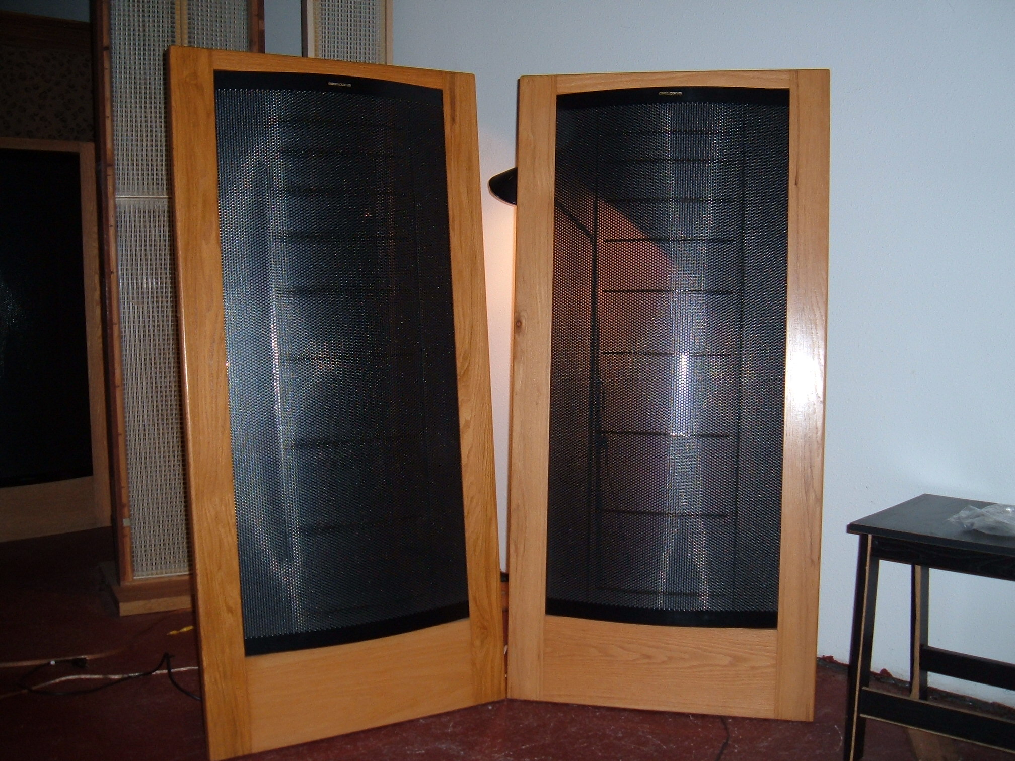

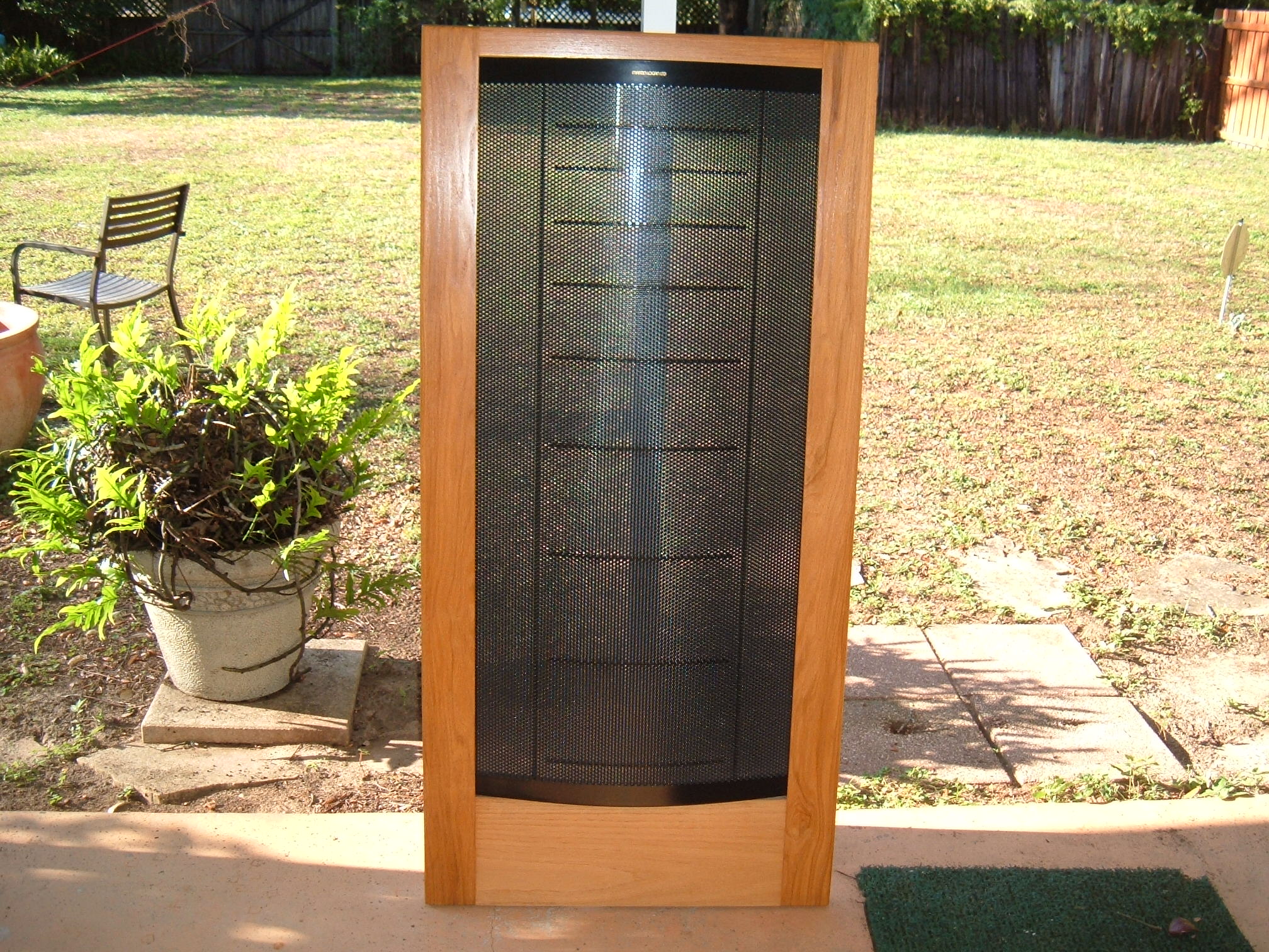

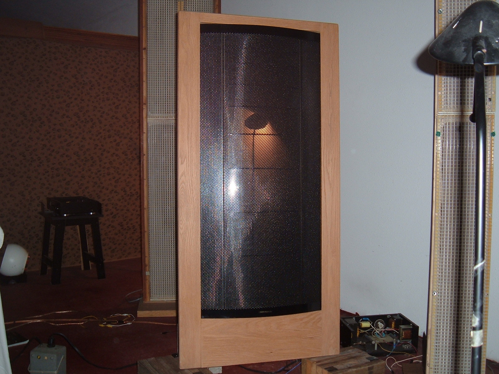

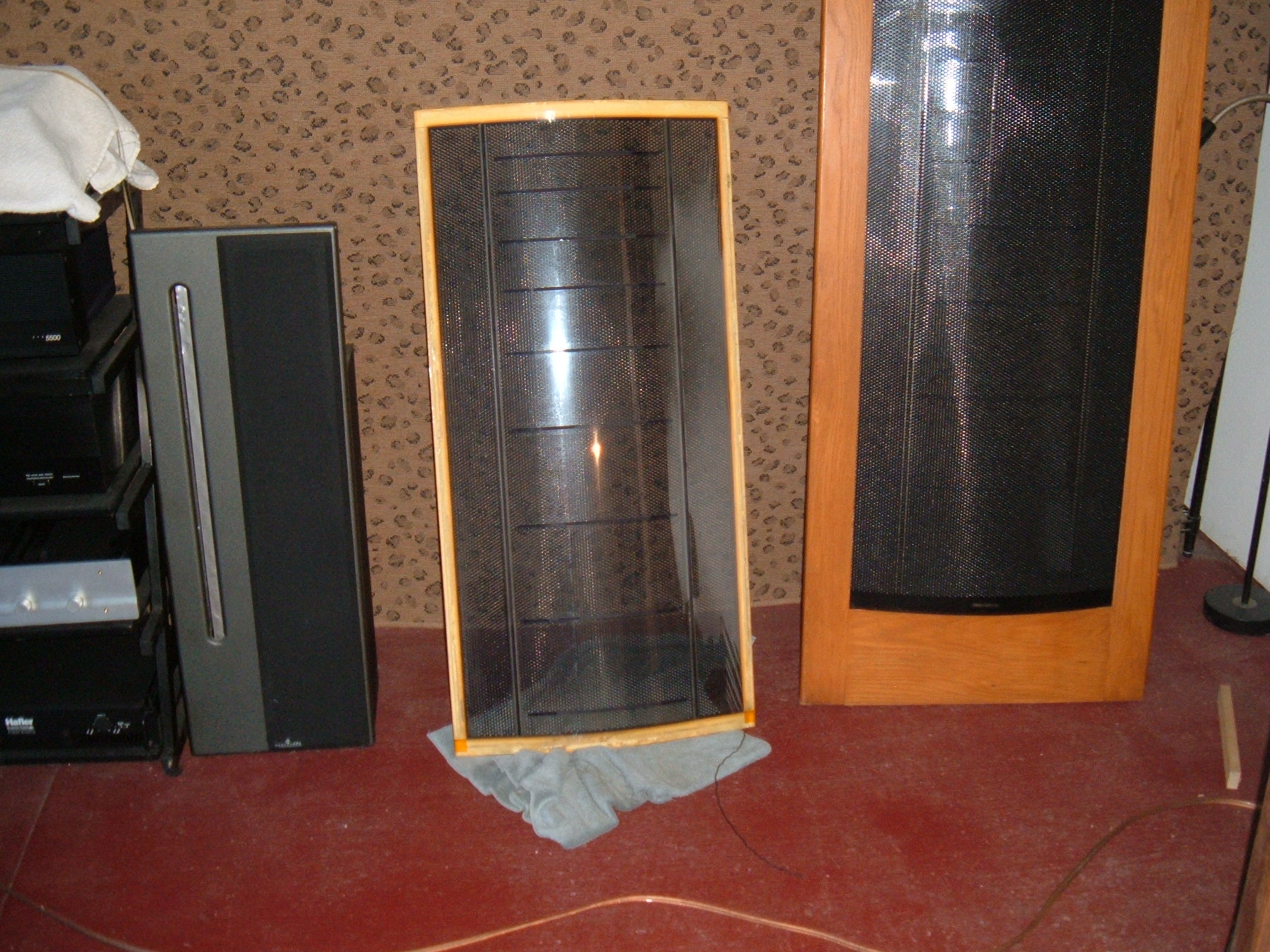

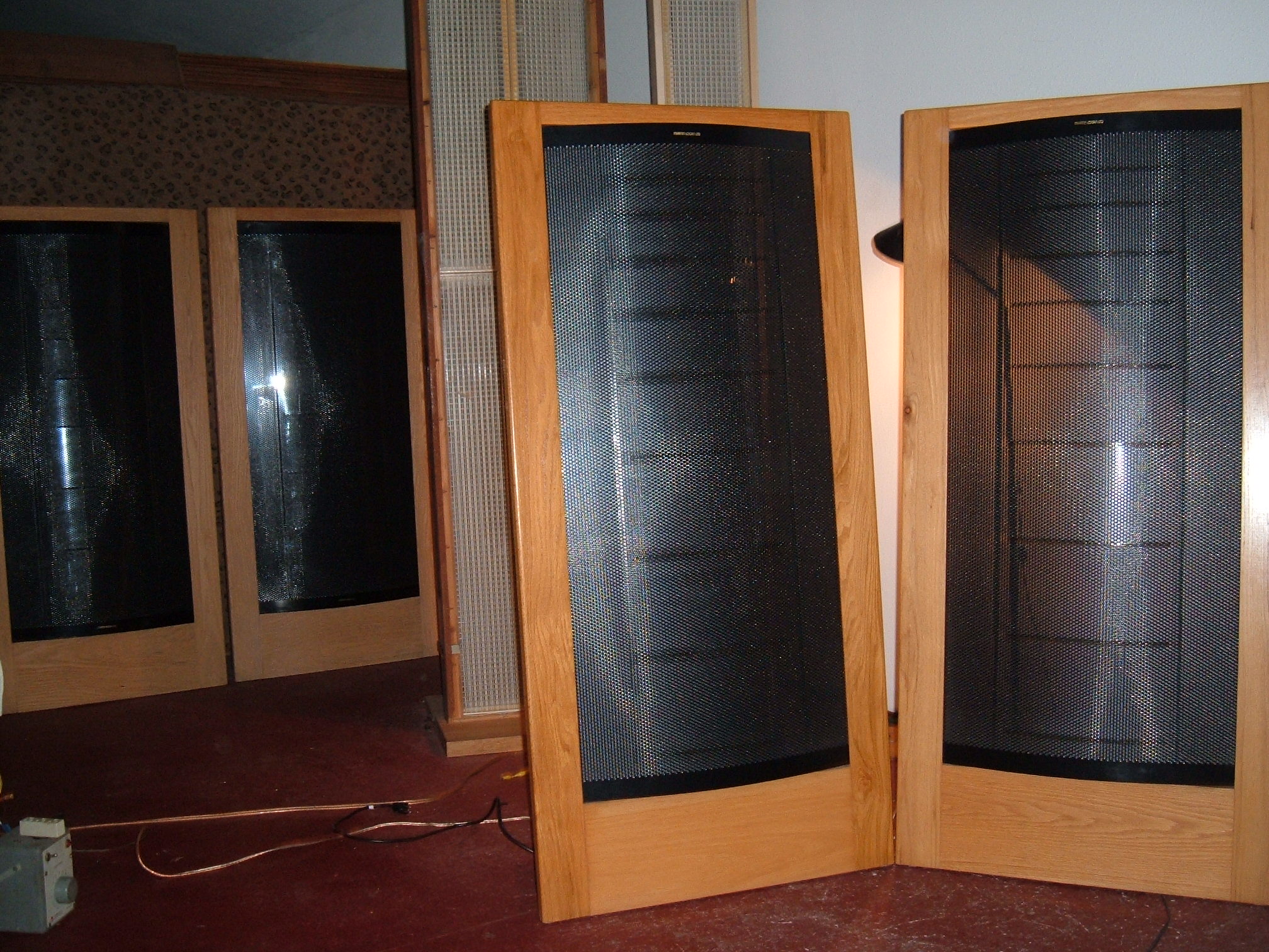

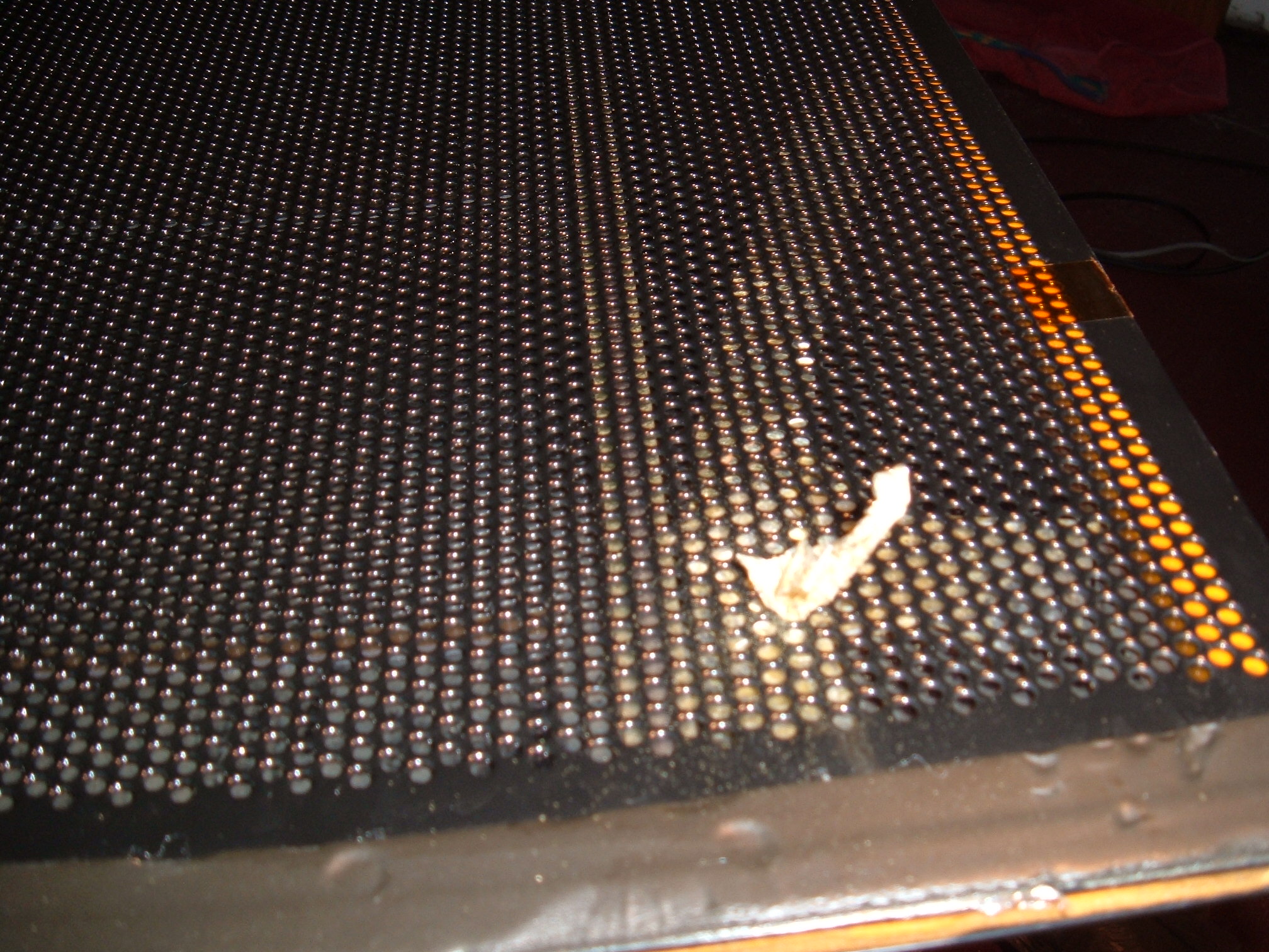

Here thay are....lot care with these....panels 22 years old...played one an one of my panle re-worket new bias feed...new coating....these play just as loud...An sound the same....sweet tone...lot fun

I washed the units by shower water, insert a copper wire into the gap, put some detergent solution to improve contact between copper and membrane, and so on. No good results were obtained.
It is not wise to re-mylar on ML CLS types. Yes, I agree with you, tyu. But it's a hobby! One piece of CLS 2a was disassembled and the aged dirty membrane was already removed from the stator. Now, DS tapes and residual adhesive are being removed.
I'm trying step by step slowly, since I'm in a very tight budget. I got some materials and tools from 100-yen-shop (something like one-dollar-shop) nearby. It is fun to think how to give equal tension vertically to the membrane, how to coat the surfaces, and so on.

One point....I had to start Solder ...wire to the bias feeder copper!...just laying it in dose not work right...As for your Mylar... well yes.... you well have to do the 2 panels the same....
