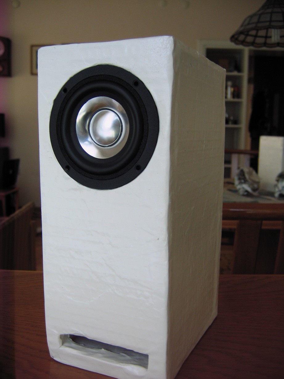

Thank you. They should really blend in nicely with the "client's" interiour. I used 470mH 8.2uF and 4.7ohm for the baffle correction. It still is no floorstanding loudspeaker but with (I might get in trouble for this) loudness on they sound really mature.
I only need to make some touch-up on the front with a new layer of paint or some loudspeaker covers...

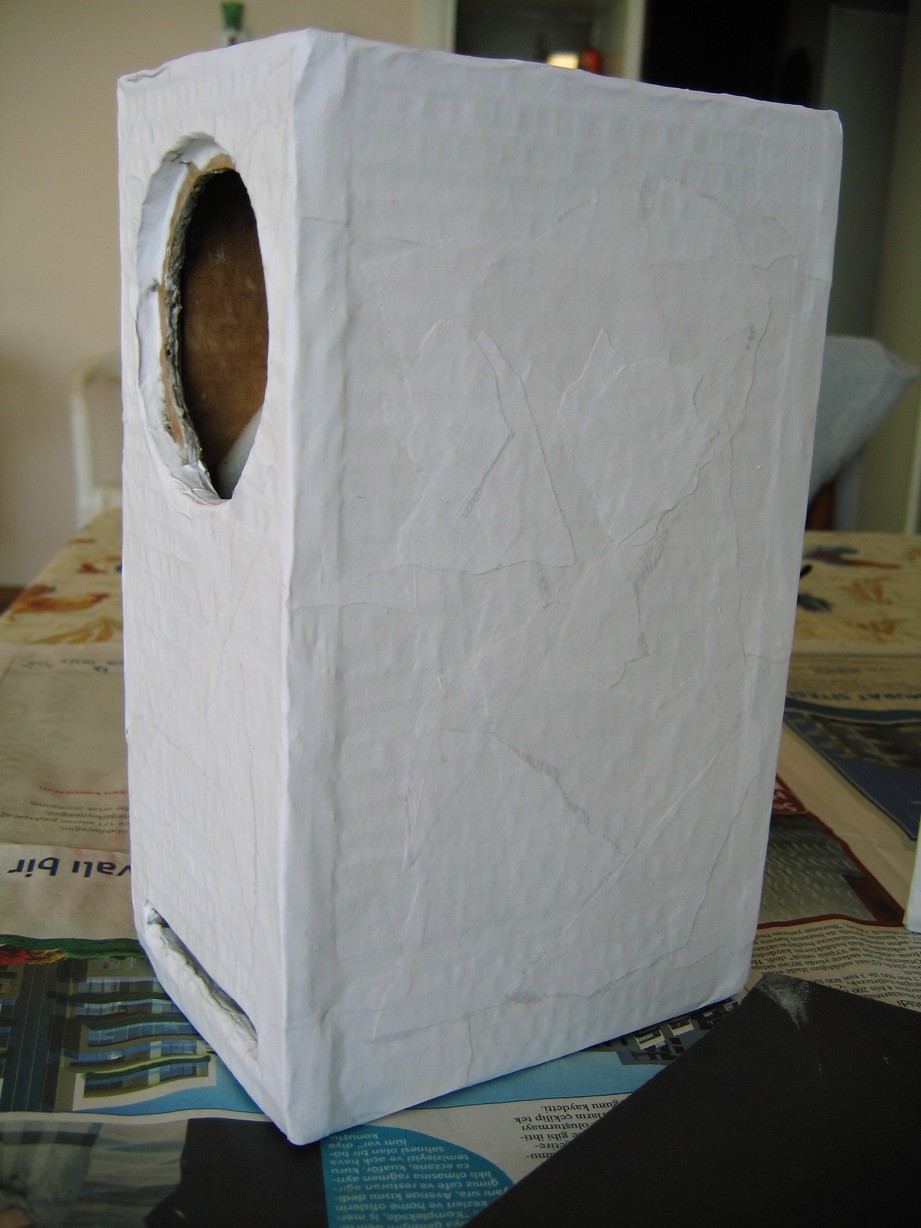

A couple more pictures. I paper mached the speakers
then painted them. The paper mache dries hard as a rock.
They look okay. If I were to do them over again I would
coat the inside with wood glue for added stiffness. I would
do the same on the outside and then maybe cover it with
some kind of fabric. The gentleman who designed the Tabaq
speaker did a really nice job of covering his speakers and I
would love to copy what he did.
Well, I would say using cardboard is worthwhile if your unable
to work with wood. The only thing I had to buy for this project
was some glue and a can of spray paint. So if you're on a tight
budget this could be a good option.
