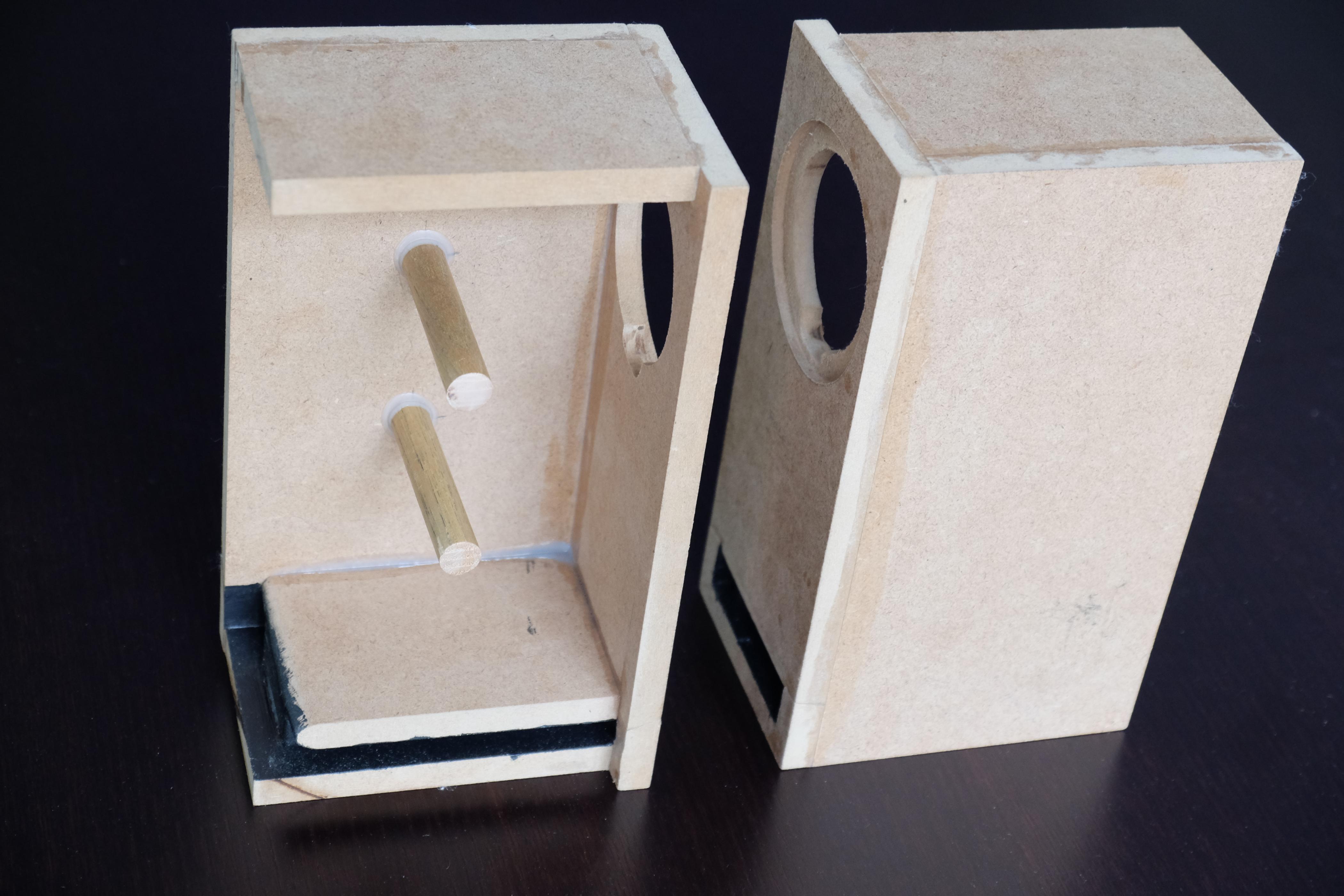

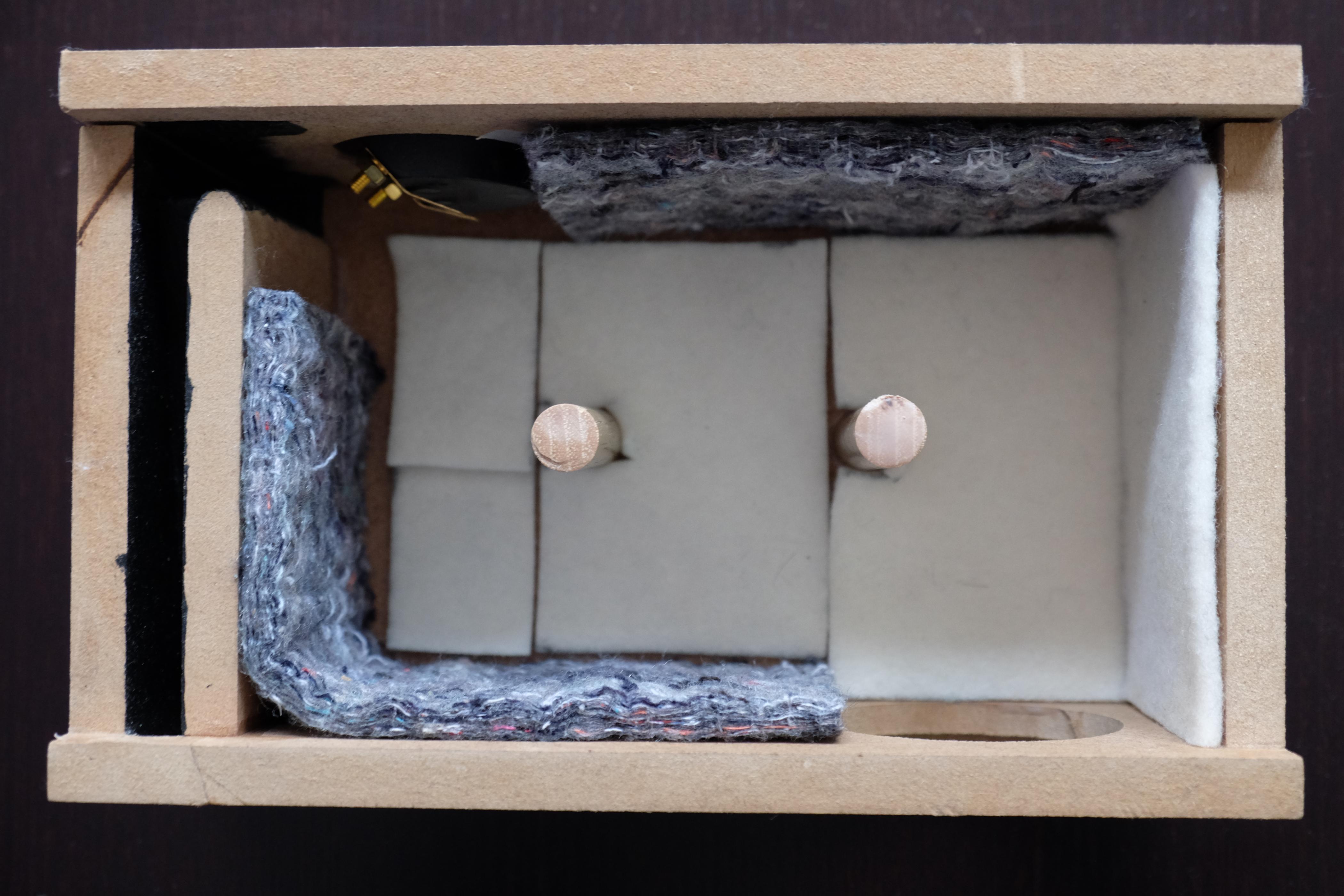

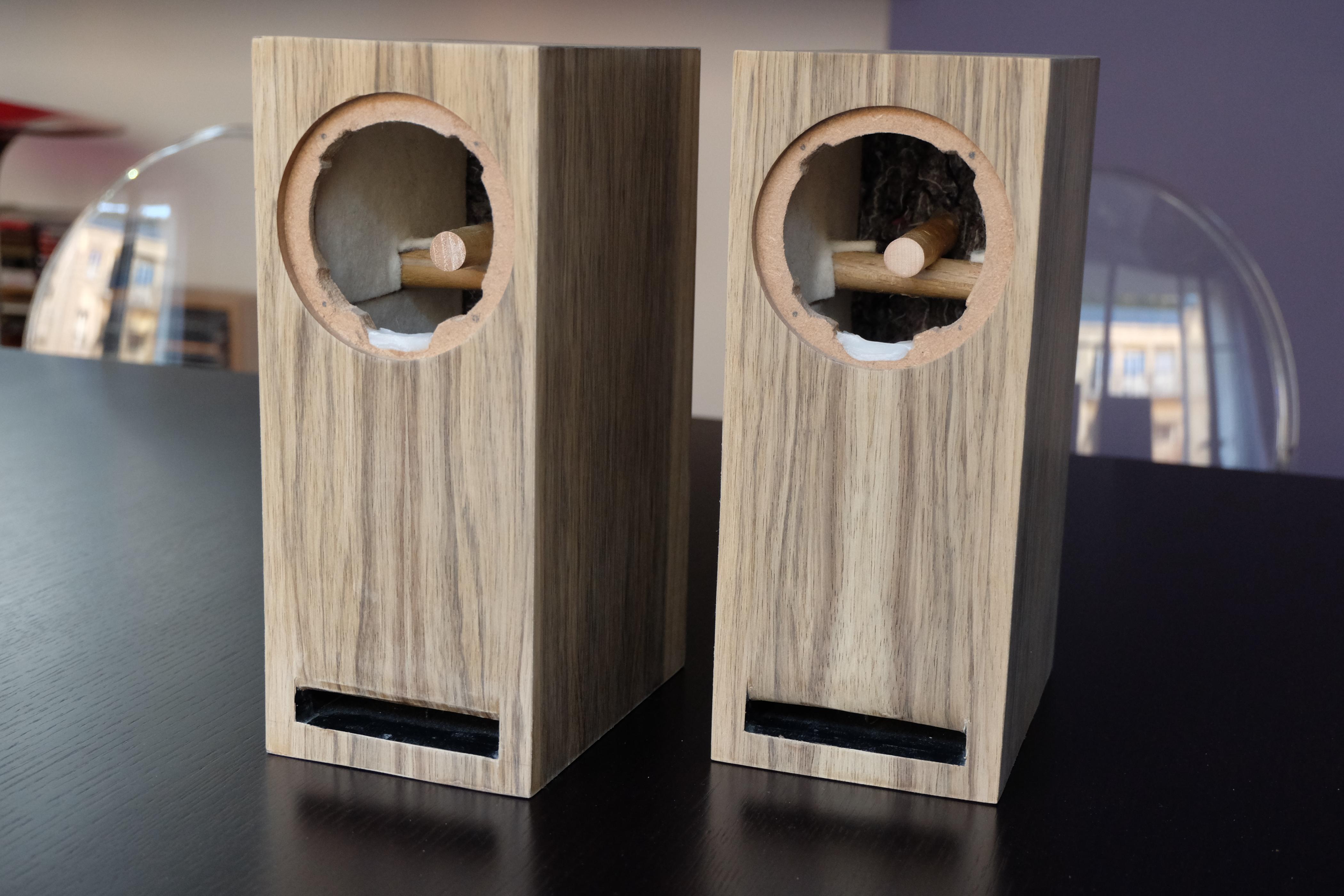

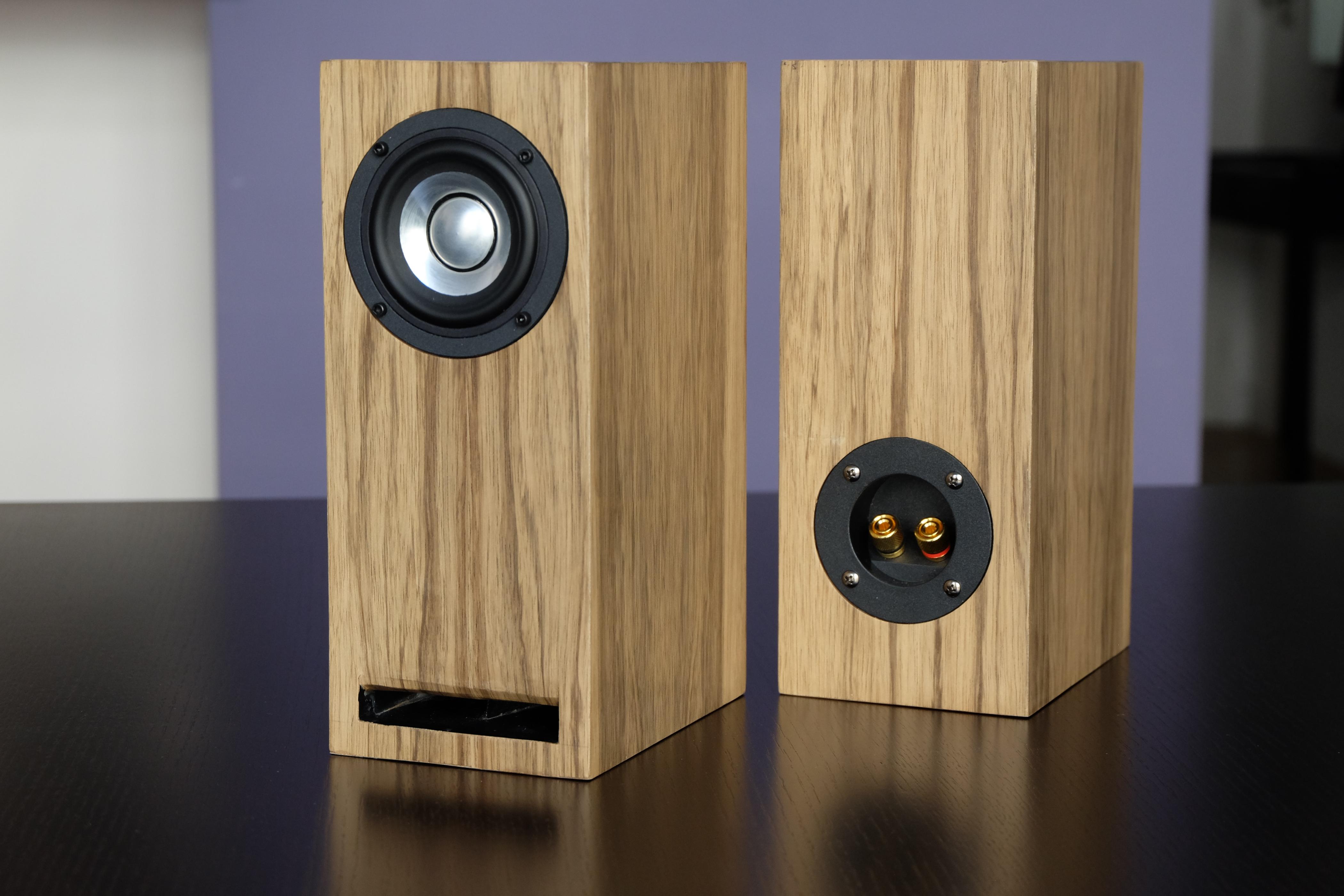

Hi everybody,
I finally built mine.
They are made with MDF.
Internal braces are... sections of used drum sticks! Drum sticks are typically made with hickory, a very hard and dense wood. A small speaker is a perfect way to recycle them.
Internal panels are lined with both wool felt (top, left and right sides) and recycled cotton felt (back and front side).
The finish is some Black Limba veneer (aka Fraké for french readers, aka Terminalia superba) that was sanded+varnished several times. Black limba was chosen to have a scandinavian look.
I love my Martello speakers, the little guys sound great !
I'm now planning to design and build an associated subwoofer.

Wow! - a very clean build. I like the use of round dowel for bracing - drum sticks !
I've never heard of Black Limba before, it's really very nice.
Thank you Bigun !
It's not that clean actually, it was the first time I used veneer but I'm quite happy with the result.

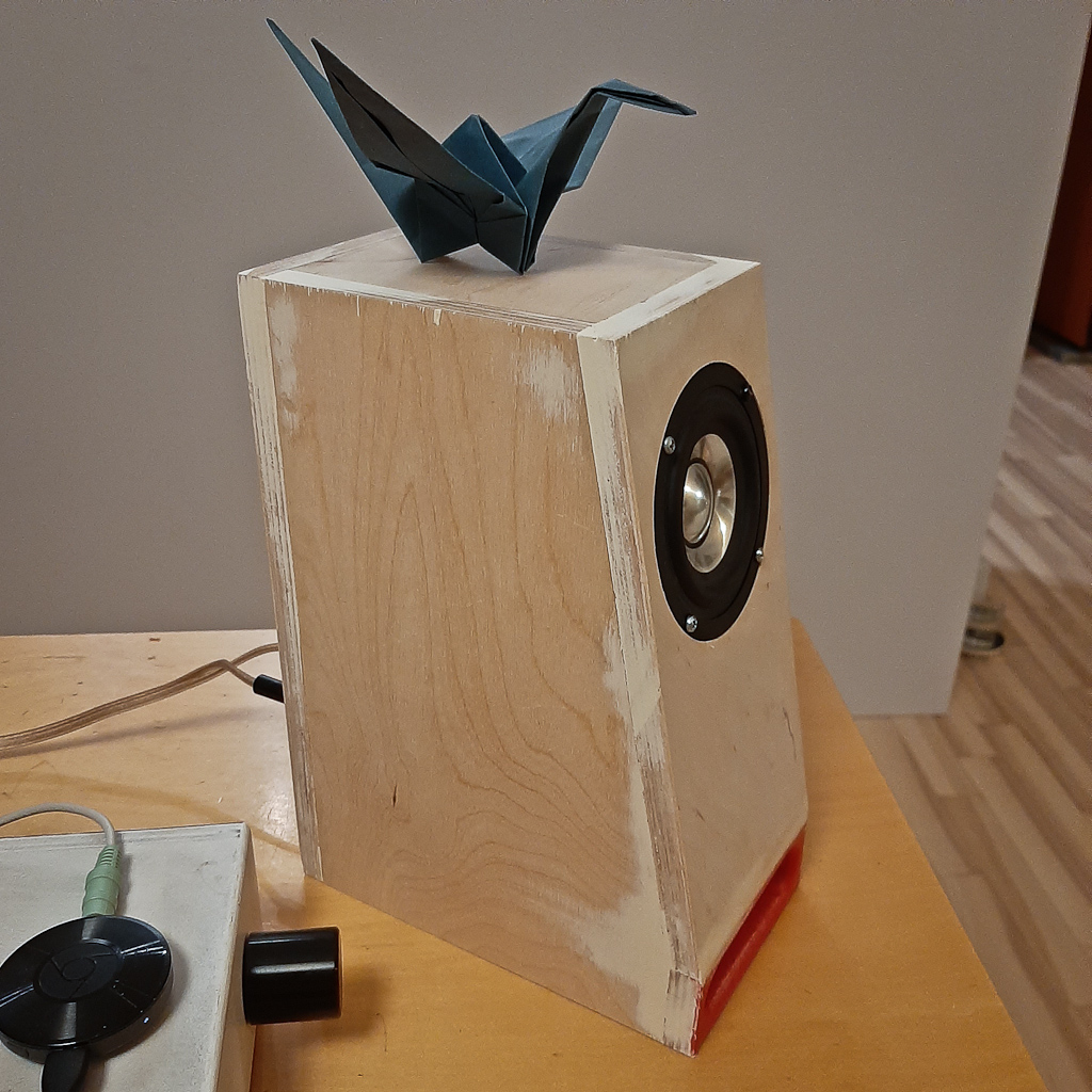

Just wanted to put out a quick update and a few piccies of a new Martello alive today. I wanted some small desktop/workspace speakers and these seemed to fit the bill perfectly. I'm still waiting for the intended amp to be freed up for this purpose so for now im listening to them in my living room and letting them burn in a little. They handle the room very well indeed, i am listening to "The Folk Singer" as i write this, and it is rendered perfectly and with nice dynamics. They are not bass monsters, but they manage more than i'd expect for such a small speaker not right agains the wall.
I decided to stick to the visible plywood look i'd used for my pensils and alpair bookshelf speakers. I like the look of plywood edges and i think it frames the driver nicely. I had to assemble the speakers a little differently to accomplish this but nothing major. Driver holes were routed last after all the cabinet had been assembled. Lined insides with 10 mm felt and installed a notch of 0.33mH/8.2uF/4.7R.
SWMBO commented they look like mini pensils :) Last shot is the little guys on top of their big brothers :)

Some time spent listening later and i have to say these little drivers really do well, very balanced and detailed sound overall. They started out a bit boxy sounding but that disappeared pretty quickly. I've only listened in my living room with them on top of the Pensils. They don't go as deep to no surprise, but they are not shy, and in a small room and closer to a wall i don't think they will be slouches. Nice!

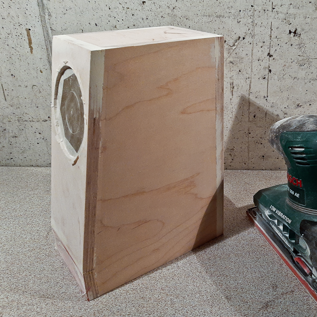

I am pretty much done already. We are all staying home due to the virus and having much more time than usually :-/

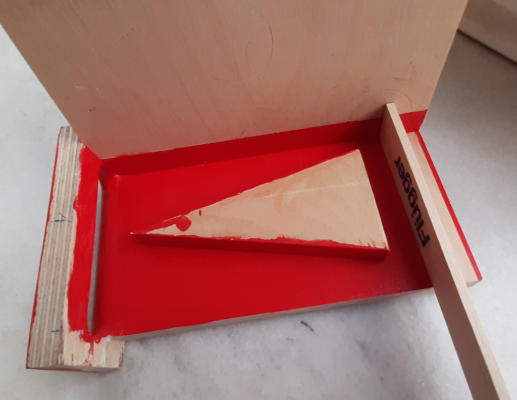

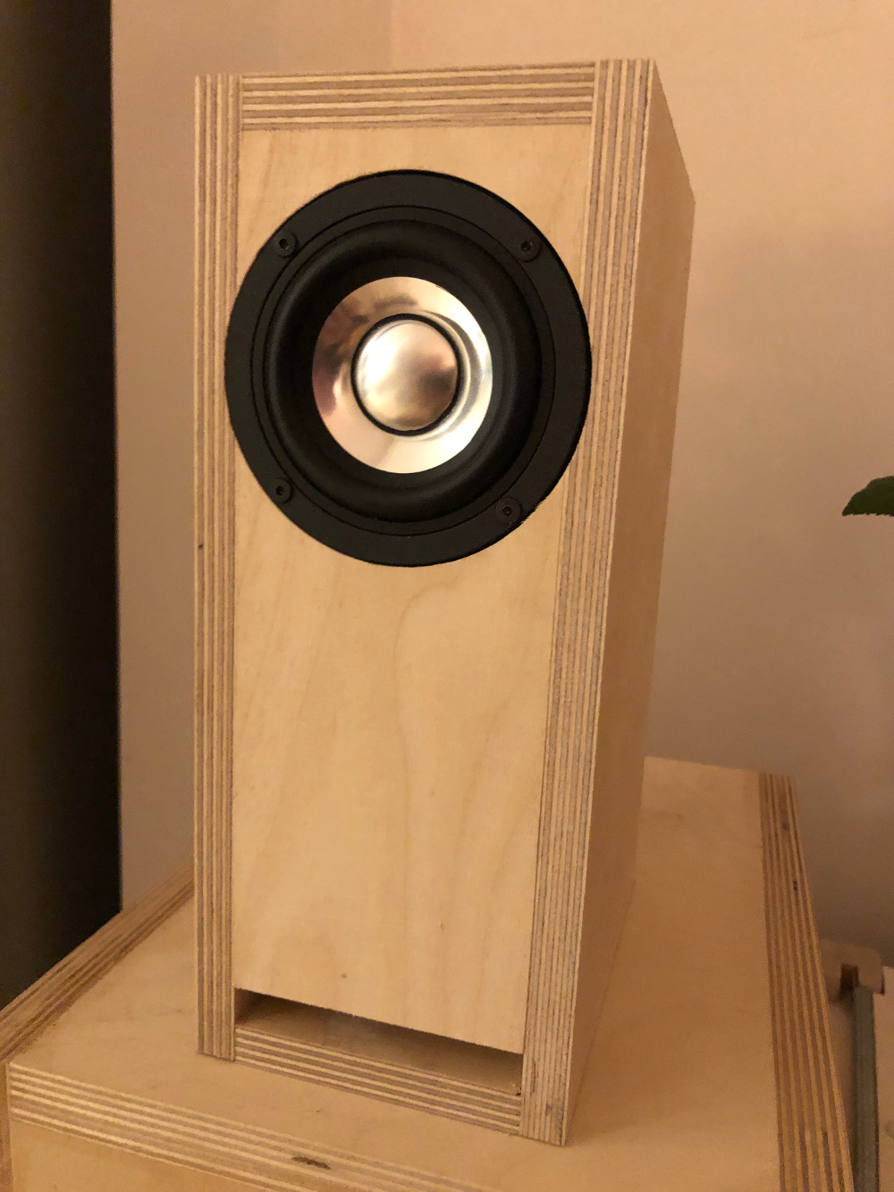

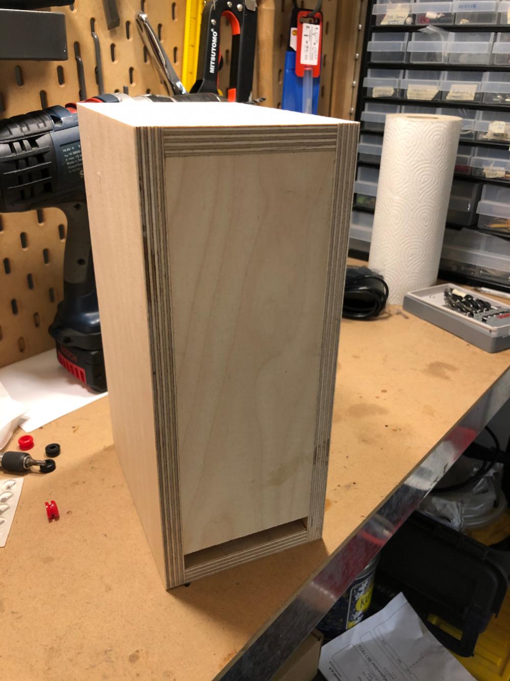

My speakers have a bit different cabinet, the front is leaning by 11 degrees, the height is a bit smaller and they are some 2 cm deeper. Width and internal volume stayed the same, I have also kept the original design of the bass reflex port. I like the idea of the triangle divider :)

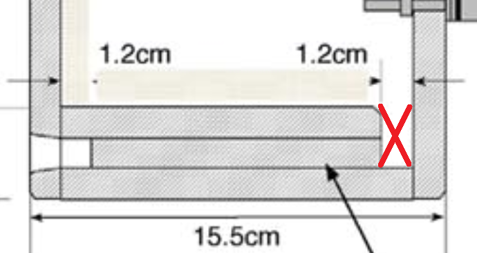

And that causes the question regarding the tunnel length. Please see the part of the original scheme below: is the place marked with the red “X” a part of the bass-reflex tunnel?
I guess not, but I would like to hear an opinion. If it is, I should put a small brace behind the port, right where the piece of wood with “Flugger” name is placed on the last photo. Should I?

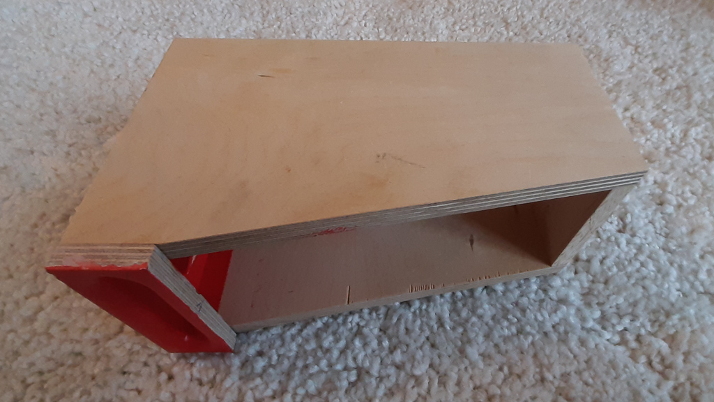

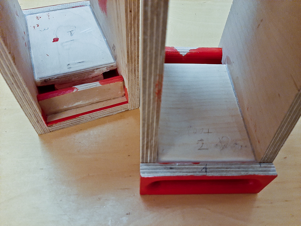

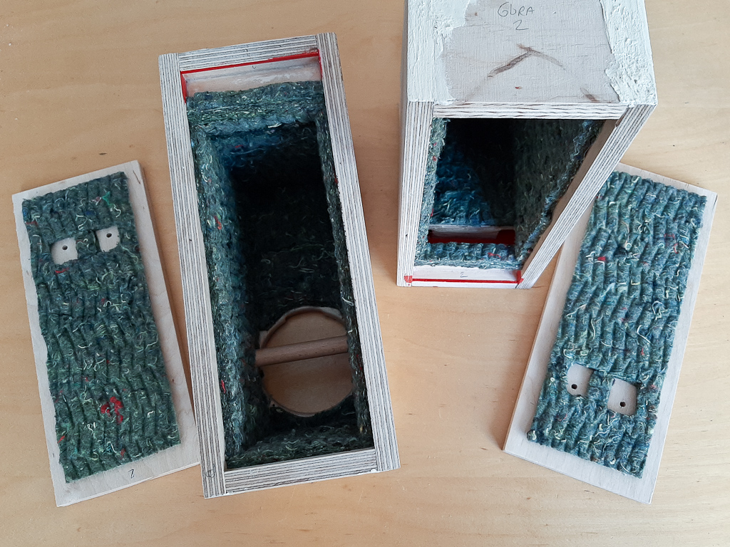

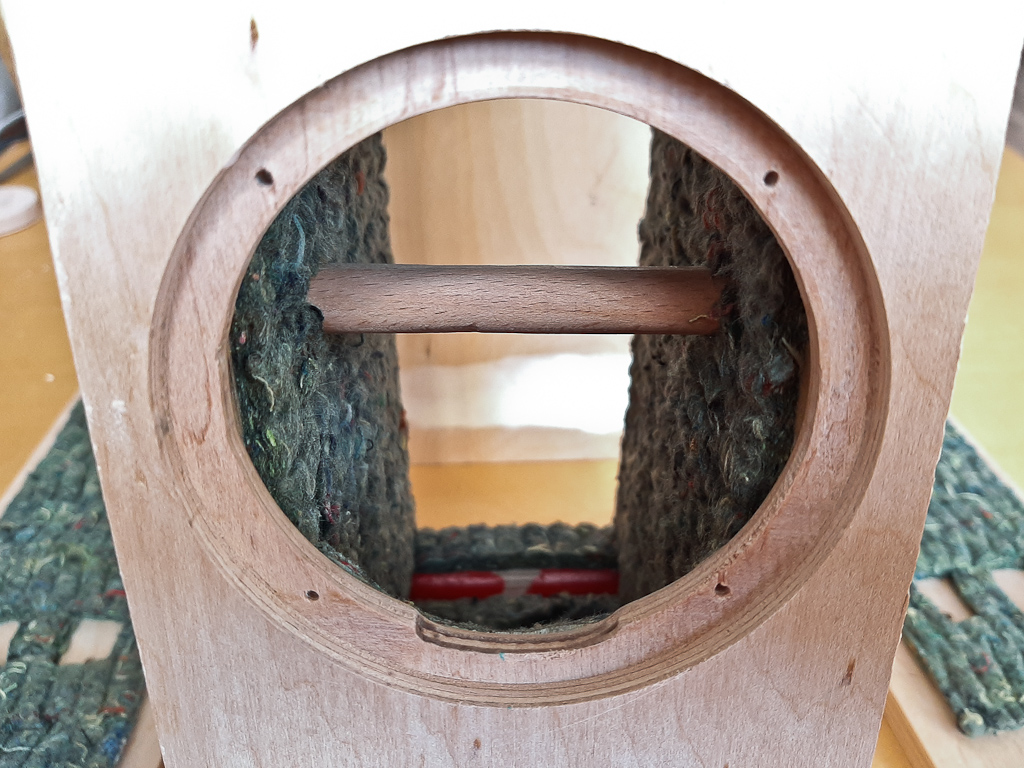

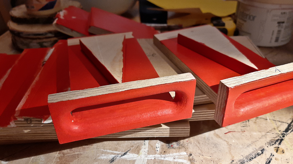

The boxes are ready. Well, except that edges are not rounded yet and the paint is not applied, but I could not wait to test them ;)
As soon as I glued it all together, applied the filler and sanded it, I have installed the speakers and started to burn them in.
And I must admit that I am astounded. I would never expect that big sound from such little boxes. The midrange is very clear, with vocals a bit retracted, and the bottom is surprisingly well presented and controlled. Soundstage effects are exceptional, thanks to the small front and a single driver design.
The speakers sound great with just what I had laying around, a cheap Tripath amp fed from the analog output of Chromecast Audio. Never thought that budget audio may give so good result :D
