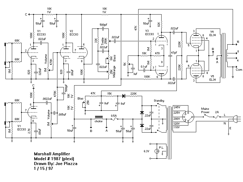

I'm building a marshall head from scratch. Now, I've got all the soldering pretty much done but when I came to finish the grounding bus I got confused. I emailed with the amp guru from London Power Press (tube amp guy in Canada) and got more confused!
So I just need to get all these grounds connected. This is my first amp and I don't want to fry everything or kill myself because I grounded it wrong.
The basic circuit is a 50 watt Marshall plexi. I believe it's the 1985 model (built 1968 go figure).

Go to www.aikenamps.com and click on Tech Info, then Advanced, then Star Grounding.
It's a good idea to use isolated input jacks and connect the "ground" of the input jack through a resistor 1-10ohms to the star point. This will tend to allow a place for ground currents to go and help reduce hum.
Sometimes it make sense to create a "signal ground". This ground esentially does not carry current. Connect all signal grounds together.
Then create a "power ground" and connect all grounds that return current.
Chassis ground should be a "protective ground" and connected to earth. There shouldn't be a bunch of connections to the chassis.
You can then connect power and signal together with or with or without a resistor. Protective ground is always connected to chassis.
A "Star" is the best topology, but chassis ground should be separated.

I'm not sure what I ground the preamp star to. Do I solder a wire from the preamp ground to the power star? Second thing, what do I ground the power transformer to? From what I've ready I ground the PT centertap, output tubes, and the two power filter caps to the first "power star". What do I ground that star to?
So this would be the ground flow:
preamp grounds, preamp filter cap -> preamp star
power grounds (pt center tap, power filter caps, output tubes) -> power star
preamp star -> power star
power star -> chassis
Make sense? Thanks for taking the time to read all this jargon!

You have the general idea. Let's use this concept.
1) Dirty grounds or (high current ground)
2) the 0 volt reference / clean grounds
3) Protective grounds, earth
So, in your case the preamp power supply is dirty, so it belongs in the power star. Your connection to from power star to earth may or may not be required.
Now, I'll throw in a curve, but no one seems to design this way.
1a) The dirty ground (1) goes to neutral of the power line.
2a) The 0 volt reference goes connectes to 1 and 3
at the load center of the house
3a) The outer case goes to (3). (3) is always connected to Neutral at the load center of the house (assuming no sub-panels).
So, what you have in the ideal case is that (1), (2) and (3) are connected to EARTH at the load center of the house which is the 0 volt reference of the entire house and faults don't disturb the reference.
(3) carries current only in a fault condition.

If it's power to the preamp then No. Attach to dirty ground.
