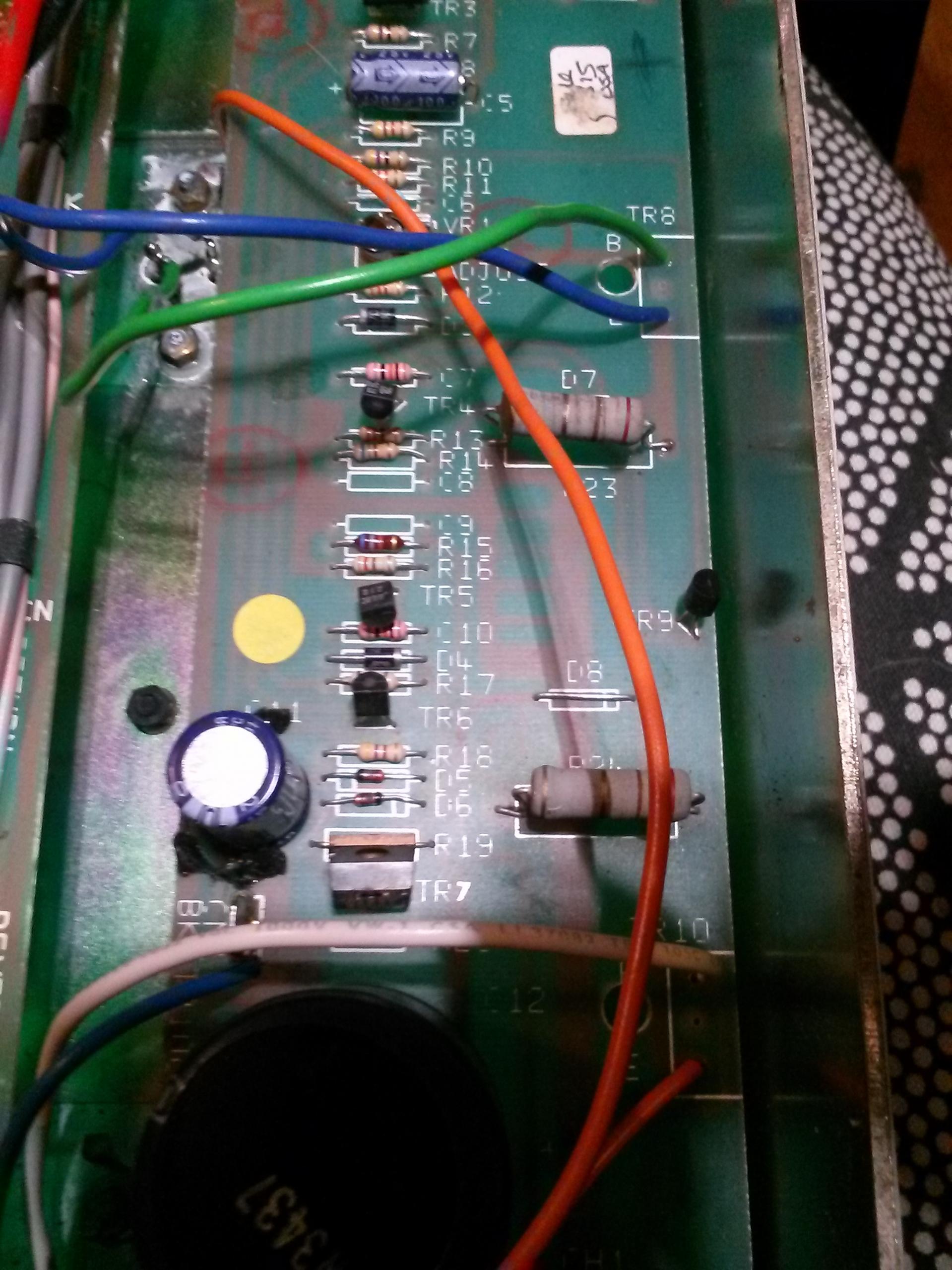

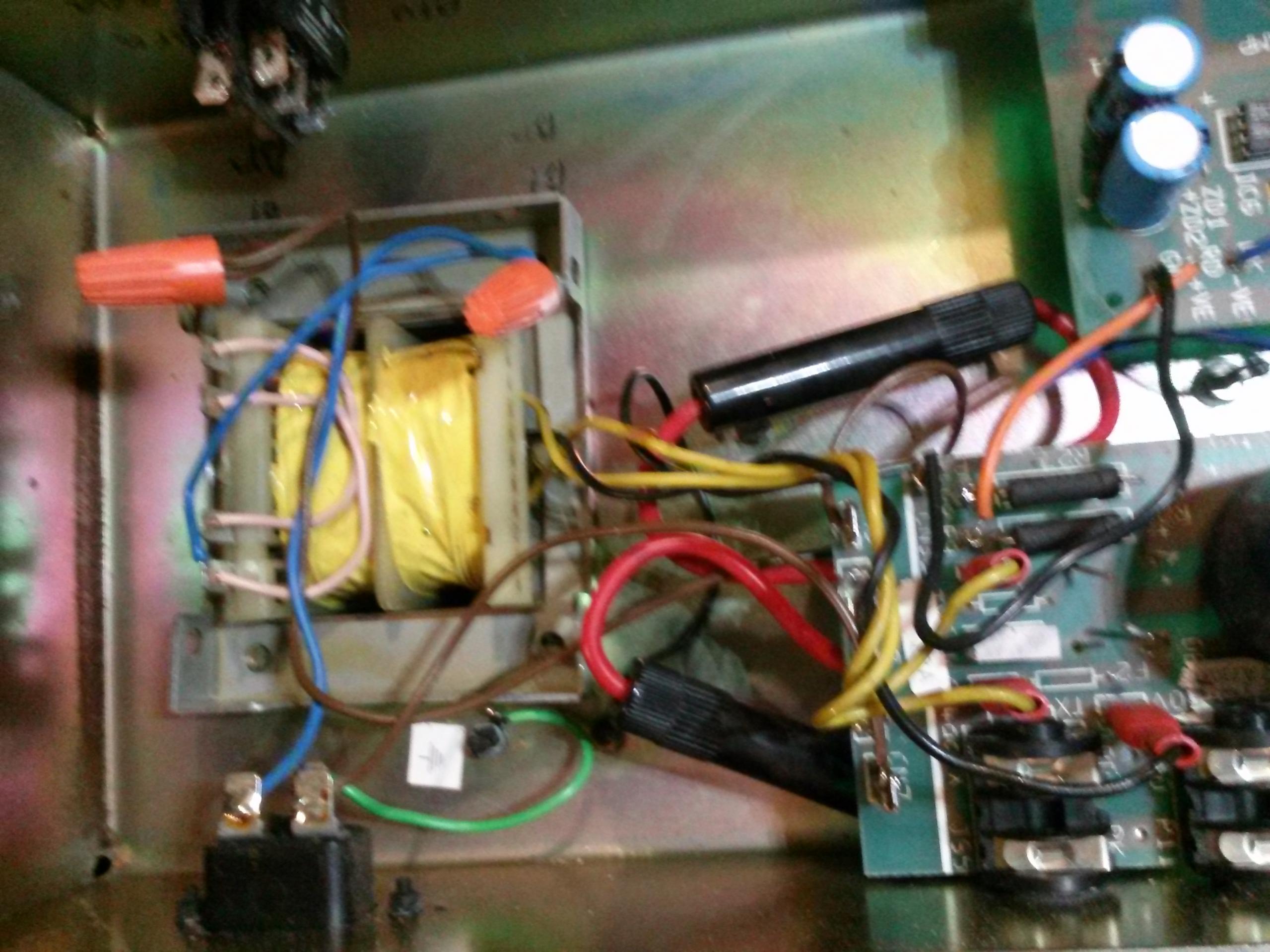

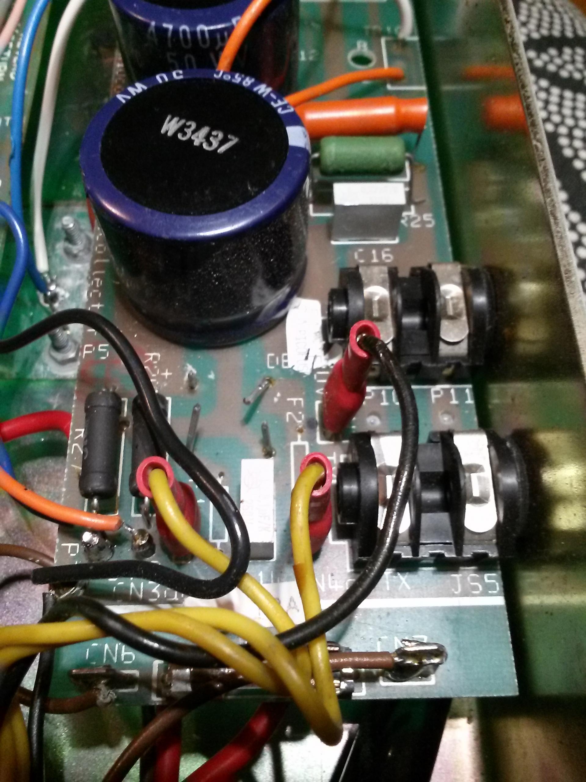

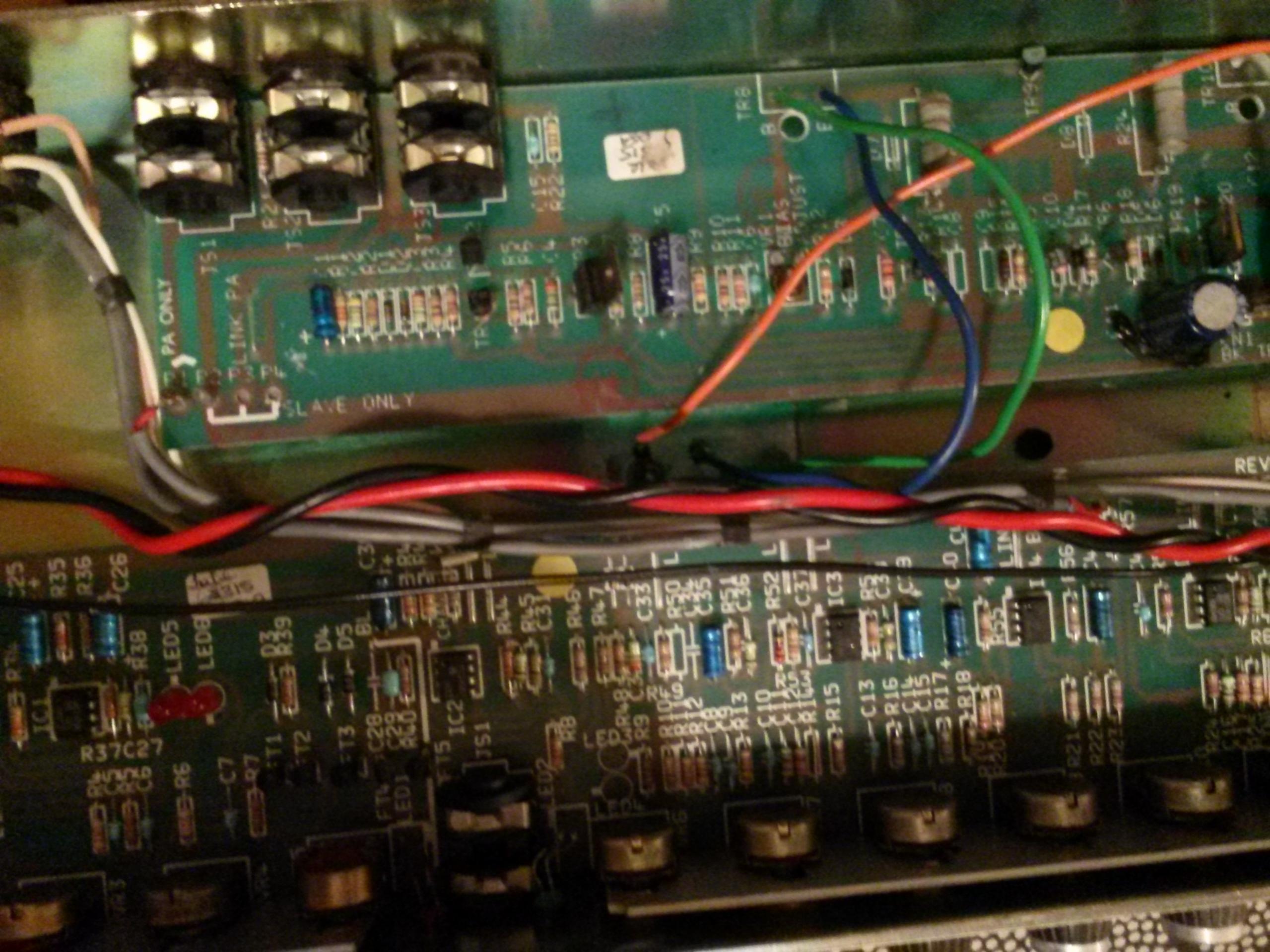

Hi everyone, I'm a green member here (just signed up yesterday) and I've already read some great info. Maybe you all could help me out with a little problem I'm having. I have recently acquired a Marshall model 3315. 150 watt solid state head, which I have no experience with as all my previous Marshall's were tube amp's, mostly JMP late 70's. Anyway I bought this thing for a mere $5.00 at a scrap metal yard off someone that was giving it to them for 1.5 cents a lb. Yep for less than .75 cents. It looks pretty good inside and out except it is missing the red light up power switch, at least I'm assuming that's the type switch. Looks like that one would fit the hole. I bypassed and hooked the wires directly to each other,blue to blue. brown to brown, no power. Fuse is fine. Both inline fuses are good also. Was I wrong to assume the wires went that way? And if you look closely at the hole shot, you may notice 2 conflicting wiring footnotes someone wrote on the inside of the amp chassis and looks like below the transformer it says Bl Brn on the left and bl brn on the right. then near the hole it says blu blu on the left and brn brn on the right, I'm confused. Now inside upon further investigation, it looks like something is missing near where the speaker outputs are and next to a large capacitor (w3437) is there are 4 wires kinda going up from the board to nowhere. See jpeg Picture. There was also a little card on the inside when I opened it up with some wiring memo, can you tell me what it means? Can anyone tell me what is missing, if anything. Thanks for your help in advance...

The on/off switch is a Double Pole model.
A very common switch.

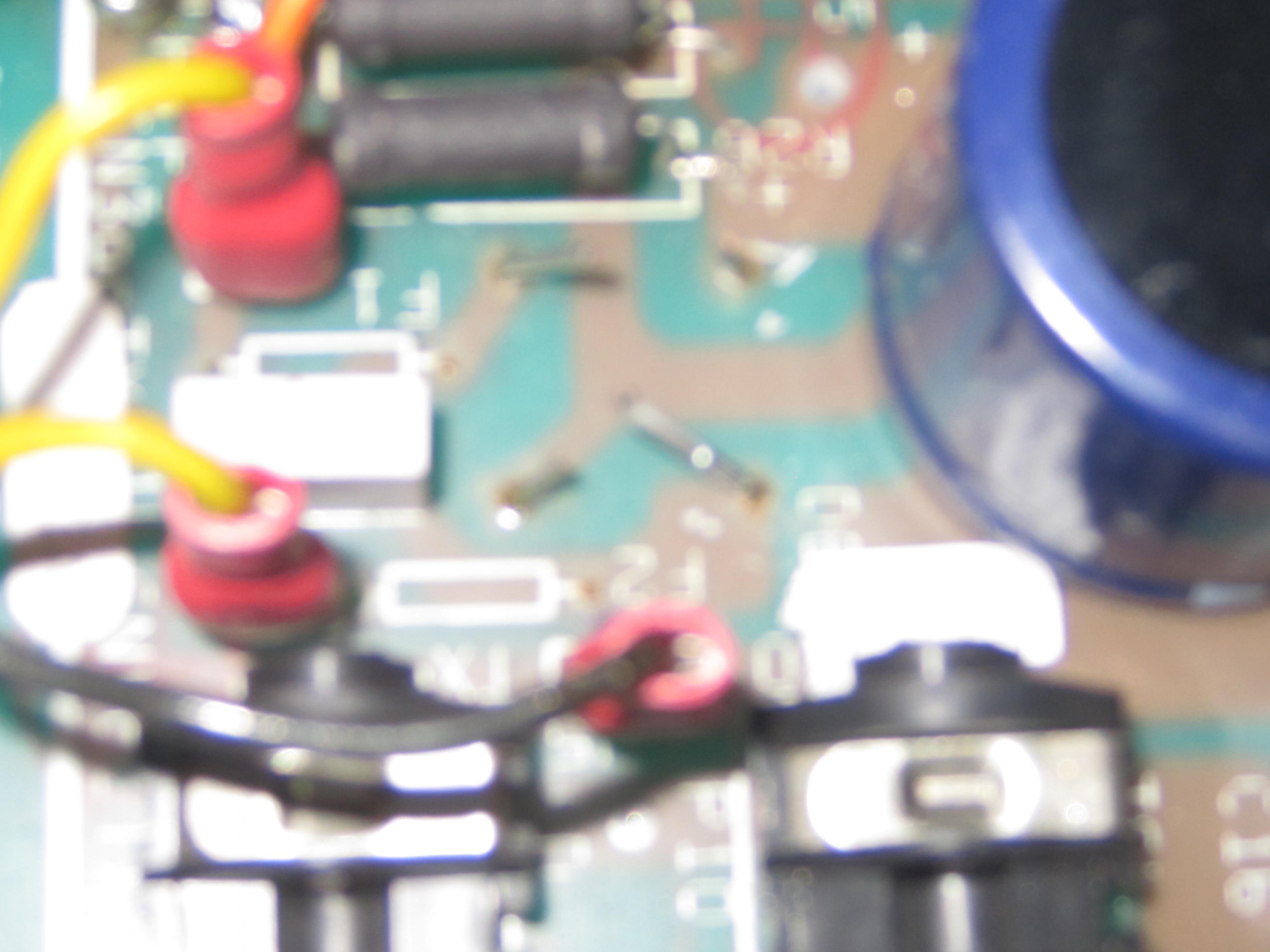

In picture 1, two fuses are missing (F1 and F2, both 10A).
The short pins that are visible are from a removed bridge rectifier.
I suspect a problem with the power amp that took out the bridge rectifier and the fuses.
But that's just a guess.
After replacing these missing parts, do not zwitch on the amp without a Bulb in series with the amp (in the AC line)
If the lamp is on for a brief moment you can take measurements.
But let's see if all is wel with these new parts.
Then come back for more help.
Good luck and be carefull.

Thanks Tarzan, and no, I don't know how to read a schematic, maybe I can learn on You Tube or Google seems to know just about everything. The 2 fuses you are referring to aren't the in-line fuses(fuse-able links)that are the red wires with the black housings just to the left of the board that is situated one on the top left and one on the bottom left of the picture. Is this thing worth fixing? I do have the schematics for both Power and Pre stages and the reverb.

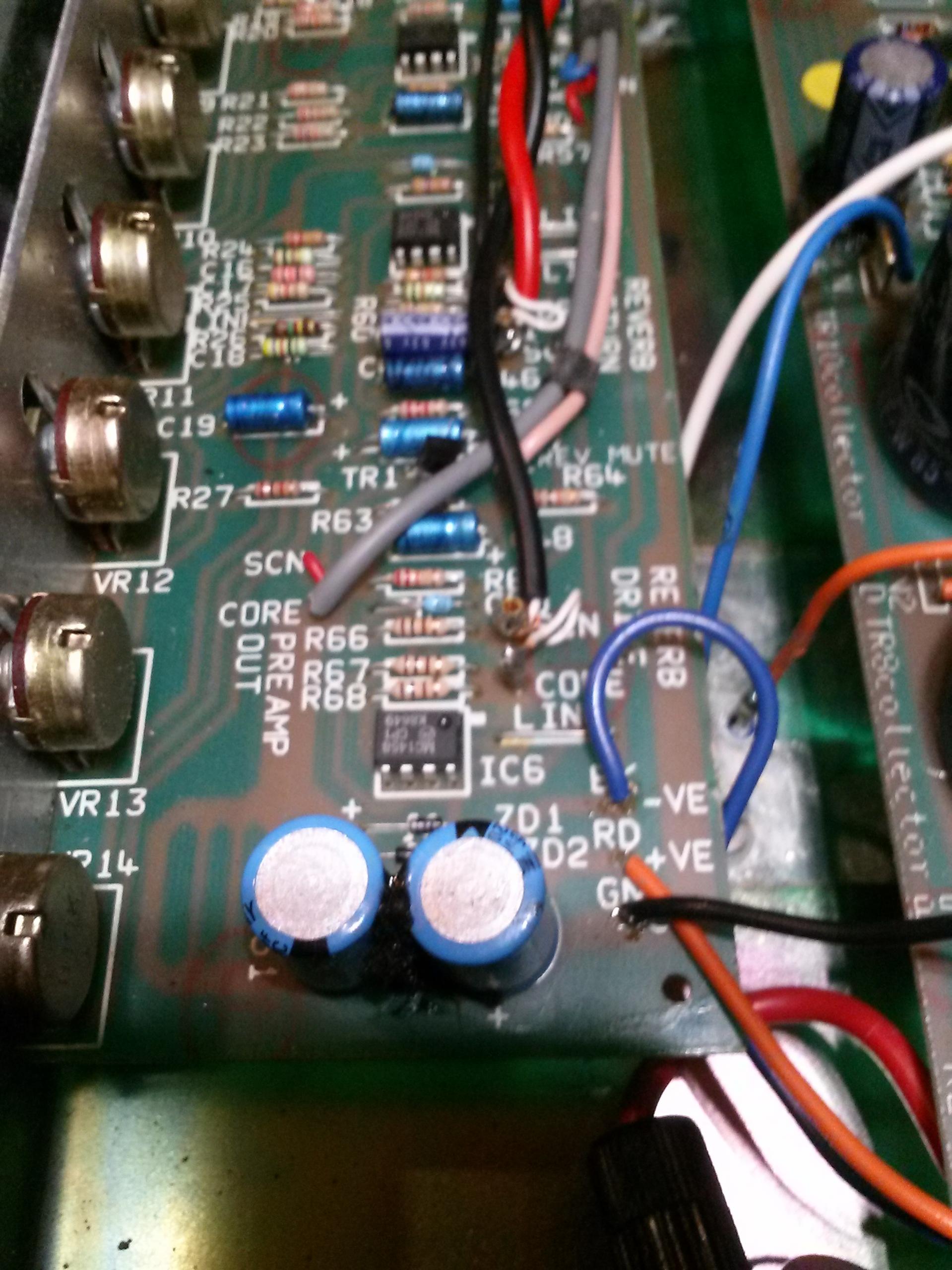

Enzo, The thing is, I can't find anything that relates to the 6 wires in the diagram. Any hint where I might find those?

1. Enzo said that the two papers refer to the power transistors (darlingtons).
I see one, but is there a second? Are these still ok?
2. Are the potentiometers there?
3. Are the jack sockets for in and output?
4. Then do you see a reverb can in the amp?
That's a box with springs and 2 rca sockets if not wired direct.
5. Is there a transformer on the chassis?
If all these items are there, then a repair can be done for a fair amount.

In the first photo is the large capacitor with W3437 printed on it. Immediately above it I see the white, blue, and orange wires soldered to two pins sticking up through the chassis between two screws. If you flip the chassis over, I bet you will see a power transistor. Anchored by the two screws at each end, the pins stick down under the chassis. Similarly, the other three wires probably connect to a similar grouping.
So your output transistors are probably still there, whether they are shorted or not is a separate issue.

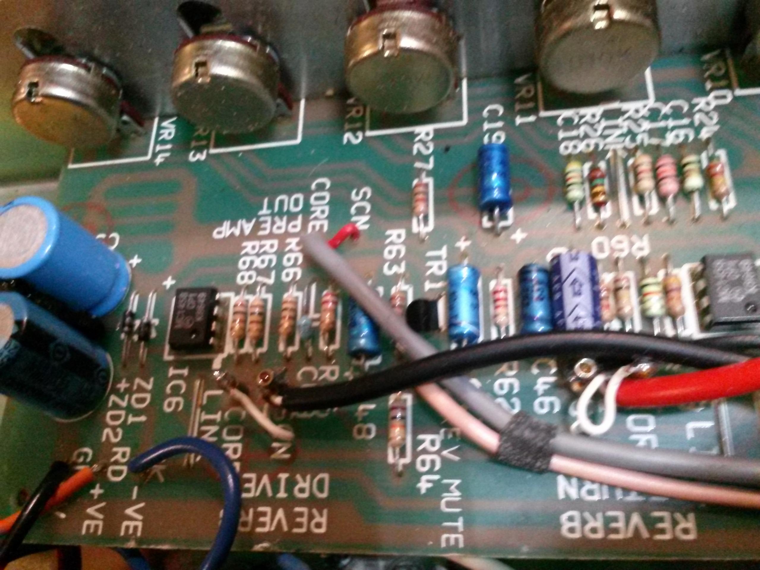

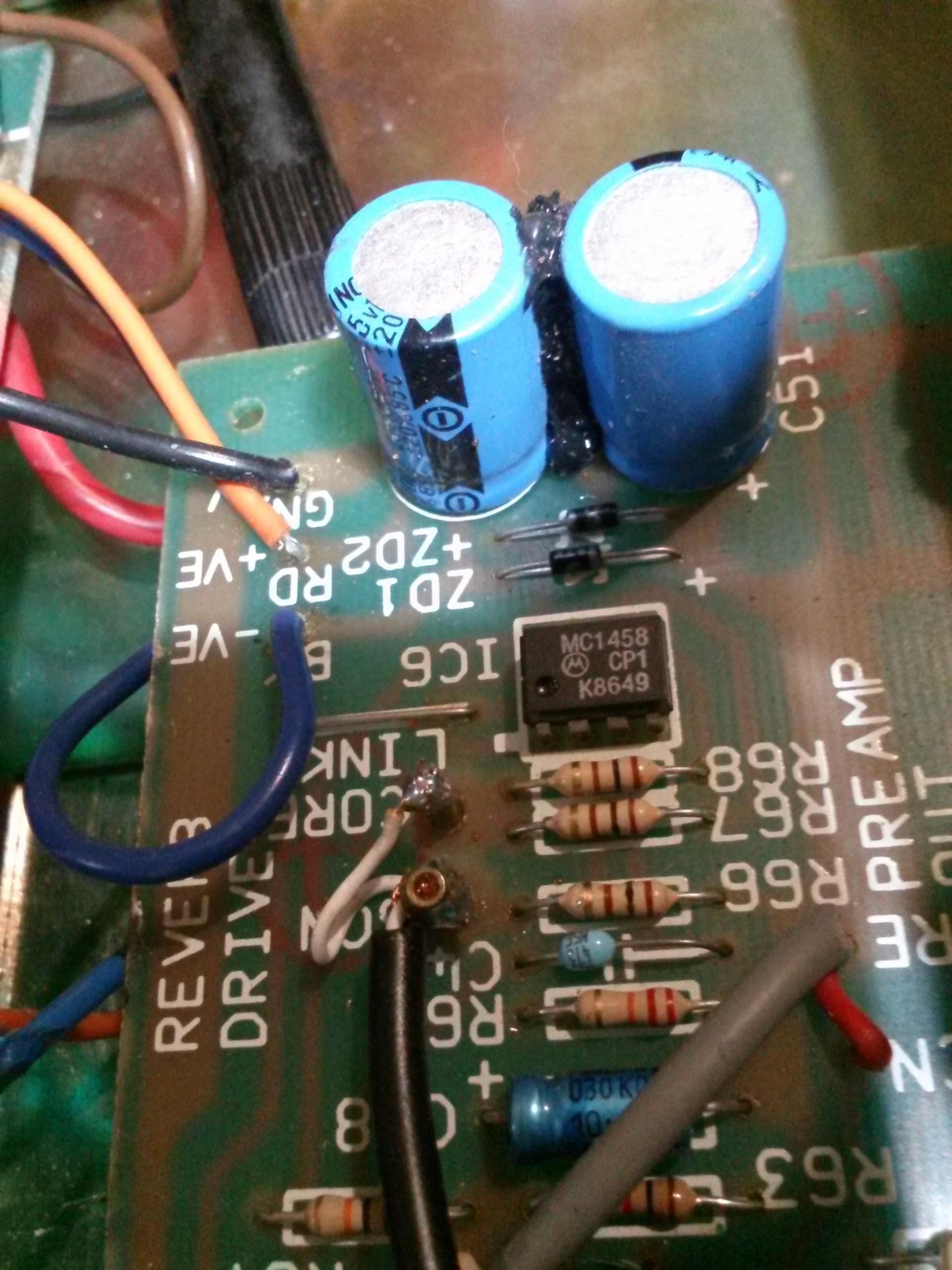

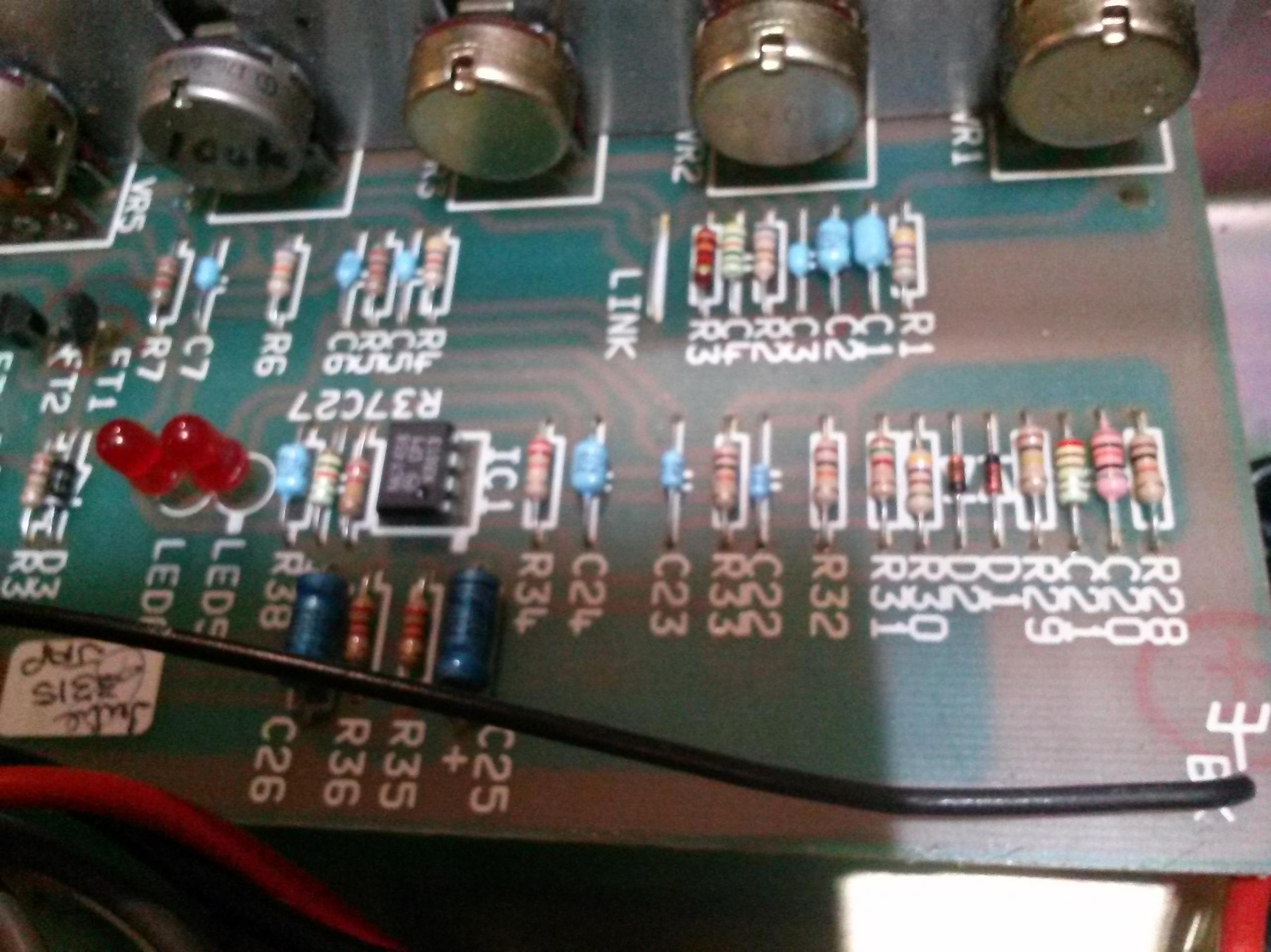

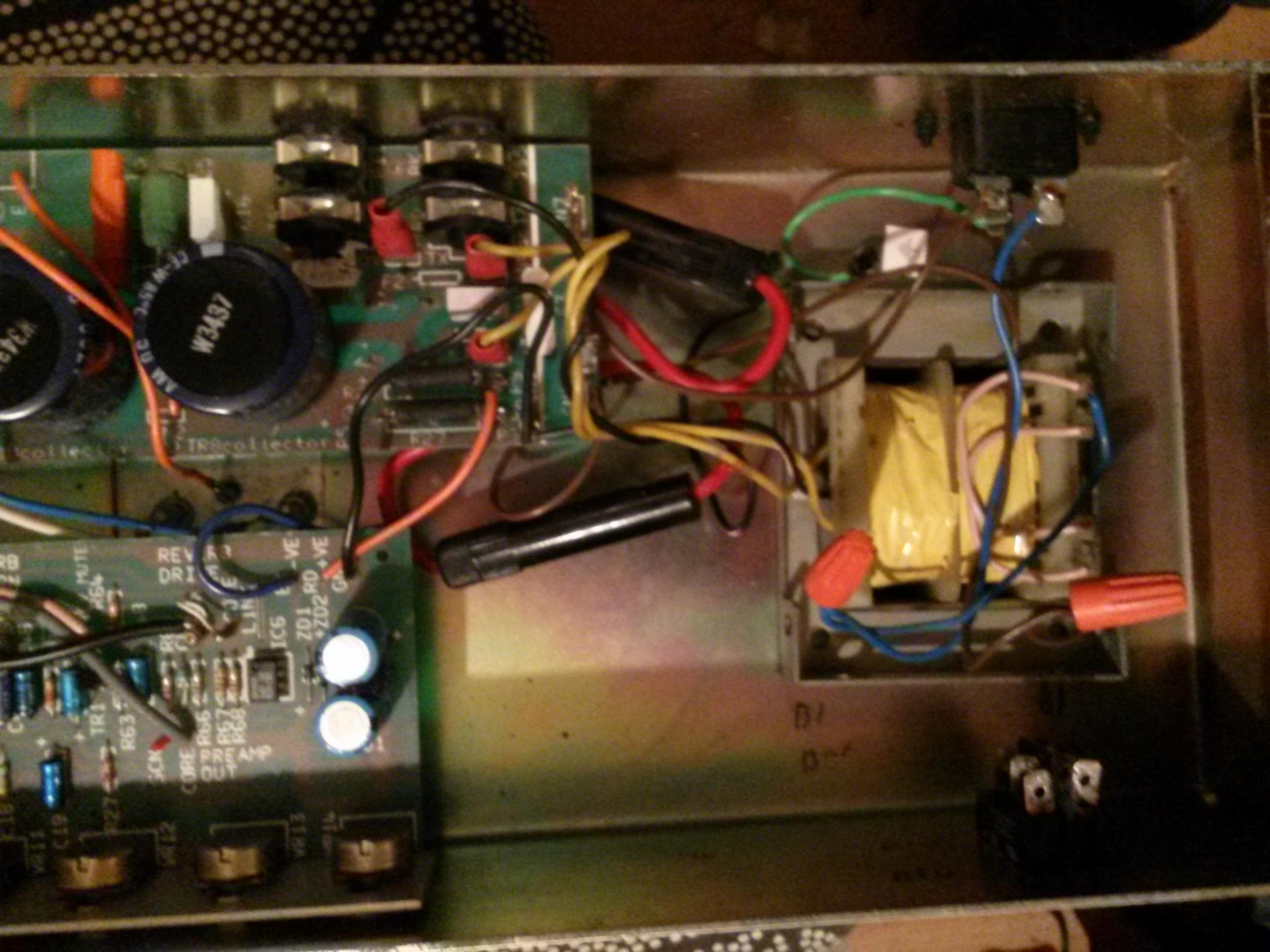

New Pictures !!

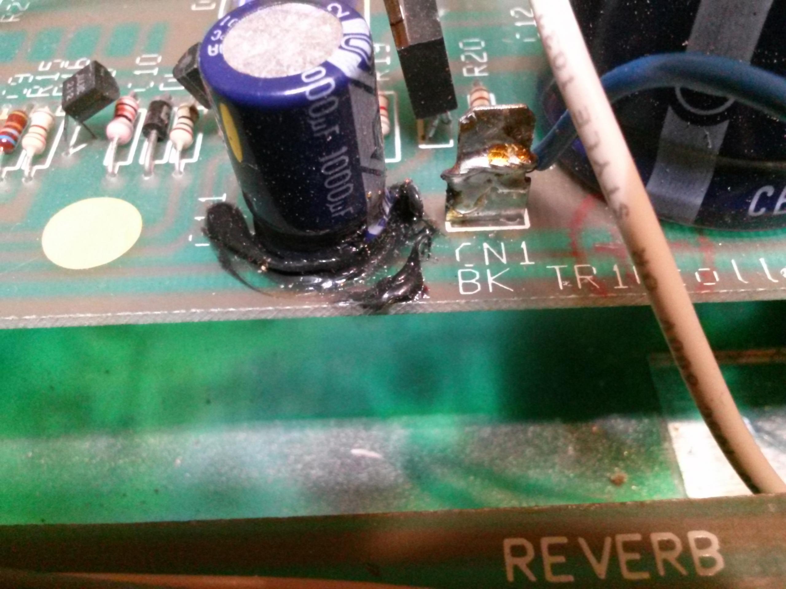

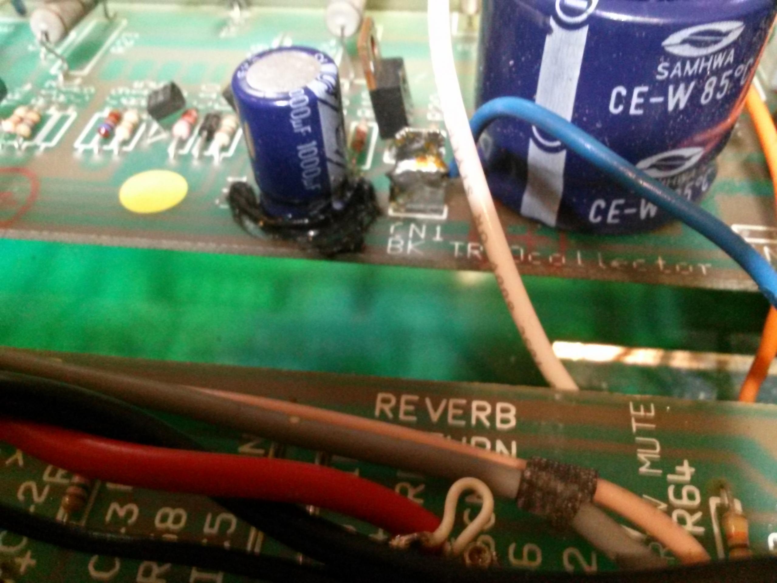

I'm wondering about this black goo on the last picture at the bottom of a capacitor. Is that supposed to be there?
Good eye! That could be a leaky capacitor. Do you have a soldering iron? If so remove it and either test it (this video will show you how) or simply replace it to be sure.
Some techs and electronic wizards don't mind having someone watching and learning while they work (some do). What, IMO, would be great for you is if you could take your amp to someone who can repair it and explain what they're doing and let you watch and ask questions.
humm i don't think it's leaked electrolyte i think it's silicone to hold the parts, the big caps will have a blob below them but there large enough to conceal the blob.
from these pic's the only thing that appears to be missing is the bridge rectifier and two funky non standard fuse holders.
