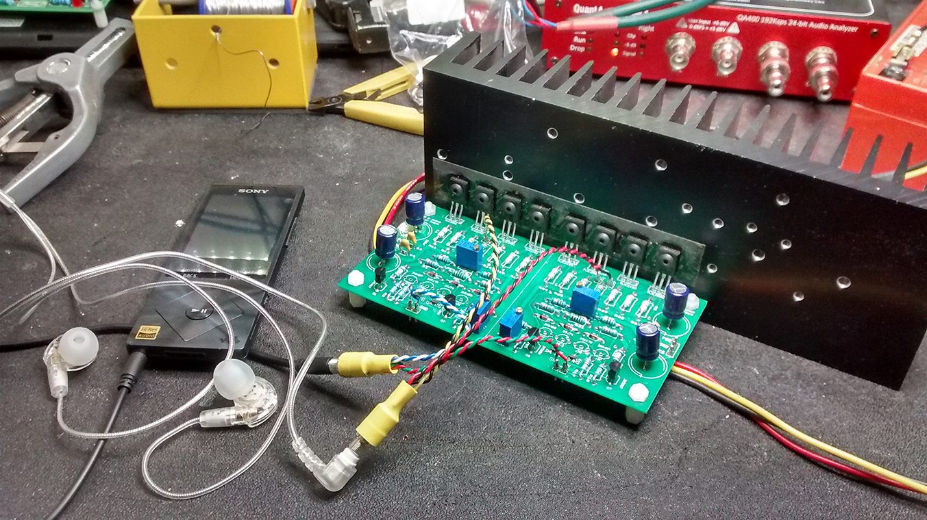

Put some 3.5mm jack sockets on the amp and had a quick listening test through my AKG K240 studio cans(flat response), the amp sounds very good, it's clear and has a lot of low effortless grunt.
Also tried some HiFiMan RE400(32 ohm) and MEE M6 Pro(16 ohm + flat response) earphones. Both sound very good with the amplifier, crystal clear and good natural bottom end.
Source was a Sony Walkman NW-A25 which also has a few Hi-Res albums in it.
Next I need to connect the amp to my E-MU 0202 usb sound card.
Still using the 2x 12V Yuasa lead acid batteries for power, all the transistors are running cool and there's no hiss or other noise at full volume from the Walkman.

I think it sounds great! I have always been a fan of the older receivers with headphone outputs that were simply series resistors off the main outs. This has more detail than any of those I have heard. Noise floor is very quiet! I have run this on Grado GH1's and Senn HD6xx with no problems.
I recently built the Pass Whammy and I must admit I like the musicality of the Pass only slightly better, but the noise floor of yours is much lower.
Next step is to play with my USB reference mic and miniDSP per your article to check frequency response and apply some filter correction between pre-amp and headphone amp just to compare the Grado and Senn and see if the scale really does "balance"

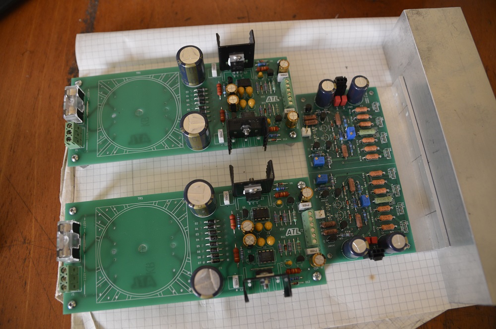

Waiting for transformers and believe it or not a small pillar drill for the heatsink work. My Dremel isn't quite up to it.
For this build I chose a pair of Sulzer Regulator boards from ATL:
PCB for modified Sulzer regulator – v.2 | ATL Hi-Fi Audio Company
Hopefully my calculations are good for around 20V rails.
Also hoping to snag a decent scope so I can show something meaningful other than pics of assembled boards! Possibly I'll just get a Velleman PC scope with function generator.

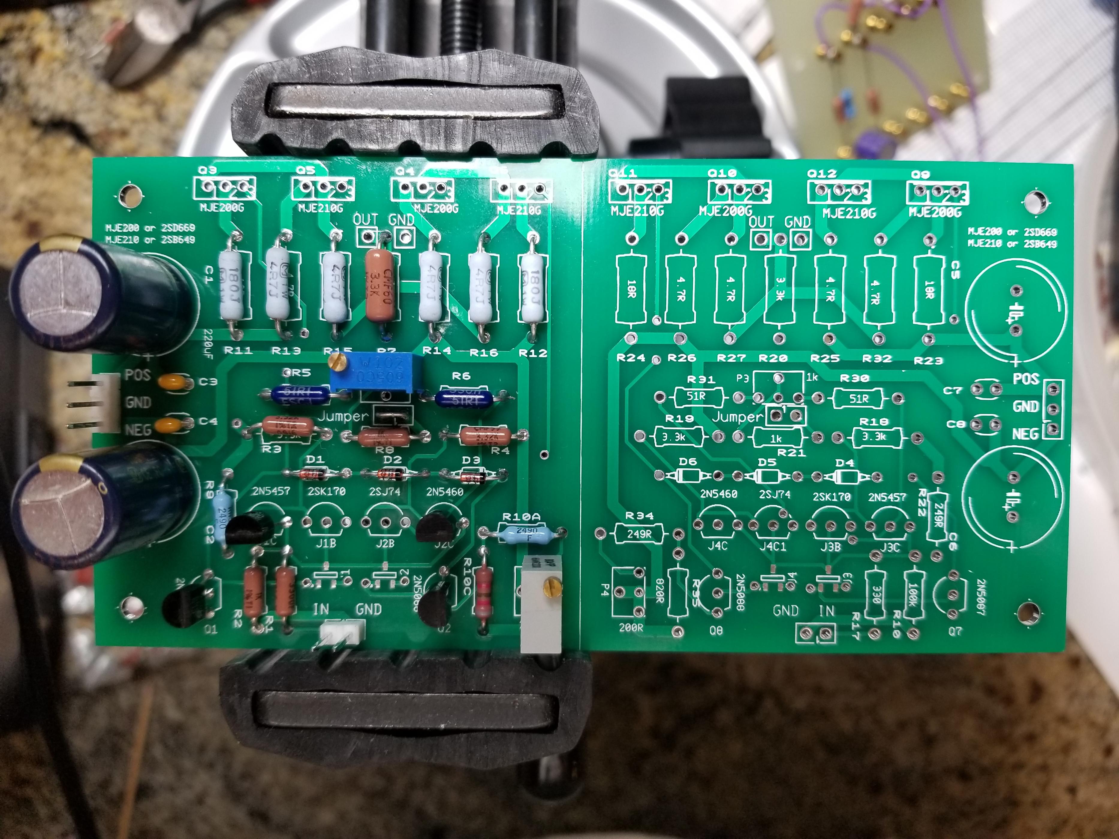

Friday I received the HPA PCB and parts kit. Most of 1 side is fabricated. I did swap out the provided source resistors for the specified 51R1 value (dark blue Vishay RNC55 resistors in the photo) also the specified 249R resistors were swapped out (light blue Phillips RN55 resistors in the photo).
I also have received from Mouser some MJE 200 and MJE 210 transistors that will require matching. I have a Keysight B2962A SMU that records Volts and Amps, the software will plot curves and calculate parameters for matching.
Looking forward to mixing and matching and testing results.
