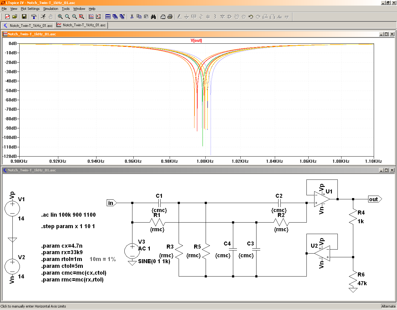

SY...look into the work done in Equipment and Tools forum with Davada. I already did the work on these sound cards type compared them to the best commercial test equipment.
Without reading your back issues in AX, I can say you can get best results with notch filter and a sound card. Do you use a notch filter?
THx-RNMarsh
Joined 2008
What about DIYing a Twin-T notch filter? Any experiences?
In the sim I assumed to get the caps matched to 0.5% by adding some smaller ones in parallel, starting out with 2% polystyrene for low tempco. The resistors are assumed to be matched to 0.1% by series trimmers added to each leg of the 'T'. Add in a nice dual opamp and a Dual Salas shunt-reg power supply...
