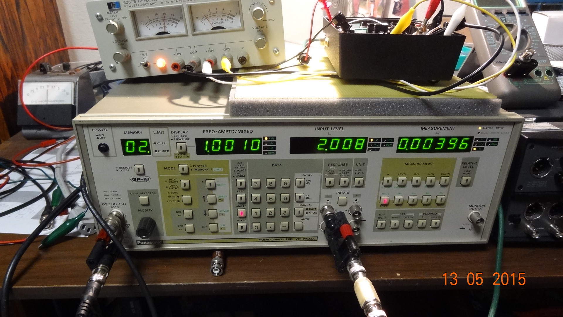

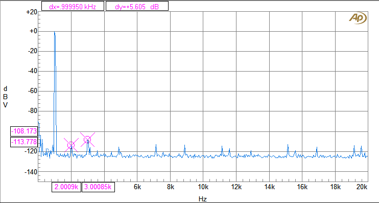

0dBV into 250 ohms -- using a lab supply (not a super-regulated low noise supply):

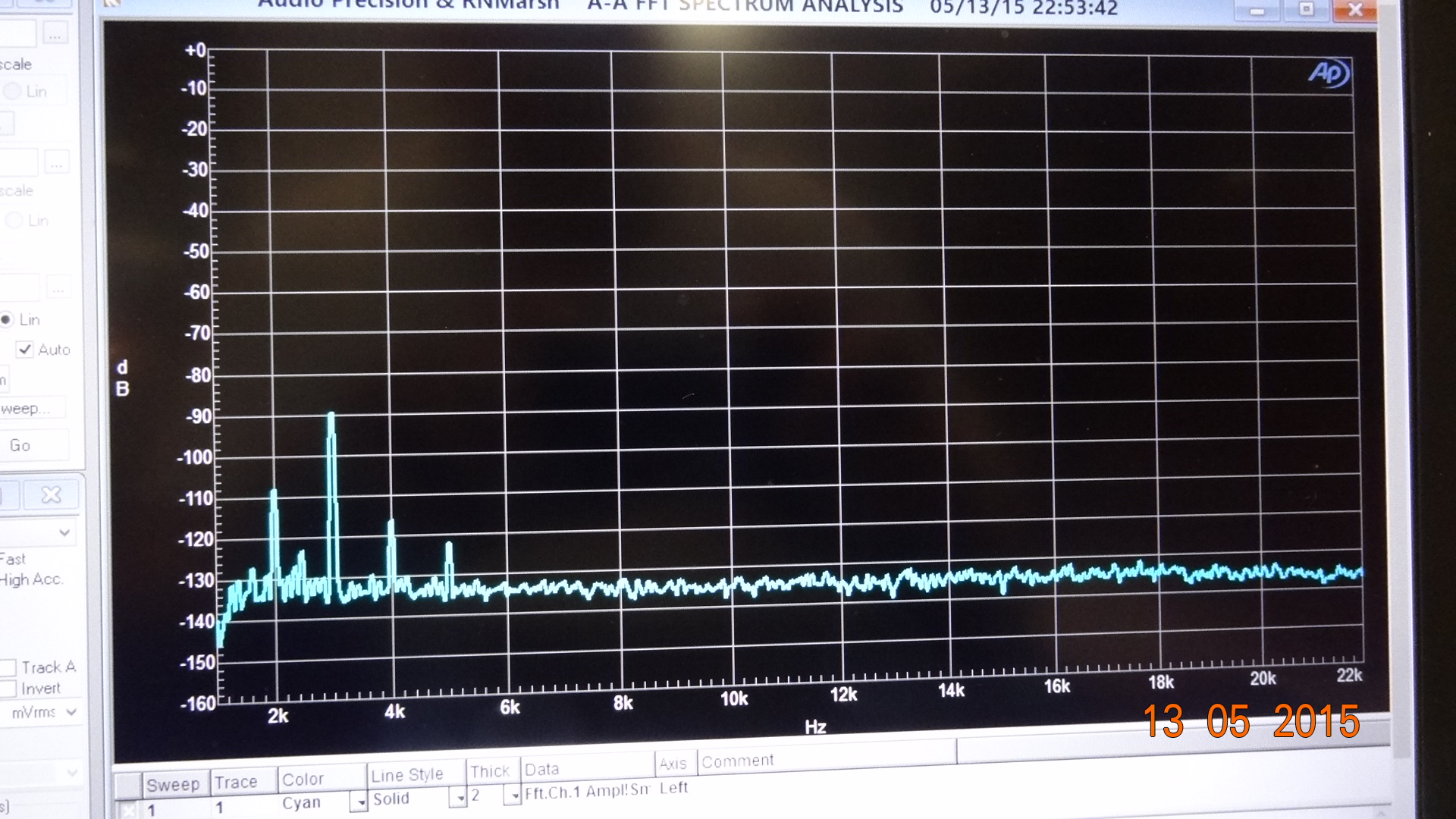

Early in this forum... I gave my measured data for low Z but more recently, I have found the distortion is even lower into low Z loads when I use the +/- 24vdc supplies... which need the higher voltage output devices... although I did test it with originals to 24 v and nothing smoked. But wouldnt recommend other try it. I am going to the higher voltage supply and OPS then will give new numbers here.
THx-RNMarsh

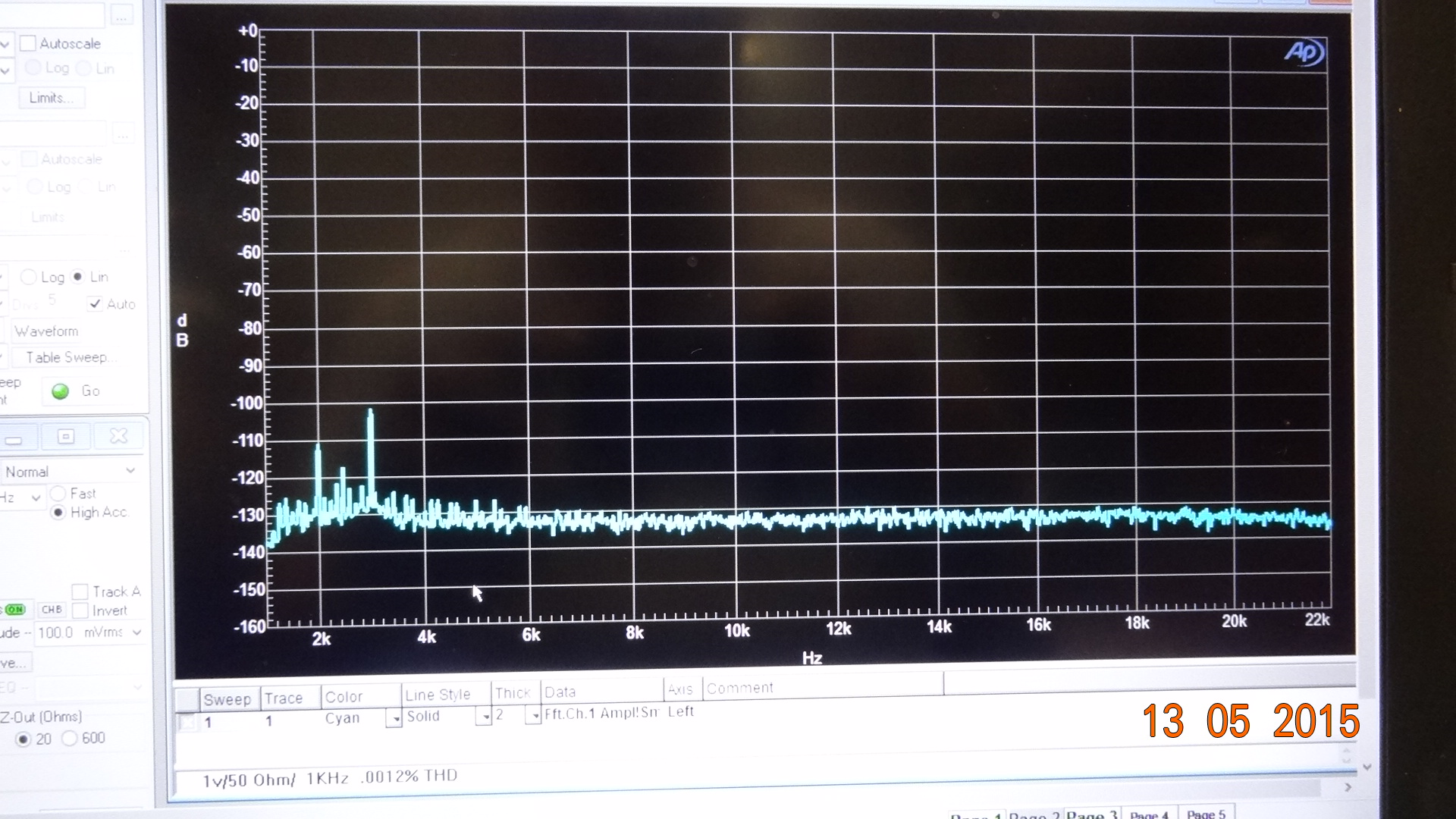

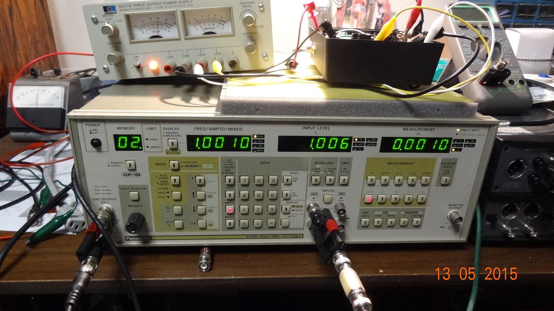

using all original p/n and +/- 15vdc power supply -- Here is THD into 50 Ohms:
1v rms and 2v rms - no filters used:
