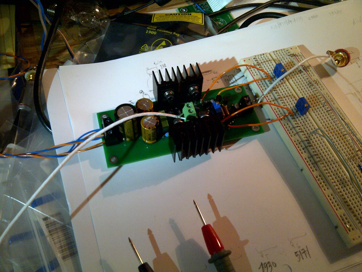

Soldering a parallel resistor is tiresome.
Yes, and ugly too You can simply attach a trimpot, fine-tune, and replace it with a fixed resistor. This is how I did it, and it turned out quite easy to do. You don't even have to solder/desolder it: chose a piece of cable that tightly fits in the hole
(And you don't need to do it for both resistors. Either R9 or R10 will do).

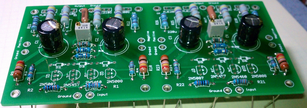

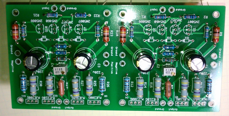

?? awfully quiet out there... .
i'm almost done with mine.
maybe tonight i'll post a pic or 2.
still matching my jfets and diamond transistors.
i'm trying Sanyo 2SA1507S and 2SC3902S as diamond stage devices.
i still have to put the jumper in also.
maybe sunday (?) i'll be ready to listen ...
