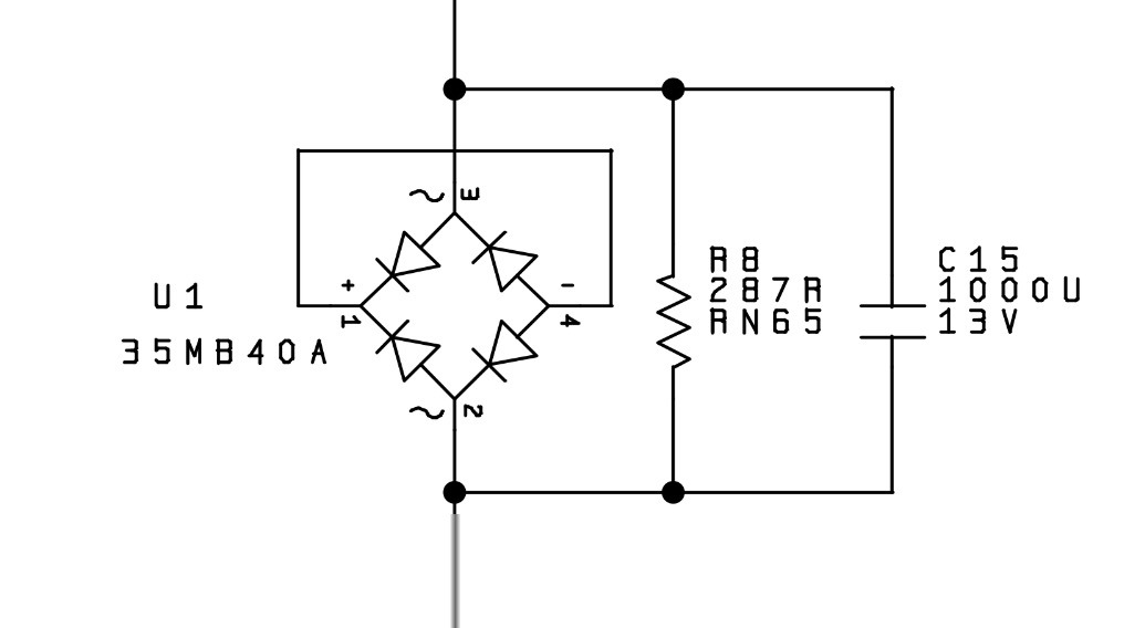

Voltage after 317T/337T regulation is 77+77v in HPA and 55+55v in AMP5
when the relays activate, the +16v drops to +9v but the +77v remain stable. The 16v zener diodes are new x 5W. ....R504,R505,R506 are new.
I have resoldered and checked the board.
I have checked the relays, their coils are 1k and resistors R26 and R27 are OK.
U300 is new. U301 is the original.

The resistances raise their temperature quickly and cannot be touched. This will continue to damage the board from the high temperature. I can't understand who made this design.....
Interesting - the power supply diagram of the 5 channel amp shows 50V caps, which must be definitely wrong, otherwise you would get a hand grenade due to over voltage on these parts
Try to increase the value as high as possible to minimise the dissipation (3 resistors 2k7 in parallel), another possibility is to change the mains supply voltage of the amp to 240V (if possible) which will decrease the power dissipation as well.

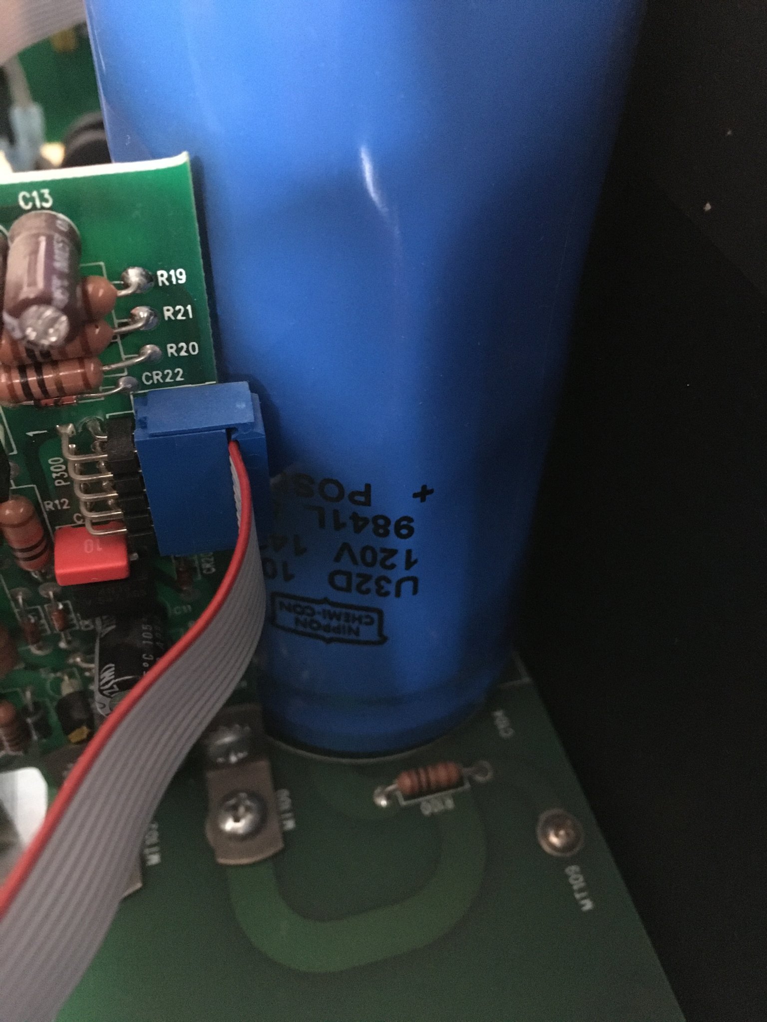

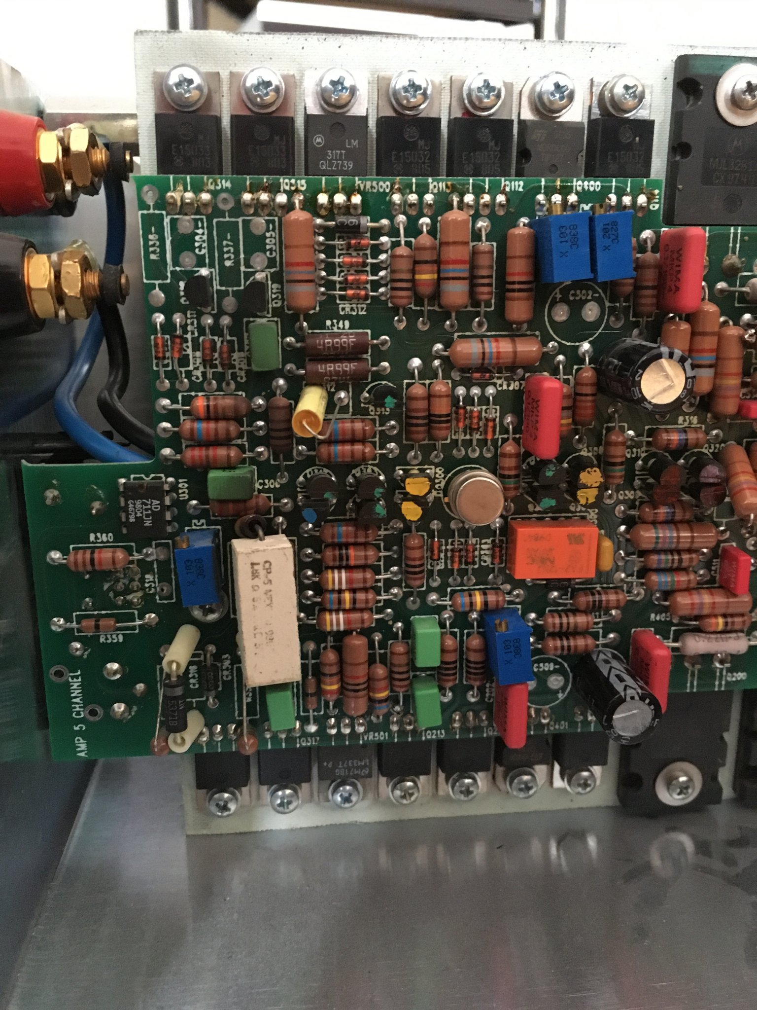

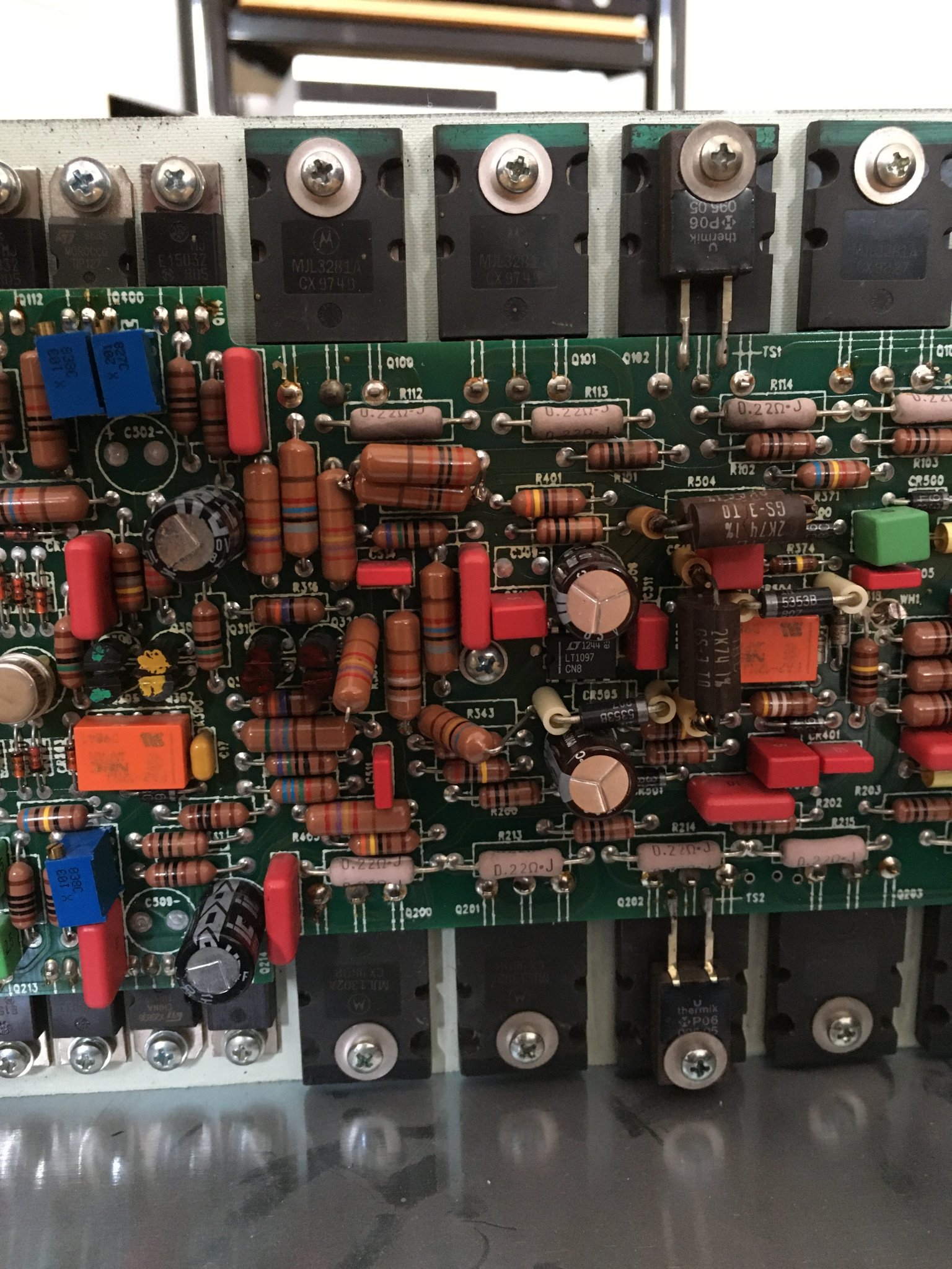

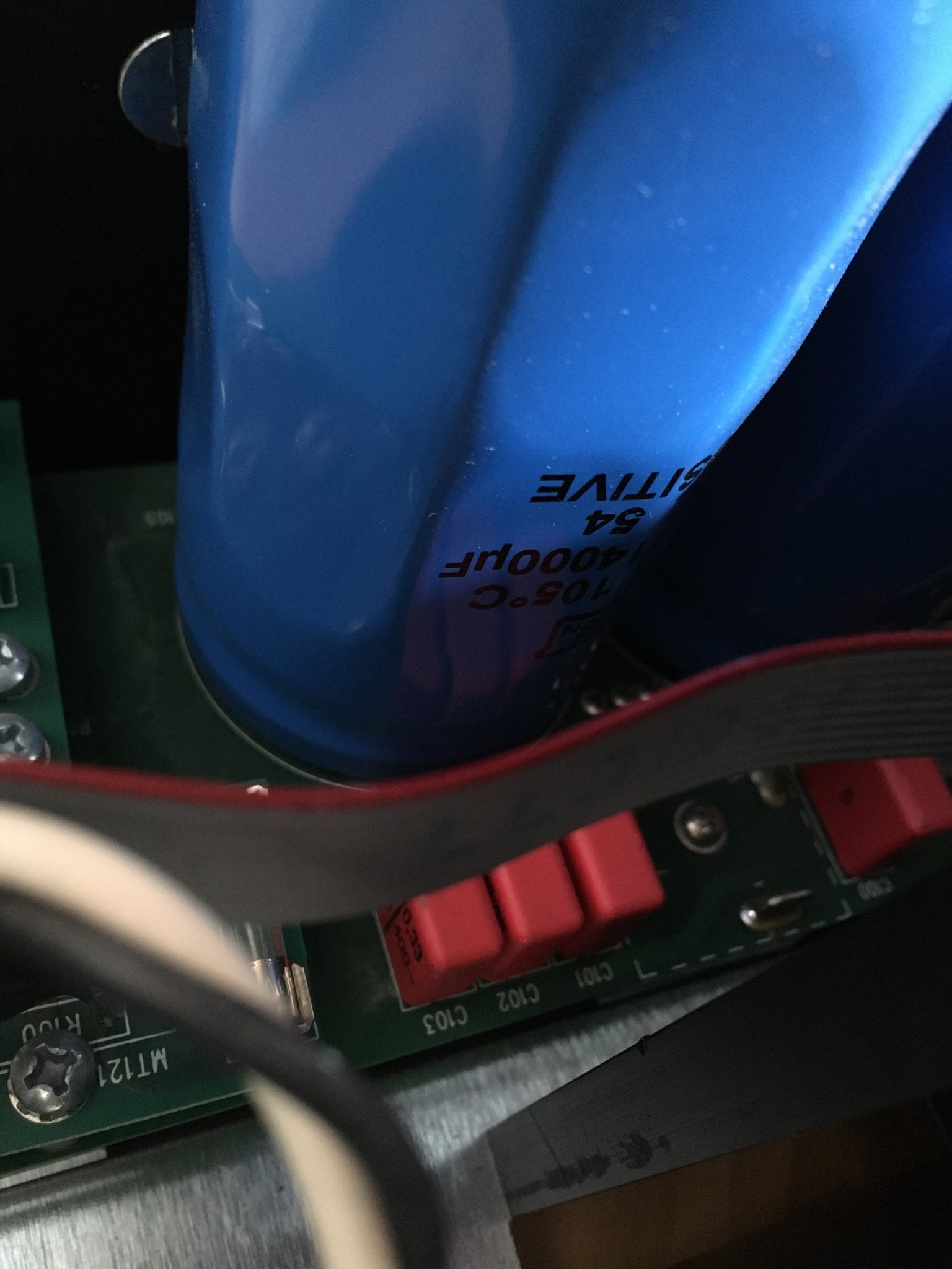

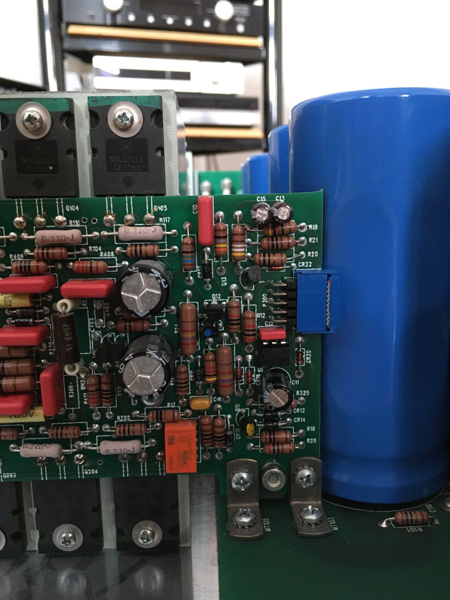

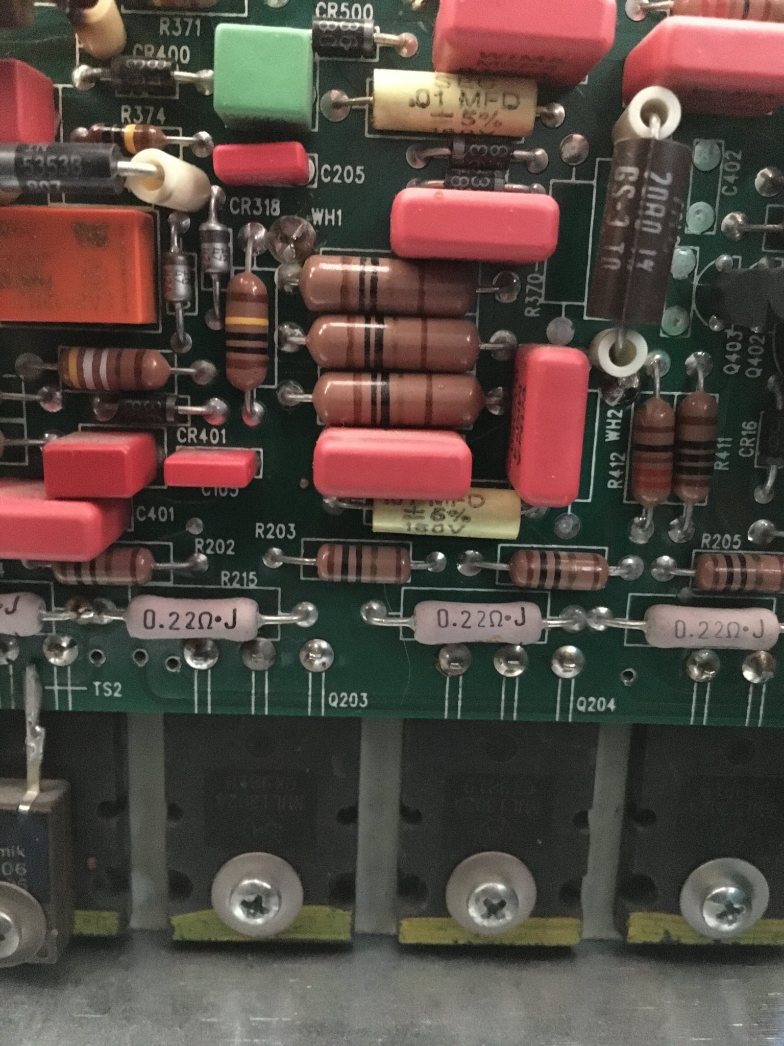

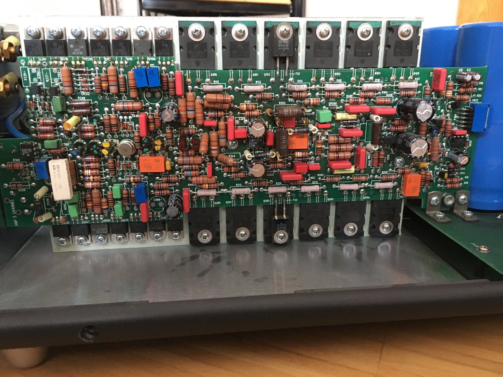

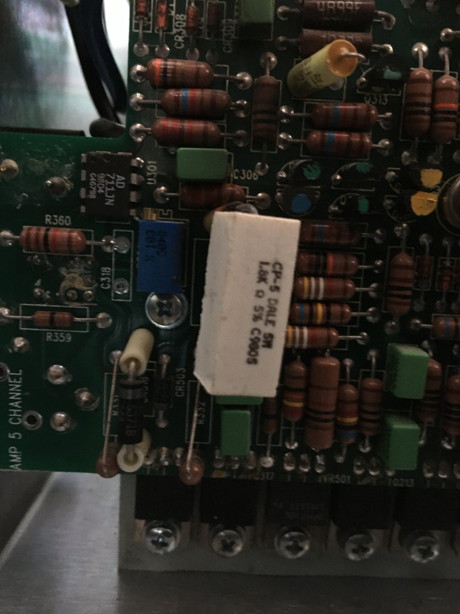

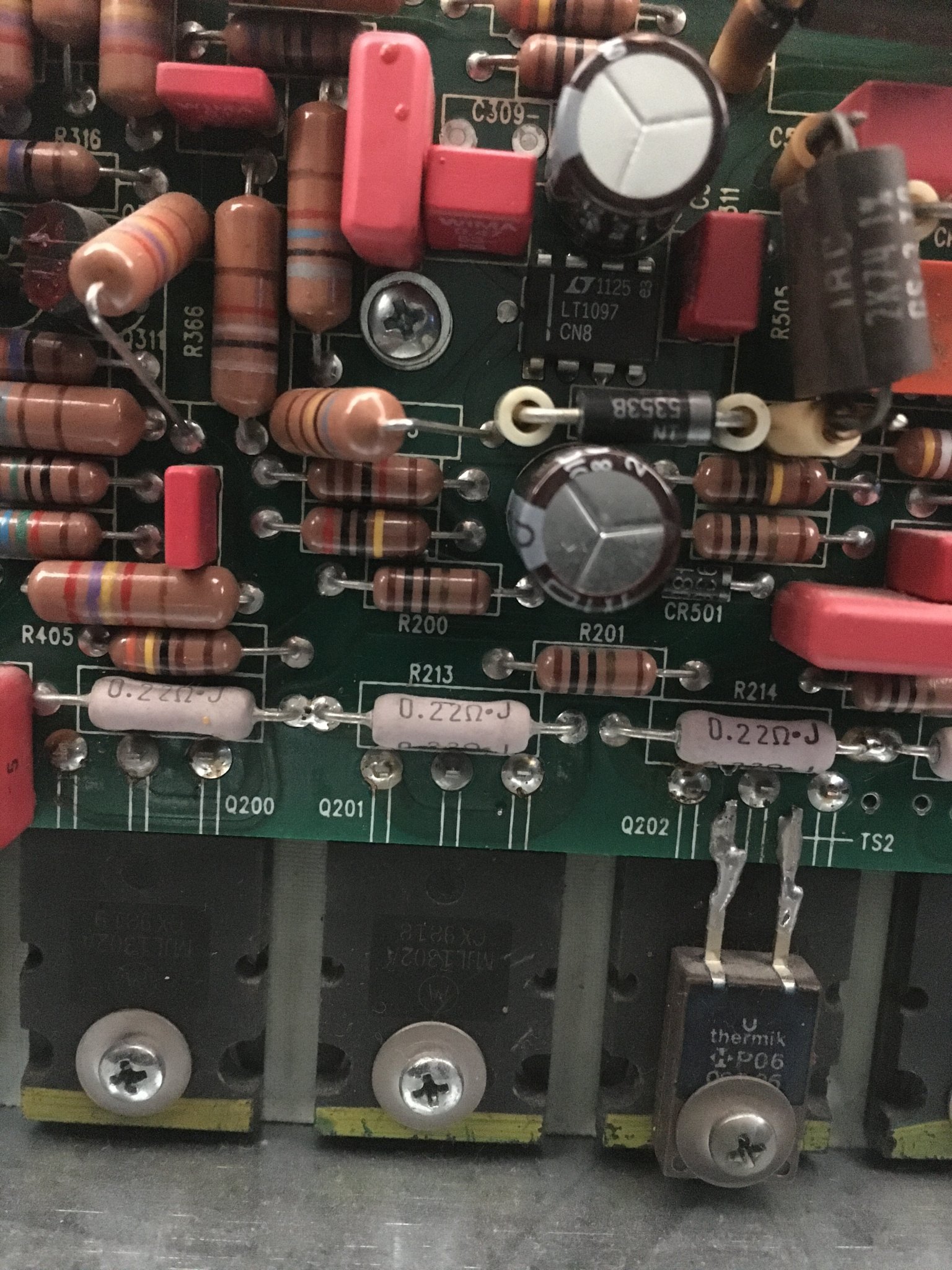

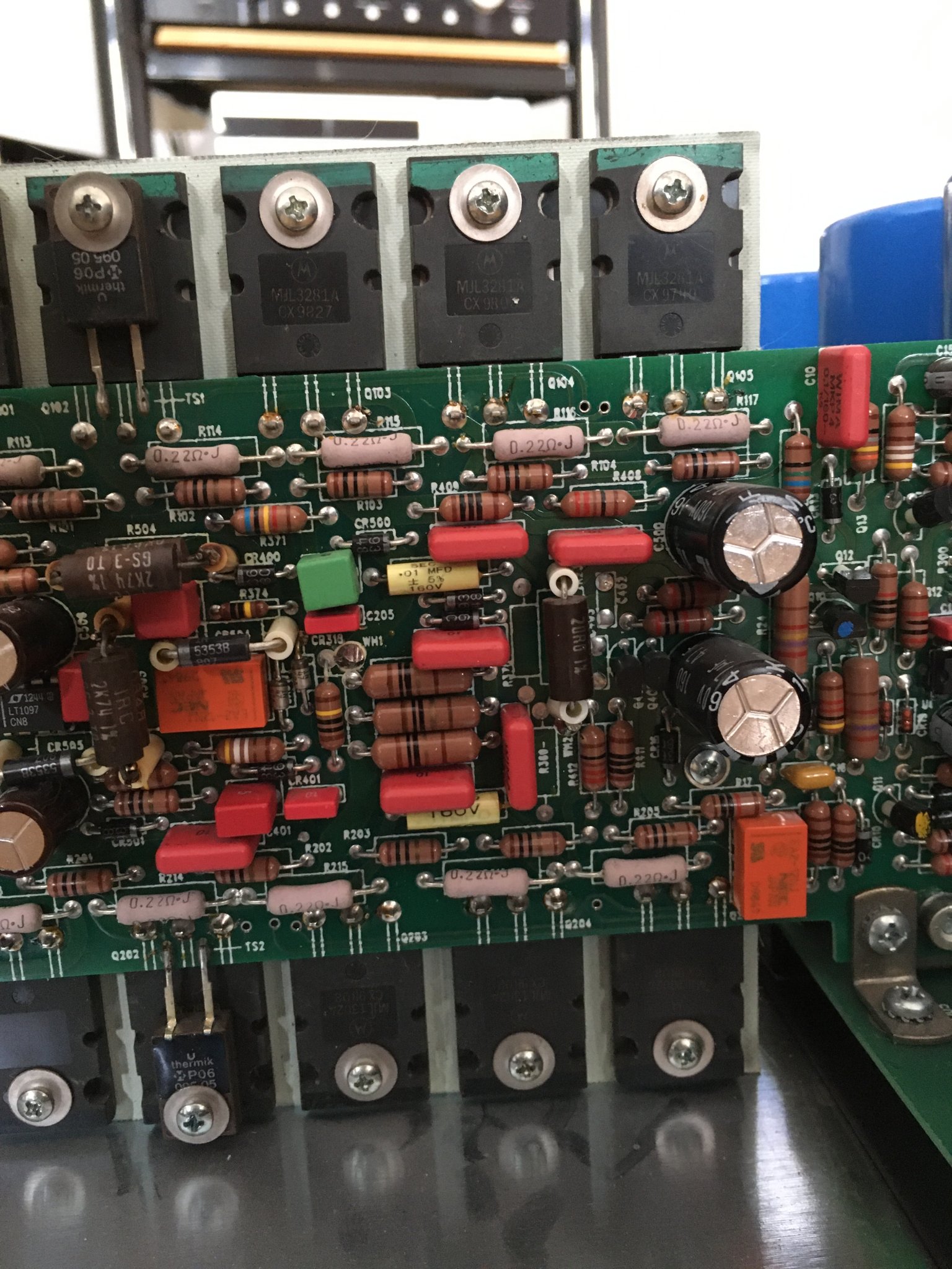

P.S: I attached some pictures of the PCB of one channel. Looks like someone played a bit with the AMP5 board and cramped all components on this compact PCB...Obviously the ML design looks more neat...but in terms of trace lengths this should be hard to beat...
luckily I found this thread and was able to learn a lot about my Proceed HPA2 and the ML 431/432. Thank you for sharing the schematics!
I compared the material for the HPAs and 431 and I can hardly find any differences (HPA: MPS8599; ML43x: MPSA56, HPA input buffer to compensate for the 6dB drop on RCA input, double capacitor size on ML431). The adaptive bias circuit seems a bit different (maybe just differently sketched). Do you expect any significant sonic differences between the HPA and the ML431?
I was a bit dissappointed to see a pretty basic regulation for the voltage gain stage based on LM317/337. In the past ML used a more sophisticated regulation for the higher powered versions e.g. 331 vs. 332/333 and 334 vs 335/336 (I saw the schematics for the 336 and still have to understand it...looks very complicated). Since this specific page of the ML432 schematics hasn't been shared (yet), could someone check if this model is also using LM317/337? Maybe there is some potential for adding such regulation to my HPA2
Would be great to also get your feedback on below questions:
- ML431 and HPA2 seem to be so similar but HPA spec seems superior (from data sheets, besides output power only one value for 431 and 432 provided). Why?
HPA: 250W@8Ohm, with no more than 0.1% THD, FR variation within 0.15dB ( all 20-20kHz), SNR better than -80dB (@1W)
ML431: 200W@8Ohm, with no more than 0.5% THD, FR variation within 0.3dB ( all 20-20kHz), SNR better than -65dB (@2.83V)
- I assume that the higher output power of HPA vs. 431 is because of a higher unregulated rail voltage, right? Then why is the idle power consumption of 431 2.5x the one of HPA (standby consumption for both ~100W, idle 150W (HPA2) vs. 375 (431))? Is this caused by a different adaptive bias scheme? How to see that from the schematics? I thought that the main advantage for adaptive bias is to limit the bias to the minimum level needed to keep "class A" operation load and signal dependent. Was the HPA level too optimistic so that they changed for the ML range?
Sorry for all the questions and thank you for your great support
Michael
Hi Michael,
indeed there is not so much difference between the HPA2 and the successor(s) ML431/432; ML obviously decided to produce two different amps, one with less and the other with more output power, the difference is mostly due to the different rail supply voltages and of course the different transformers.
I have had no HPA2 to compare with my 431, but I would not give too much attention to the different numbers in the specs; the audible difference is most probably very small. Much more important are the speakers, which should be able to handle peaks properly with small distortion.
