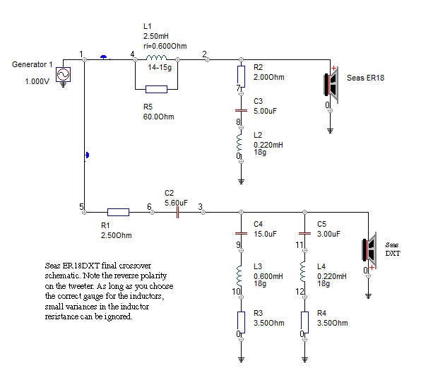

I'm thinking of possibly building a pair of these in the future. However, I'd be modifying the design to turn it into an on-wall monitor for near-field use with my PC.
As I don't currently have much knowledge of passive crossover networks, can someone please tell me what I would be removing or changing if I wanted to get rid of BSC in the crossover?

Is it still possible to get the crossover schematic for this design now that audioheuristics.com is gone?
I'd like to build these for my HT. I had them bookmarked for years, now finally ready to move ahead and the webpage is gone. oops!
I remember that it was a very simple crossover with relatively shallow slopes, which I prefer. Thanks!

next question, how close is close enough on DCR for the 2.5 mH inductor? The schematic calls for 14G with .6 ohm and I have an 18G with .88 ohm Looking at it being nearly half again more I figure it isn't a good idea; but thought I'd check since it would save me about $70 on the build.
Which coil you use won't make a scrap of difference. 0.28R change is not something you will hear. Consider the driver is around 6R!
10% component tolerance is about the limit of what is audible.

Mike kindly sent me the Finch circuit. As long as the slopes match, you can swap tweeters.
