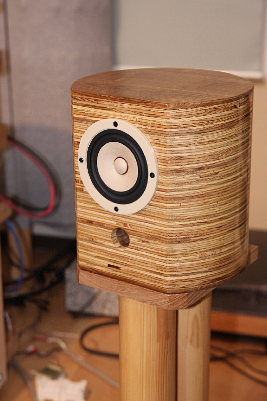

Mark,
Keep producing fine drivers of different flavors. I enjoy the new CHP and deploys easily into a premade box by PE. I can't objectively judge which I enjoy most of those I have built with (CHR g1, EL-70 and CHP) mainly because they're in different boxes (CHR g1s in a double till, pictures to follow this most recent build, EL-70 in one of Dave's mMar-Kens and the CHP in a .25cf PE box). I like the CHP best on too-trebley DACs and SS amps, I like the EL-70 with some of my finer amps (both tube and SE SS, and the doubletill's still breaking in.
I do hope that all this debate is taken with a grain of salt...they are all fine drivers at unbelievably low prices.....lets enjoy them all as we would different varieties of wine.
Mario

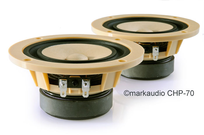

Thanks for offering! I'll have a white one please .
Talking of white... Mark, what happened to the white (ok, cream or whatever) frames of the CHP70 in the start post pics? Limited edition, first test production with a different plastic, one of for personal use? I think they look funny. So if these are available for other models (e.g. gen2), I'm interested. It might help with the w.a.f.:hug: of the project.
Kind regards, Jaap
1.) Forget about my cream basket question... I already found the friendly conversation on this topic in this thread:
Looks matter: What's the cheapest/easiest way to get the caramel bezel CHP-70 in EU?
But count this as +1 for natural colored frames..... The Humbrol paint is a nice suggestion though to change the appearance of the driver.
2.) At what stage in the production does the CHP-70 cone become black? I would guess the fibers are died black before the forming process. But what I'm actually curious about, is whether there is a difference in properties between the natural and black cones?
