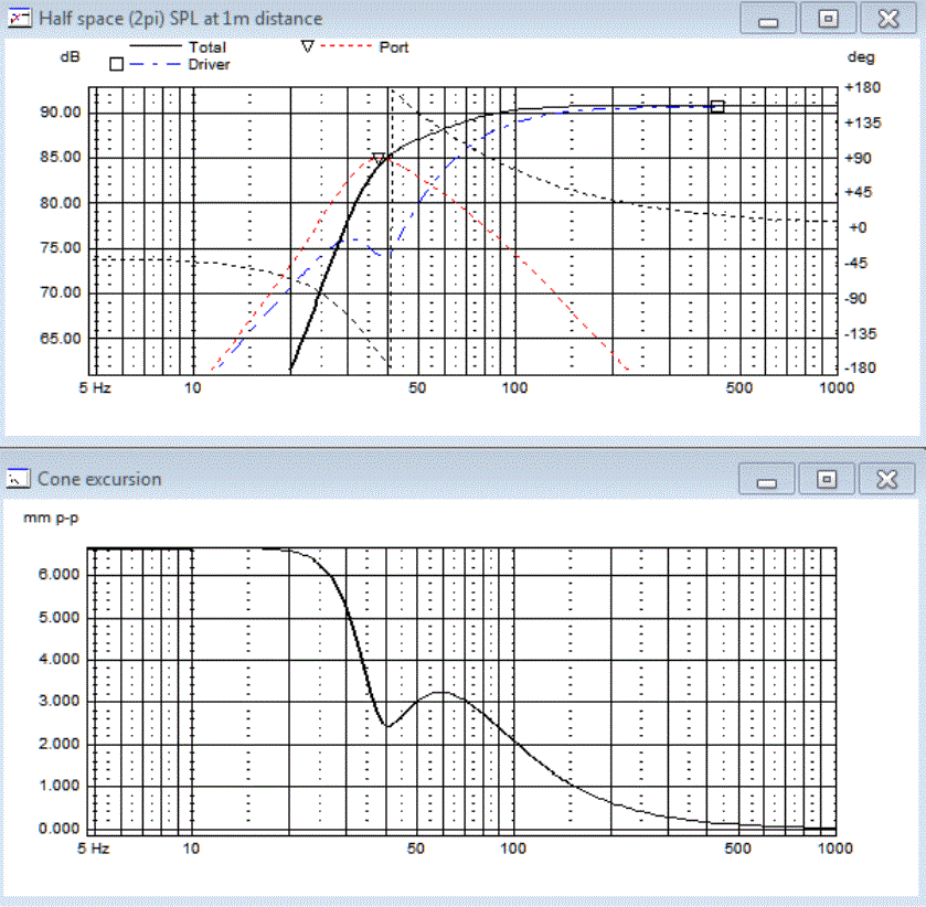

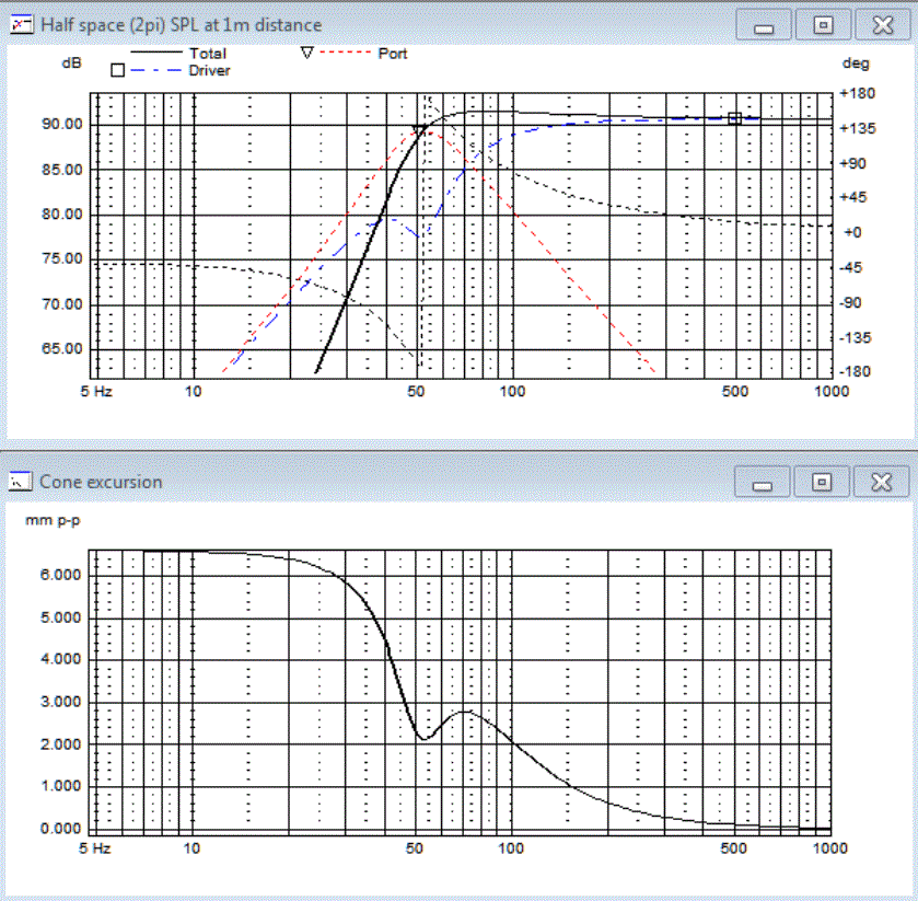

The P10 Castle cabinets appear to have two drivers in, one on the top one on the front, the internal volume is about 25 litres and the recommended port is tuned to around 52Hz. This seems a rather high tuning, you could of course have lowered the tuning yourself.
Either way are attached simulations for the EL70 in the castle cabinet. C1 is how the P10 PDF details the box. C2 is with the port length increased to 22cm. This lowers the tuning down to 40hz, gives you significantly more output slightly lower down in frequency, lowers the overall excursion down low at the cost of slightly higher excursion a bit higher up and slightly higher excursion at sub frequencies. As you're applying EQ down low anyway, this could theoretically reduce the necessary EQ and hence lower excursion, but also lower the excursion simply because of the lower box tuning. The lower box tuning also comes with slightly lower group delay and a better characteristic in its impulse response (it 'rings' slightly less) so could possibly give you better bass.
I noticed you built removable bottoms into your design, this would theoretically make it very easy to try out different port tunings. You may have already done this however. But if you haven't it might be worth trying it out. Also the gentle roll off below 100hz towards the lower port tuning is sometimes smoothed out by room gain and can help with integration into some rooms (normally smaller ones where room gain is greater).
If your cabinets aren't that heavily stuffed then you may need to increase the port length to 24cm for the 40hz tuning.
