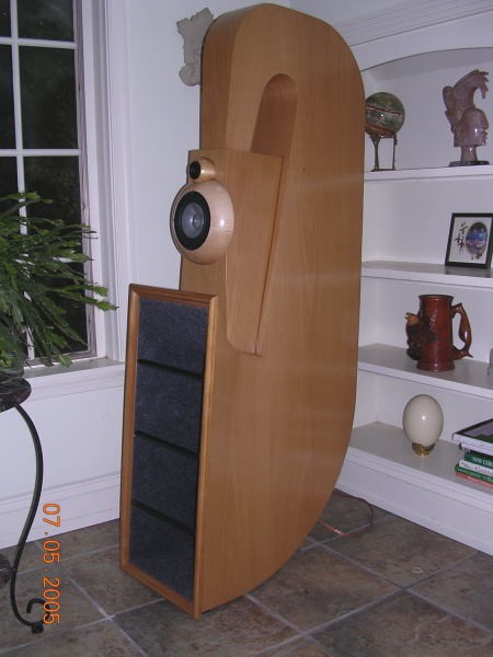

I have used the Jordan successfully in both a MLTL and a back loaded horn(long path), and I have to say I like the horn better. A lot more dynamic bass. It's much larger than a MLTL however. The Alpair 10's T&S parameters look close to the jordans so I would guess that it would work great in a properly designed horn.
PJN
PJN

Hi Peter,
Yes the JX92S, not quite the same as the alpair but similar, and about the same size. The point is that lower Qts, higher excursion drivers can successfully be used in back loaded horns. Of course you would need to use the proper design software to make up a specific horn design for the Alpair 10.
PJN
PJN

Hi PJN,
I know there is a german program called AJ Horn which is used quite often and it is said that this is very good - however I think I will tsrat with the Henkjan Horn and than see how I like that. Maybe later I will start trying to built one myself - but that is in the far future.
The picture that you attached - did you built that ? Is it only one Jordan JX92 ? Very very nice looking - bet it sounds as good as it looks !
Cheers
Peter
Cheers
Peter
