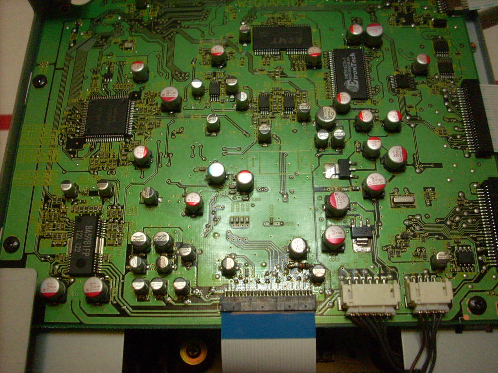

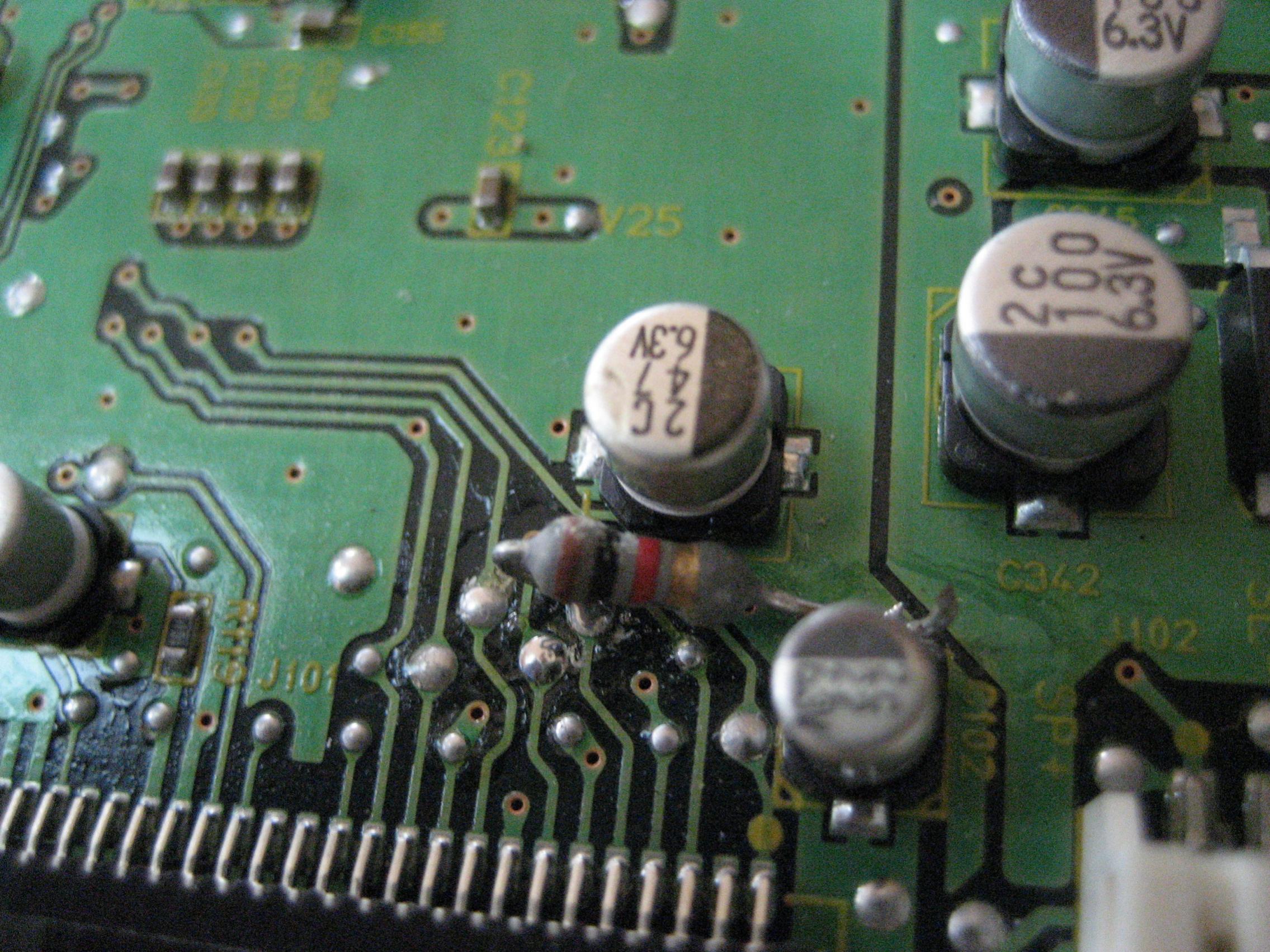

The very first thing that needs to be done with this player is to have a properly operating player that reads and plays discs without fail. The SA-8260has a design flaw that makes the above statement not necessarily a given. This became a big issue 2 or 3 years after player introduction and became known at the TOC Read Error problem. Marantz eventually came up with a solution requiring sending the player to a Marantz Service Center and a $200 charge. But the correction can be done in diy fashion quite simply, with just the installation of a 1k resistor on the servo board. All players need to be assessed to see if they have this resistor on the servo board, even if the player seems to be operating okay. Assessment requires removal of the transport assembly and board, and inspection of the servo board under the transport. The 1k resistor must be installed from the 5th pin of the ribbon connector receptacle from the laser, across to the ground pad of C102. This is shown in the photo below. This resistor MUST be installed. Check to be sure it is there before proceeding any further.
I regularly get email requests about read problems with this player. In response I have a file with complete instructions and pics on how to correct the read error problem.
See pics at the bottom of the post.

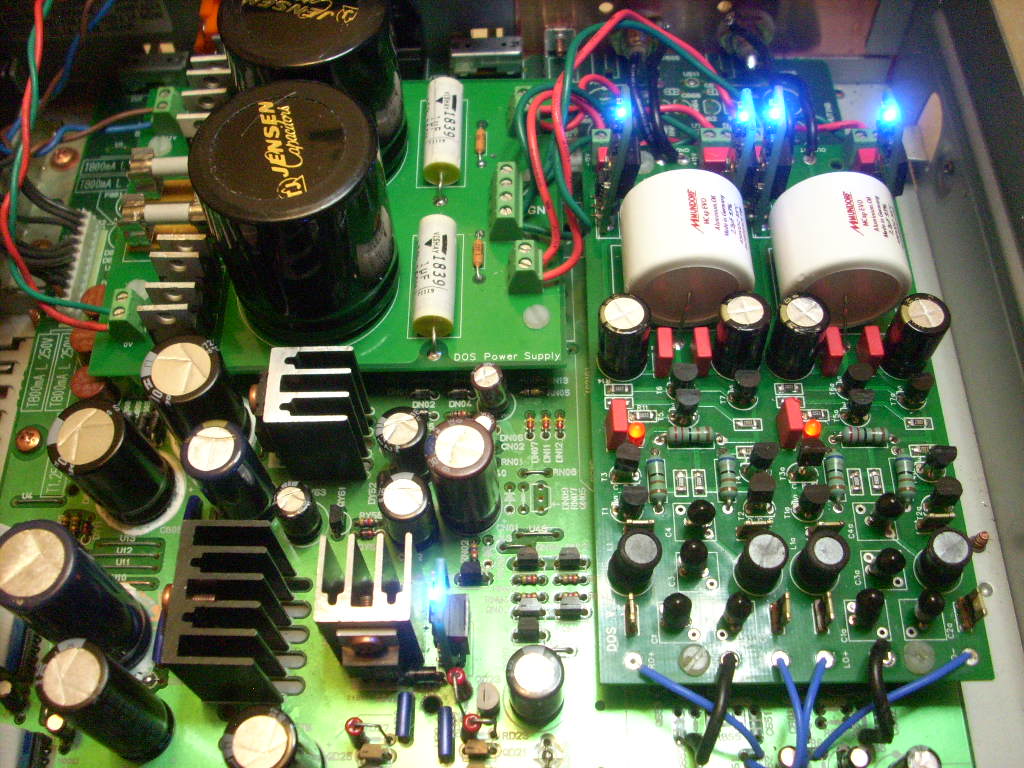

1. The DOS, discrete output stage. This replaces all the circuitry in the player from the CS4397 dac chip output to player output rca. Complete information, and a pcb, can be obtained here: Ray's Audio Page
Ray developed the DOS output stage, and I added some information. One change, not yet on Ray’s page is the use of the new Mundorf EVO capacitors for the output coupling cap. I have recently added this to my own DOS, with superior results in every way.
2. Analogue power supply modifications. This must be done as part of DOS installation as the DOS requires +-15v input. The simplest modification is to just change R853/855 to 4k7. This will give 15v on the positive and negative power rails to the DOS. You may also wish to swap caps in the analogue psu, per Ray’s recommendations.
I have gone much farther here. I have made my own pcb so as to use Jensen 4 pole supply caps. I also made an unregulated supply with only smoothing cap and shorting resistor. The DOS has regulators on each rail. Using a separate psu as I have done requires a separate toroid transformer. I followed Ray’s recommendation for this. This separate toroid for the analogue psu can be used with the psu on the main board, installation is pretty straightforward.

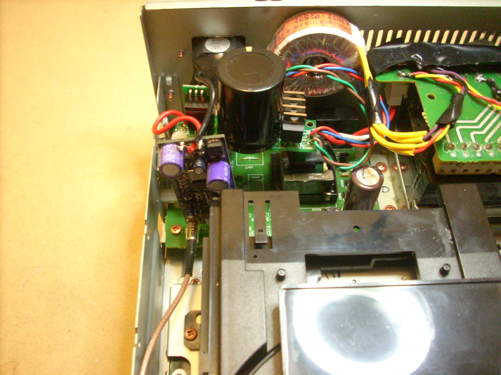

3. The installation of an aftermarket read clock. This used to be thought of as the beginning of modifications. But my experiences have shown me that it is more the icing on the cake. The Dos is primary. A clock is a nice addition. Ken Tripp’s website gives good help for those who need it.

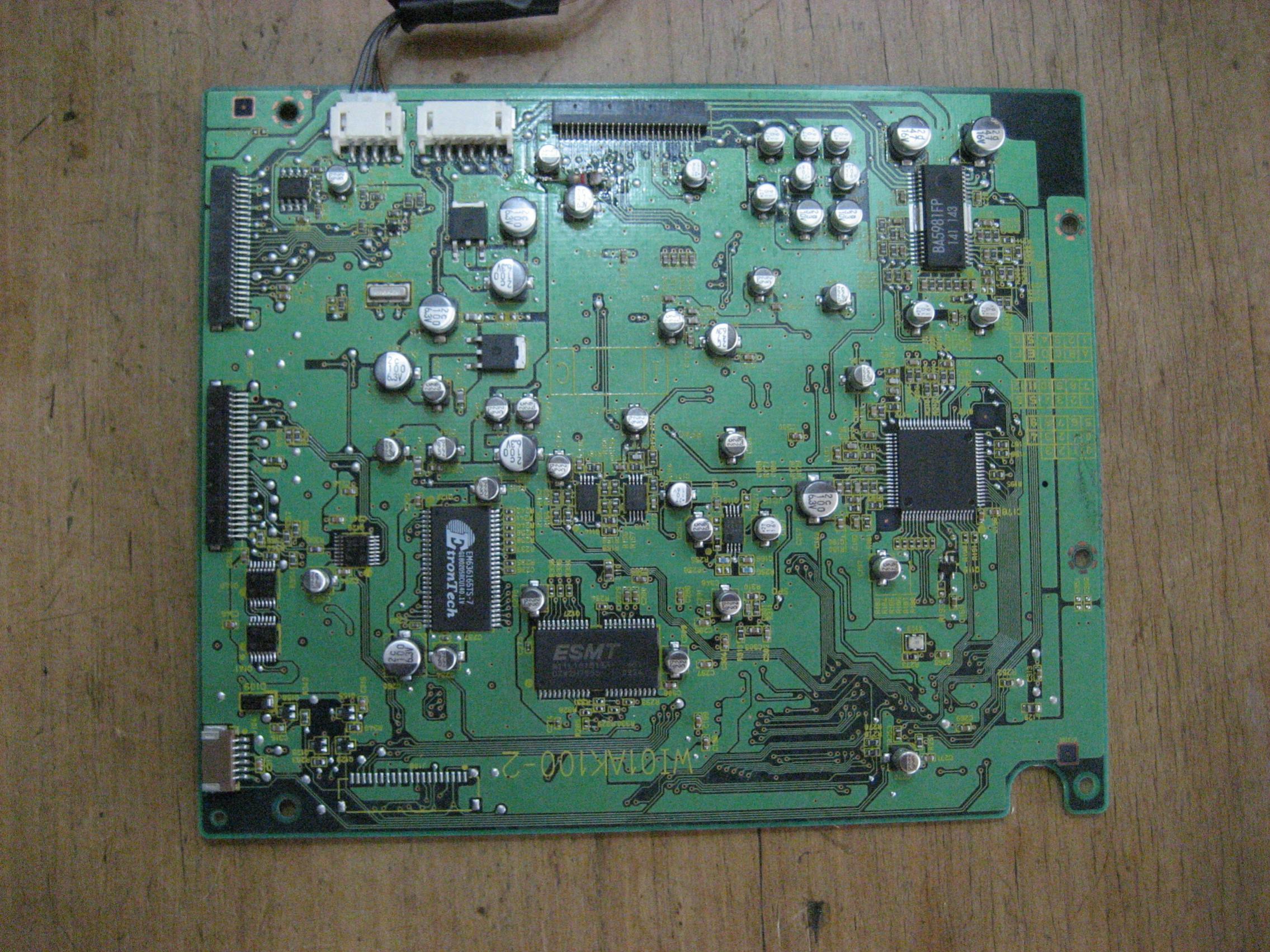

5. Servo board modifications. This is my most recent project on the player. After reading this thread, http://www.diyaudio.com/forums/digital-source/168247-guidance-needed-mod-marantz-sa-7001-a-6.html, and discussing this with Ray, I proceeded to swap out a large number of the smd caps and regulators on the servo board for higher spec capacitors and regulators. This is an extra and advanced modification. Be certain of your ability to desolder and solder smd caps before proceeding with this.

1. My DOS
My DOS differs from Ray’s design in that I run it at just over 4mA, while Ray’s design runs at 2mA. Either way will work fine. Here is how I made mine into a 4mA version:
R5 & R6 2k2 resistor
R9 & R10 150R resistor
R11 220R resistor
Everything else is the same part values as Ray’s.
Low Pass filter parts: Texas Components or Vishay resistors, REL polystyrene or AMCH polypro caps
Wima film caps elsewhere. BG rail caps, DEXA regulators, Mundorf EVO output caps
Below are some pics of my modifications
2. My analogue psu:
Jensen 4 pole 6800uf supply caps
Vishay 1839 smoothing cap.
Cree 3020 diodes.
3. Aftermarket clocks
I have used Terra Firma Lite, Superclock 3, and original Tent clock. TF comes with integrated psu. SC3 and Tent require separate psu’s. I constructed psu’s with psu boards from Fidelity Audio, sadly nla. A separate, or integrated, psu is essential for any benefit from clock installation. I learned this the hard way, powering clocks from the player and hearing no difference. The benefit of a separate low noise psu cannot be understated.

C336 337 342 345 260 347 from 100uf/6.3v to Nichicon FP 120uf/10v caps
C339 340 135 156 185 197 278 348 234 251 235 295 from 22uf/6.3v to Nichicon FP 47uf/6.3v caps
C212 213 from 47uf/16v to Nichicon FP 100uf/16v caps
C146 from 47uf/6.3v to United Chemicon NP 56uf/10v cap
Q151 152 to LT1963 3.3v
Q153 to LT1963 2.5v
