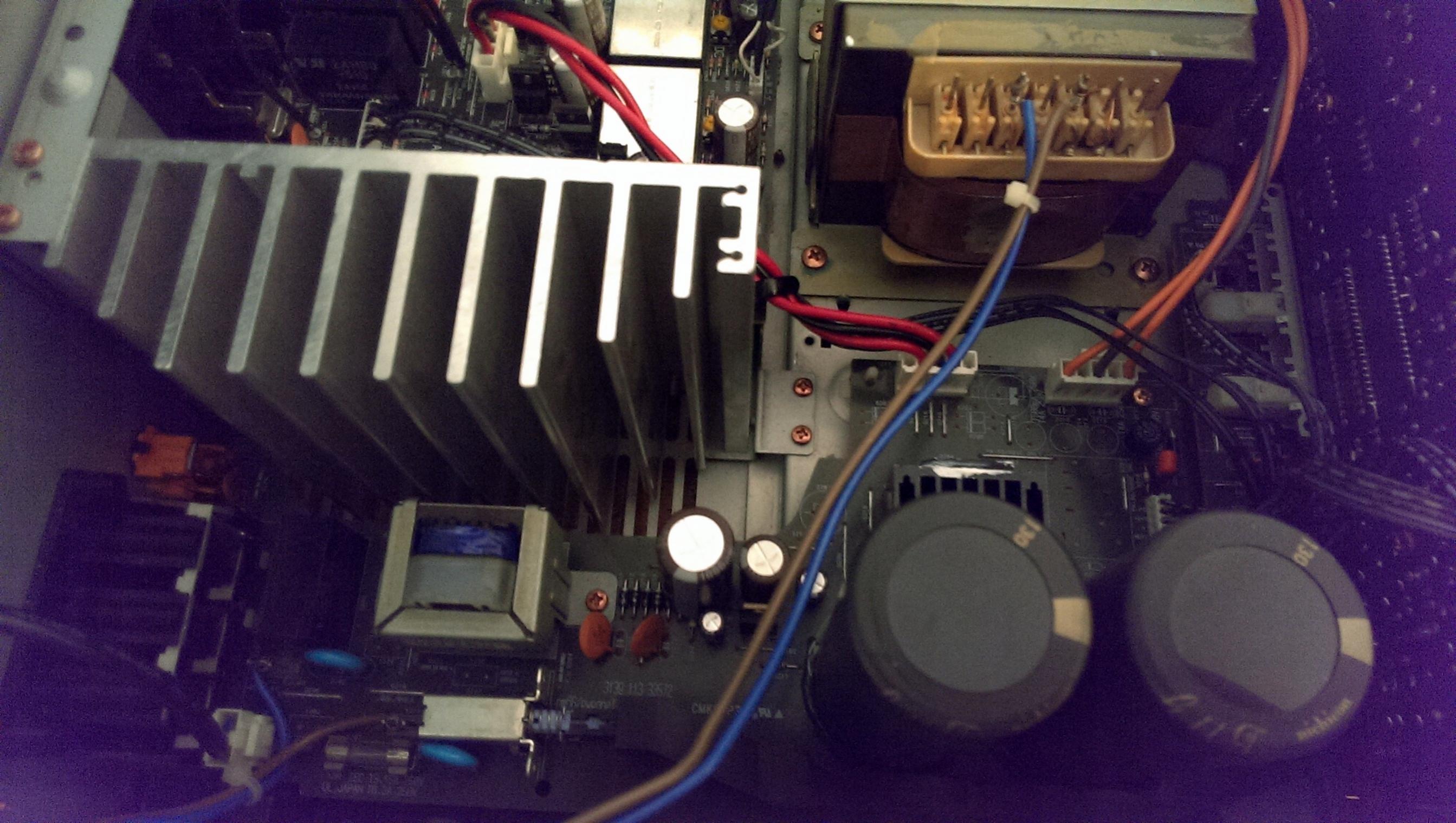

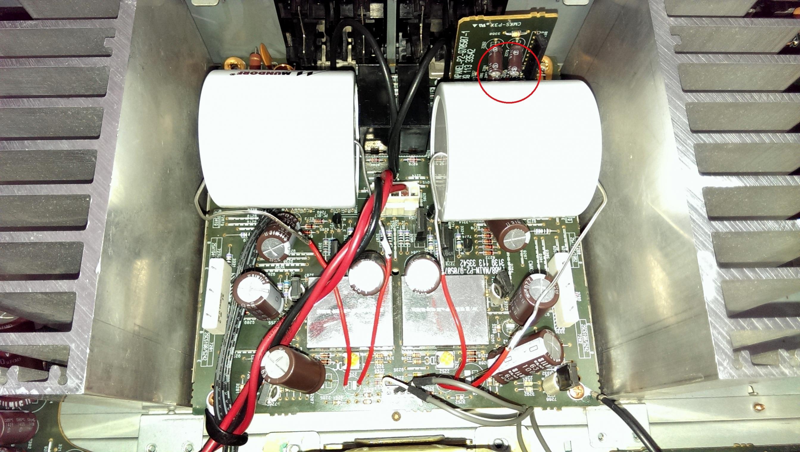

Hello everyone! This is my first post here.
I have a gold PM-68 amplifier since 1997. A few years ago it suddenly stopped powering up. Before giving it for service i decided to do all the recommended mods our fellow member McGyver recommended in his posts and in addition i replaced the rest of the capacitors in these 3 boards. Power board, volume board and main amp board.

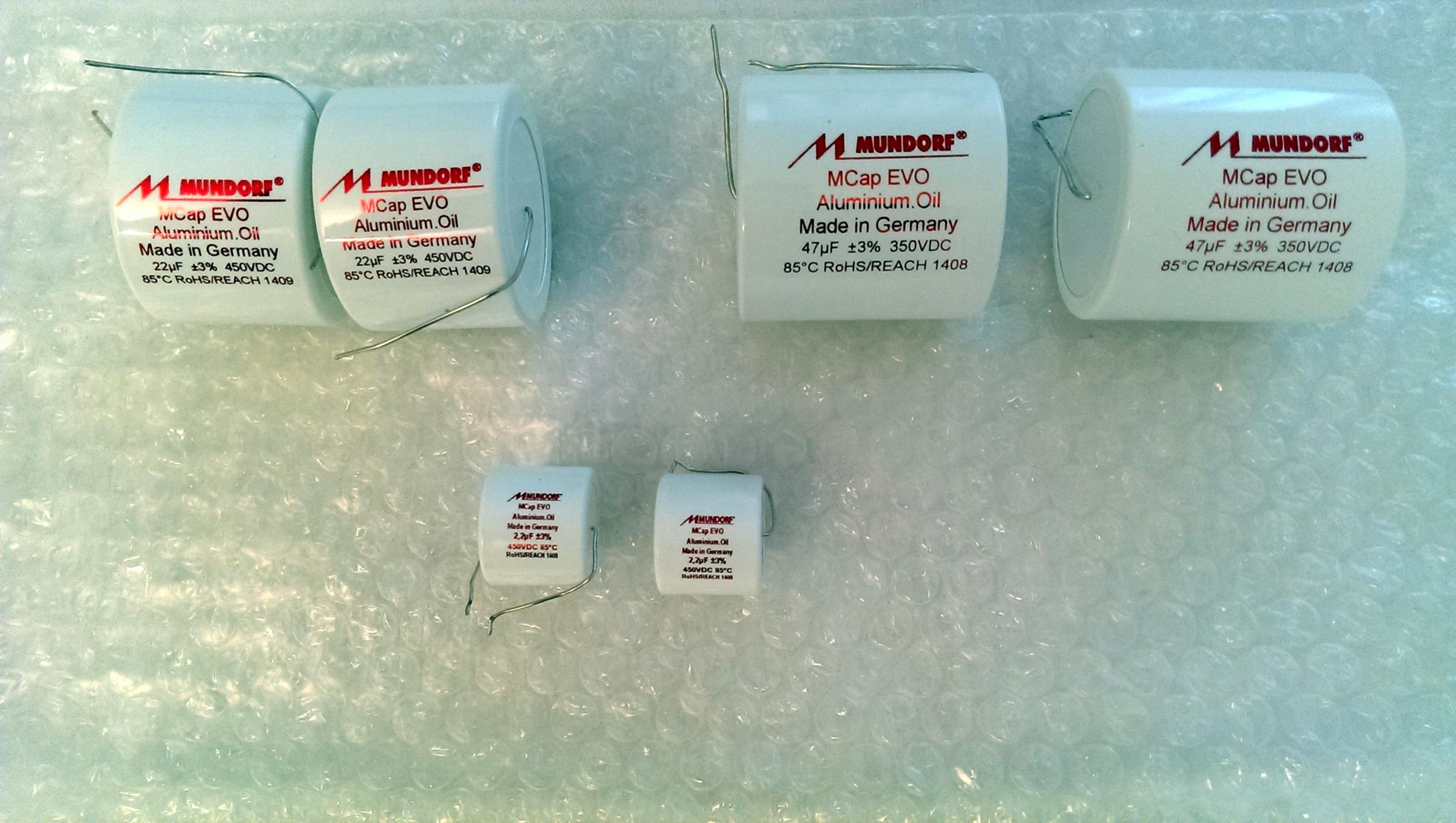

Power Board: I started by replacing GBU6D with 4 ultra fast soft recovery diodes HFA08TB60. The two large capacitors where replaced with 15000uF 63V Mundorf Mlytic AG. A group of 4 capacitors next to the diode bridge where replaced with same values elna silmic2.
Volume Board: Replaced the opamp with OP275. Replaced 2.2uF and 22uF elna cerafines with same values Mundorf MCap Evo Oil 450V.
Replaced rest of capacitors with same values elna silmic2.

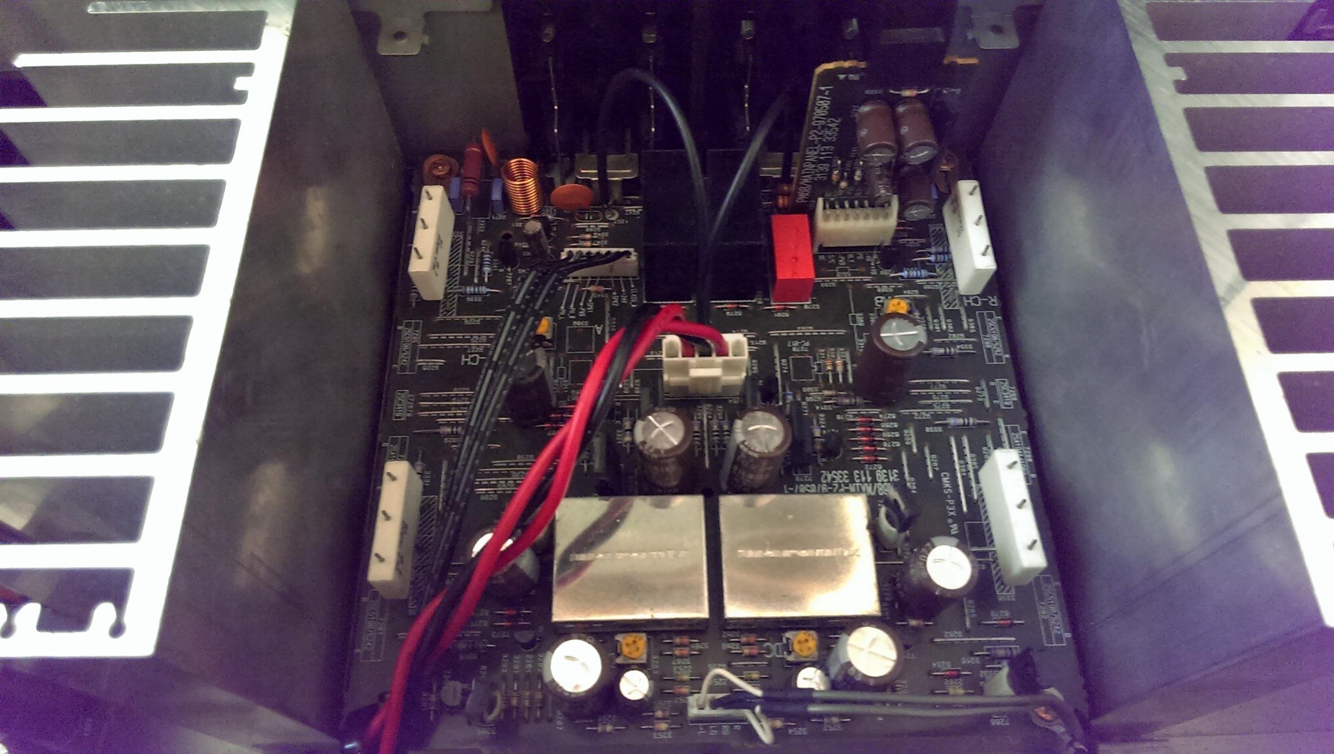

Main Amp Board: A pair of 47uF in signal path on output replaced again with same capacitance Mundorf MCap Evoi Oil 350V. Every other capacitor replaced with elna silmic2 same values.
After all that work the amplifier either: powers up normally but nothing is heard unless i fully turn up the volume and place my ear next to the speaker OR it doesn't power up and just a little buzz is heard for 1sec somewhere in the power circuit, at the back near the small transformer.
Any thoughts before i give it to a specialist?
P.S. I red somewhere that the capacitors on the little board that i circled in red in my last pic, often need to be replaced because after a few years they fail and the amplifier refuses to turn on. Don't know if this is related here.

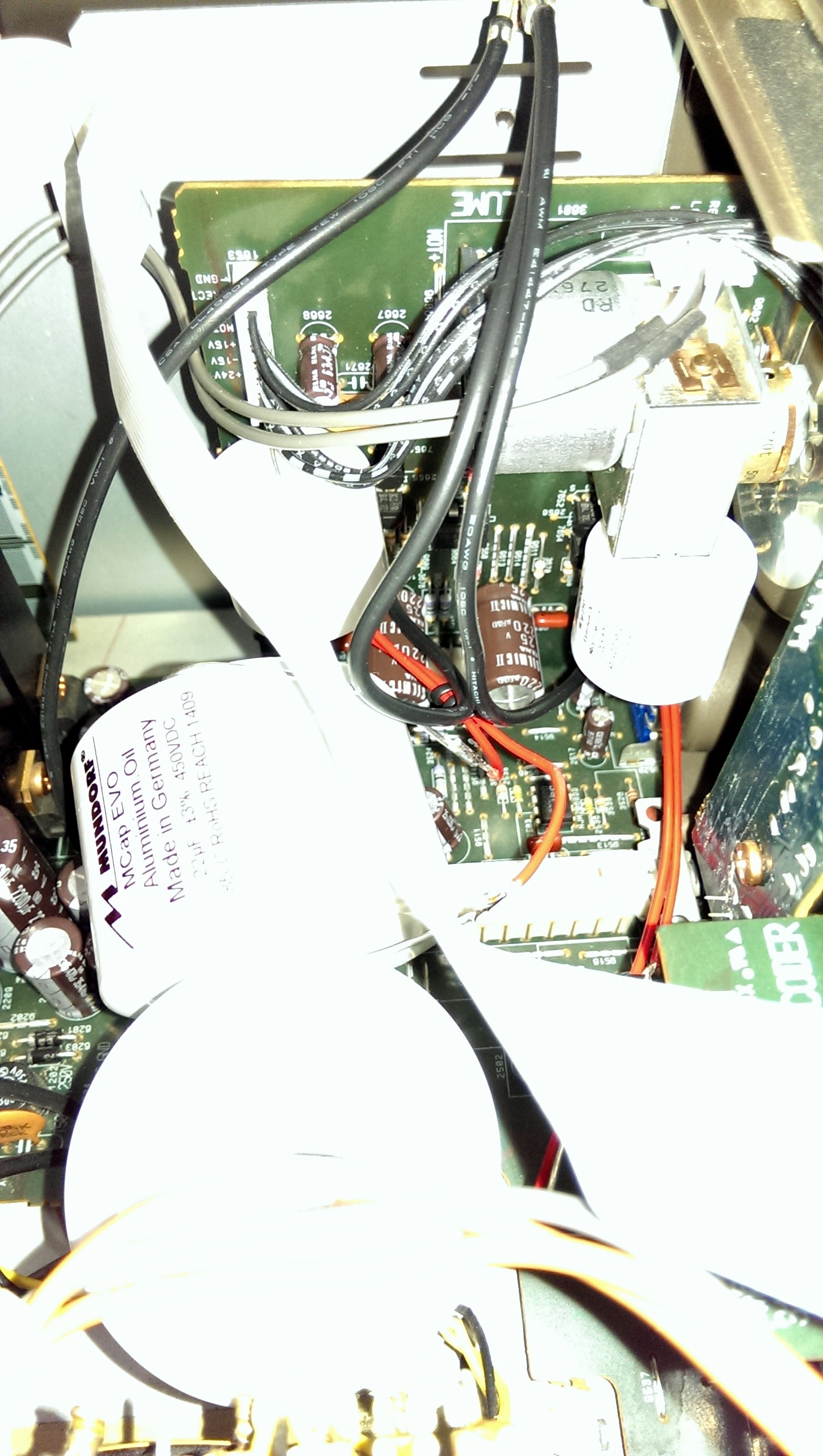

This ugly hack job beautifully illustrates why mechanics should be taken into account when performing mods. I would not be overly surprised if those big honkin' Mundorf caps on the amplifier board with their loooooong leads were the problem. Ever heard of parasitic inductance? Even if that is not the problem, leads and cap cover a major part of the circuit, and I wouldn't be overly surprised if that resulted in unwanted capacitive coupling and hence oscillation. (Either that, or you provoked some previously dodgy solder joints, or messed up somewhere else like at the opamp or forgot plugging some cable back in or whatnot. Some workshops will not even work on devices that have previously been tinkered with, as fault-finding can be lengthy and tedious.) It looks ridiculous to boot.
I have no idea what people always want with those boutique Mundorf caps. A 47µ/350V like that might belong in a speaker crossover, but not in an amplifier. I'm not sure what this cap does, but if it's the input coupling cap, with that kind of value it was generously oversized to begin with, and a nice low-leakage type would have made a good replacement while not covering half the board.
BTW, OP275 is rather a downgrade from NJM2114.

Those 47uf on output are bias stability capacitors and those Mundorf are way to much for that purpose.Main Amp Board: A pair of 47uF in signal path on output replaced again with same capacitance Mundorf MCap Evoi Oil 350V. Every other capacitor replaced with elna silmic2 same values.
Replace all of big Mundorfs in signal path with Elna silmic 2 and Elnas in power supply whit panasonic fc or similar good type of capacitors for power line.
Yes, i thought of that too. I will replace all Mundorfs with Elnas as it was before and leave diode bridge and opamp as it is for the time being. Already removed the Mundorfs and are up for sale if anyone is interested. New with receipt of purchase etc.

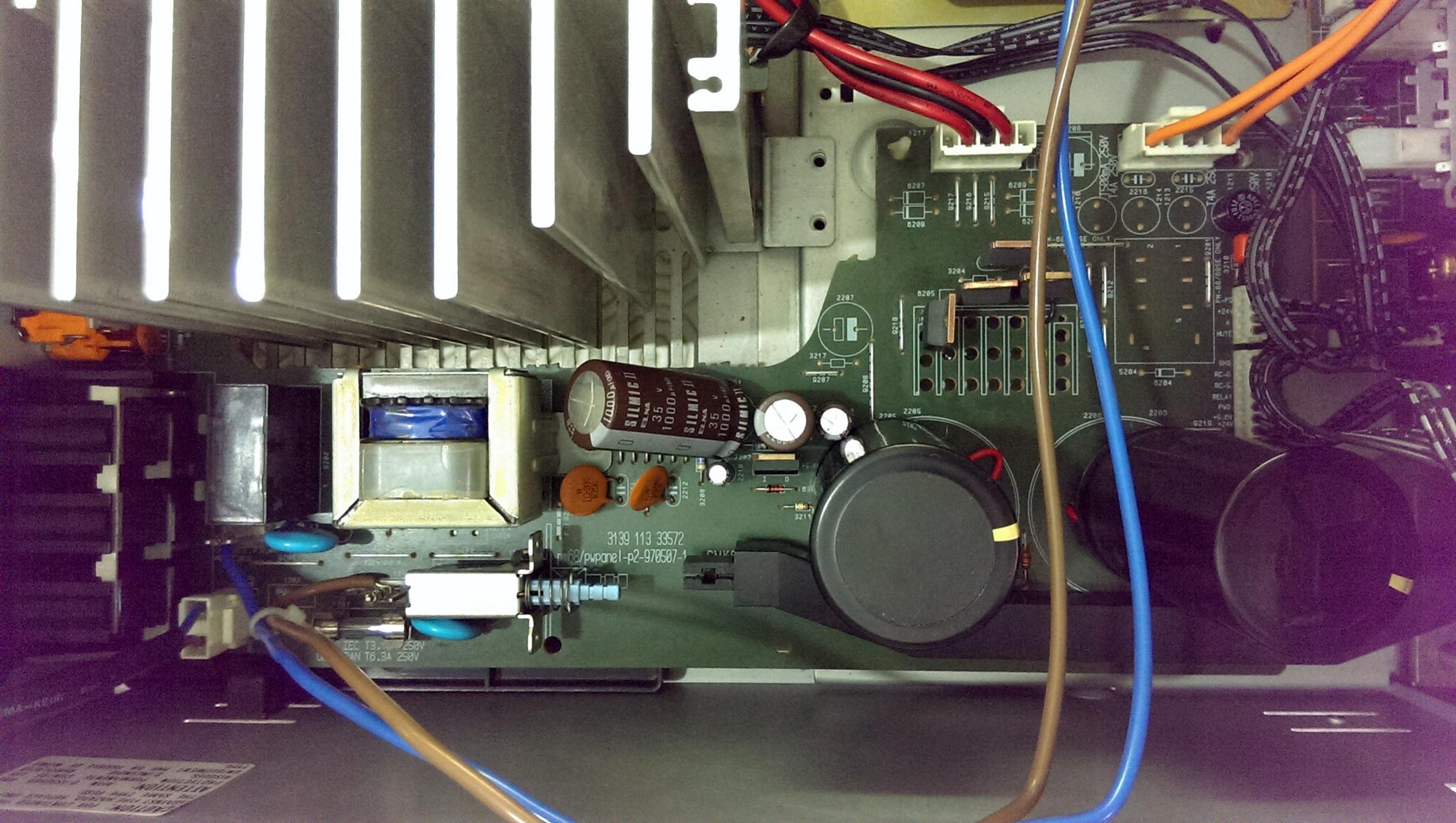

Some things that i have sorted out. First of all i found that the power switch was moving a bit so i re-soldered the connections. This explains why sometimes it turned on and others it didn't.

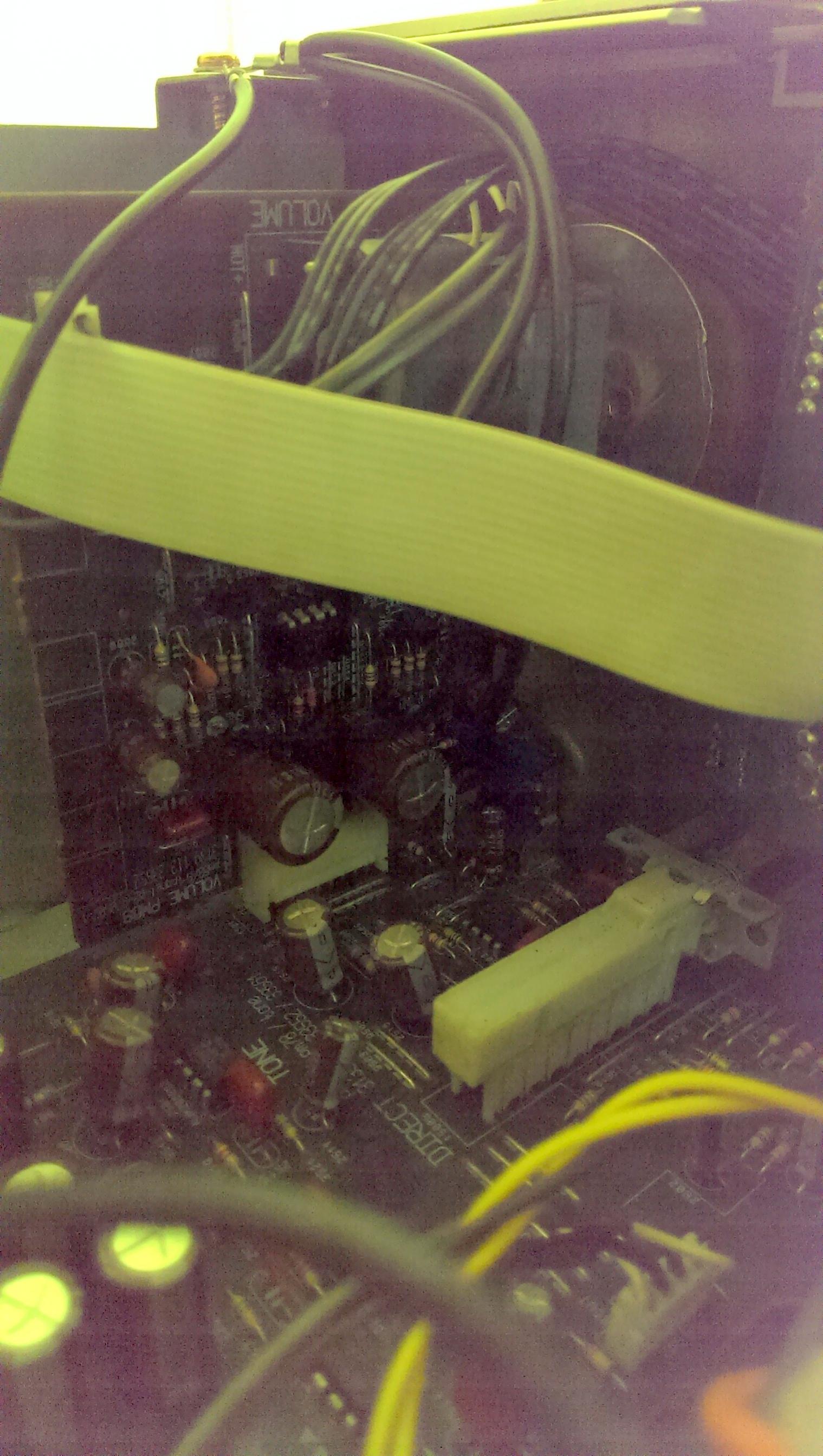

Then i noticed that the flat cable that connects the inputs board with the front panel was connected the other way round. I had already removed the Mundorfs so i'll never know if it played or not but i'm pretty sure this explains why i didn't hear anything from the speakers unless i turned up the volume all the way up.
Anyway, all Mundorfs are already replaced with Silmics II and my only concern know is the power board main filter caps. Originally it had two 12000uF/63V ELNA's For Audio which are not produced anymore. There are some on e-bay but i'm pretty sure they are fake as they are not listed in Elna's product catalogue.
Options for this capacitance are very limited and probably not worthy. I am considering Nichicon KG either 10000uF or 15000uF. 15000 would be the safer choice but then again i wouldn't like to spend much since i already messed up buying the Evo Oils. Considering this thing drives 8Ohm speakers in its rated 95W output power, would it be too risky to fit the 10000uF caps?
example of how NOT to upgrade an amp.
Exactly! this is again an example of how many amps are waisted in the upgrade process. I had quite some amps here that I had to restore from a bad upgrade. Very expensive Luxmans, Sony's with huge caps as "upgrade" the amp was OF COURSE oscilating badly: again no knowledge problems!

Alright, lesson learned. Enough of the criticism.
Everything is back in it's original state now. Any suggestions regarding what i asked?

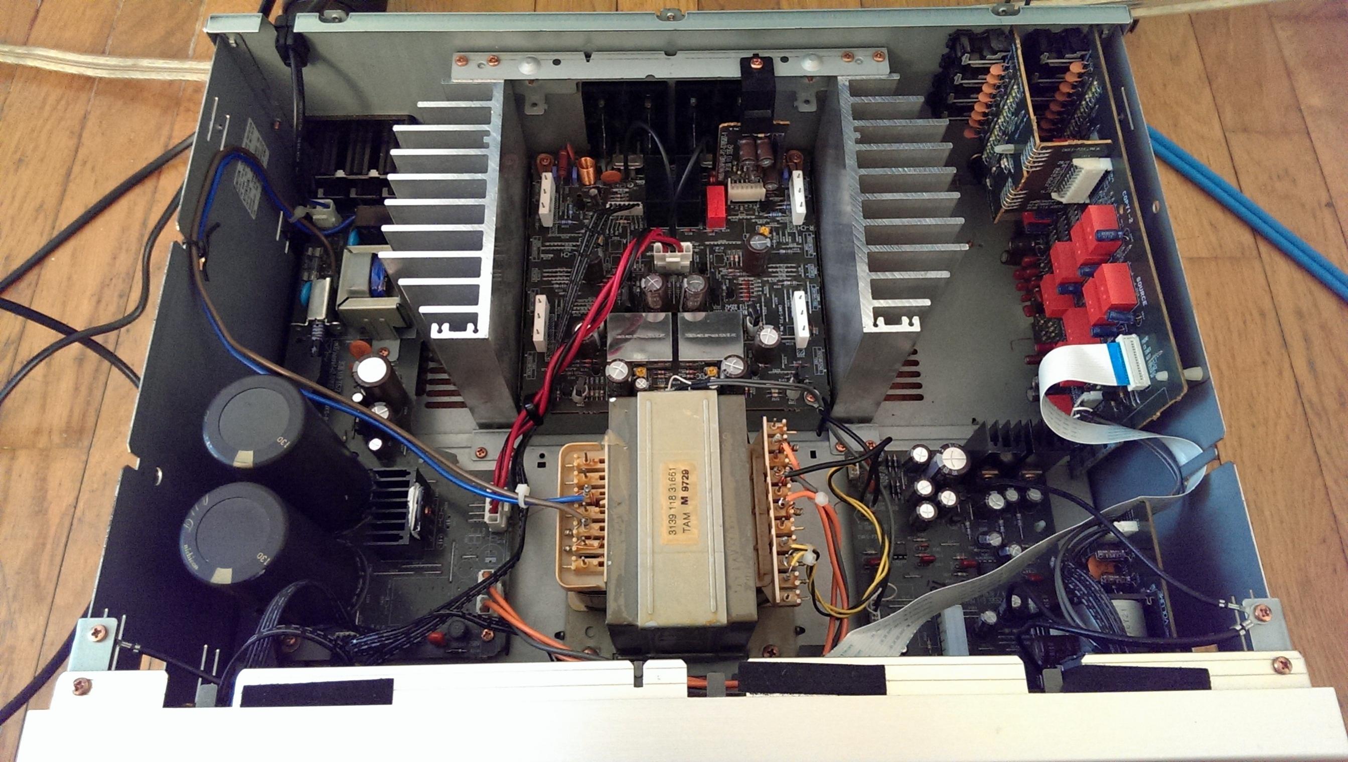

PM68 Restored
Ugly hack job now gone.
I really liked its original sound so i tried to preserve its character by using mostly ELNA. Of course, any improvements are welcome.
Starting from the power board: Original filter caps ELNA For Audio 12000uF 63V replaced with Nichicon KG Gold Tune 15000uF 63V. Bridge rectifier 6A 200V GBU6D replaced with 8A 400V GBU8G just to give it some air. Rest of lytics (group of 4) replaced with SILMIC II (same values).
Main Board & Speaker protection board: Every cap replaced with SILMIC II (same values).
Volume Board. Cerafines and ELNAS all replaced by SILMIC II (same values). 8pin DIP socket installed and fitted a new NJM2114D.
