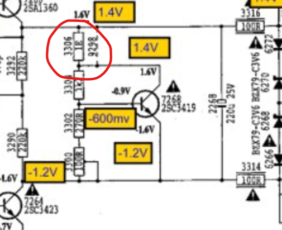

Its always compromise. The bias generator transistor and R3306 (which is blurry but looks like 1 ohm) and which modifies the temp vs voltage characteristic of the generator is very difficult to get exactly right. If the output transistors pass a current peak (with the music) they heat up quickly (the die in the transistor) but the vbe multiplier just gets to see an average temperature of the heatsink. In other words it can not track exactly what is going on. If the bias goes down as it heats up then the vbe multiplier is over compensating but in practice it is not an issue at all.
The best you can do is set the bias when its all uniformly warm/hot and forget it.
The circuit shows 'something' in parallel with that 1 ohm. Perhaps a wire link in some versions.

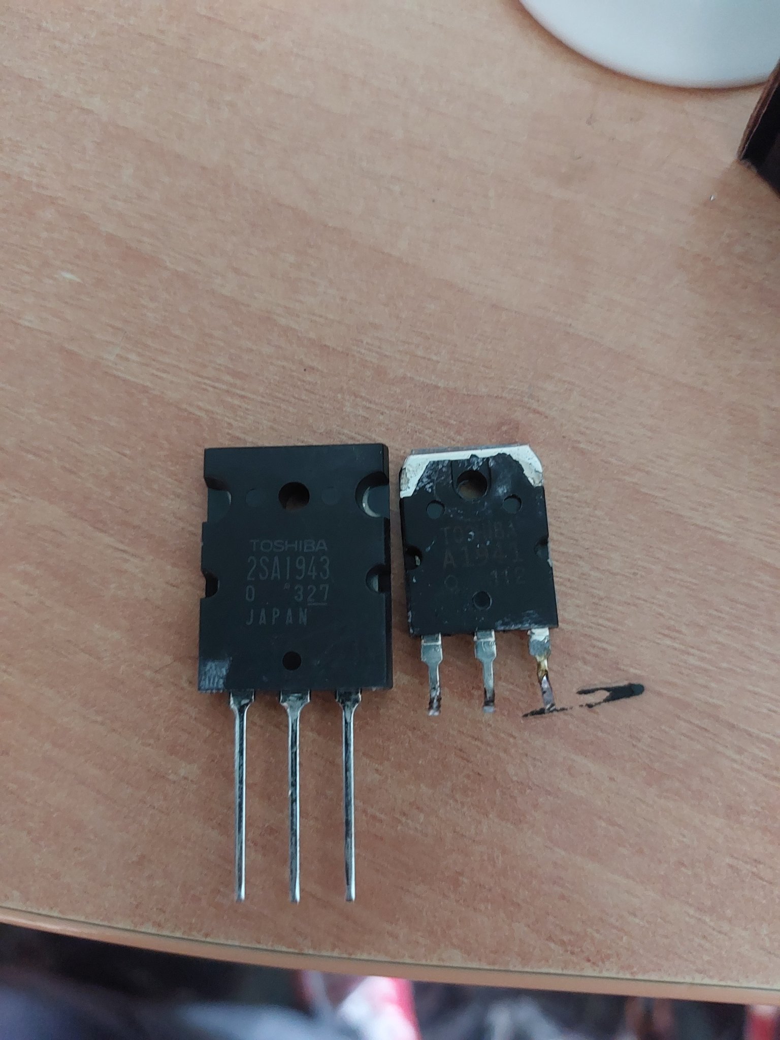

I've shelved the amp until the transistors from mouser arrived. They are here!!! I will replace the ones it currently has with the ones from mouser just to make sure.

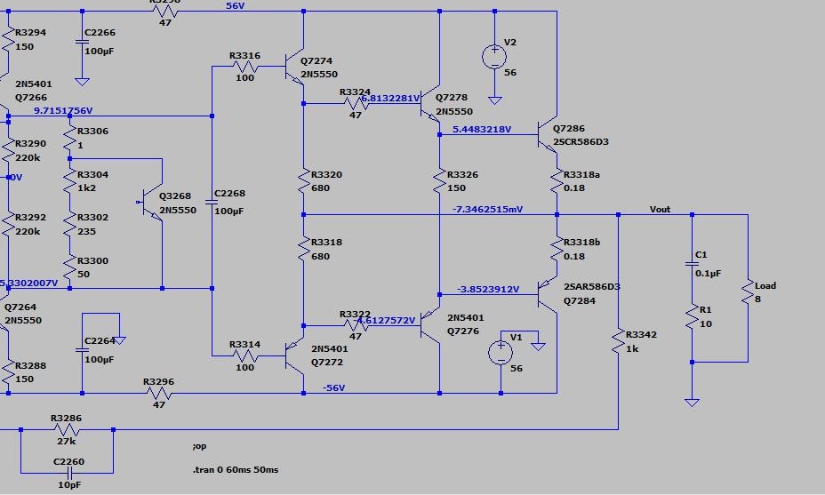

I have a question / remark about the design on the amplifier. On Mooly's simulation on LTspice after running a few experiments i realized that if the bias transistor goes open either through a cold joint on the board or the transistor fails the bias skyrockets from a few milivolts to about 5 volts. here is an image showing that (let's assume the base goes open circuit):
I noticed when i first got the amp that it had a lot of cold solder joints. I'm thinking maybe i missed some and that caused the bias to skyrocket intemmintently and maybe that was the original cause that fried the outputs.
Of course in mooly's simulation there are some components missing compared to the actual design of the amplifier.
What do you think about this theory? Could that be a valid reason of the repeated failures? A cold solder joint on that transistor?

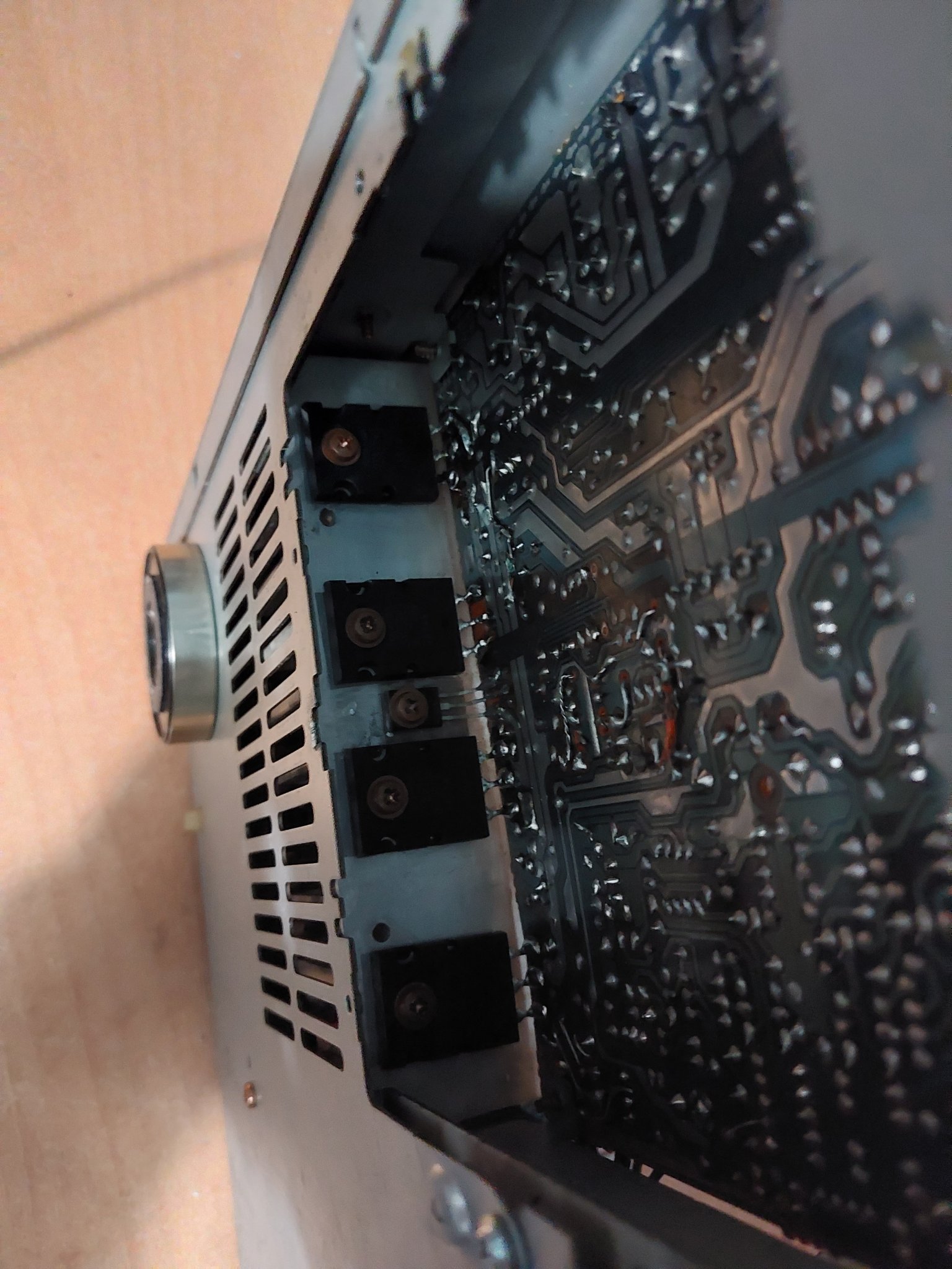

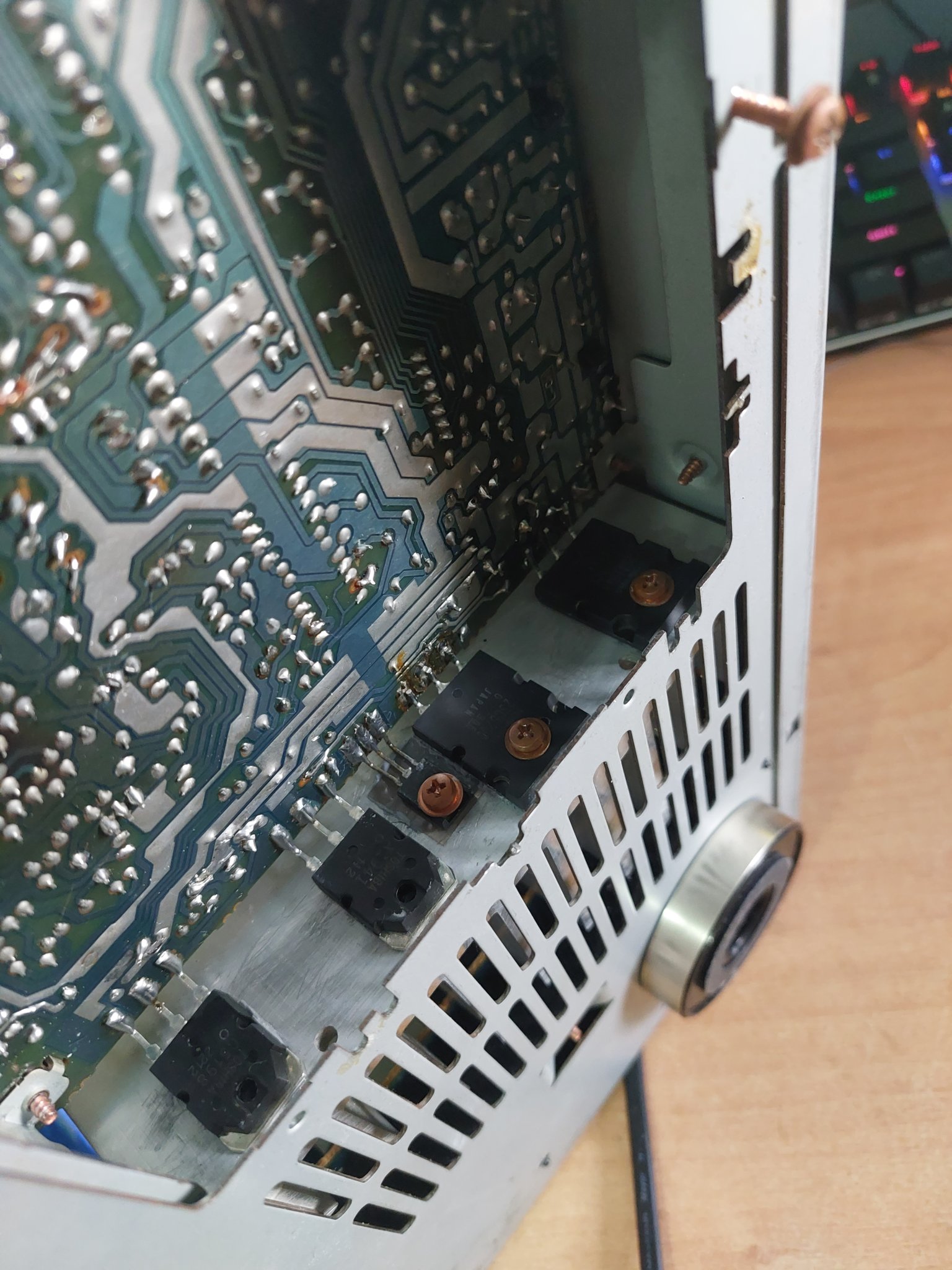

I installed the new transistors from mouser 2sc5200 & 2sa1943. I was able ro get the bias stable at 20mv after letting it warm up for 45 minutes. Here are some pictures:
I have it playing for about 20 minutes and everything seems to be ok! I hope i'm done with this and the repair was successful.
Thank you all for taking the time and sharing your knowledge!!

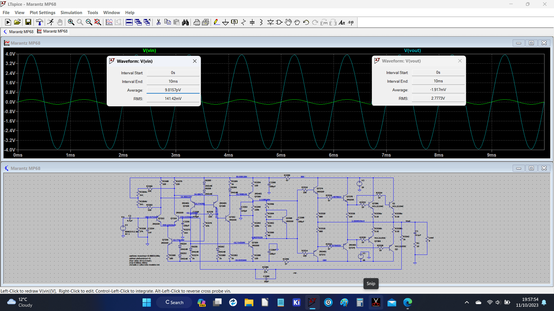

The first test would be to look at the input to each amp and see if they are the same or not.

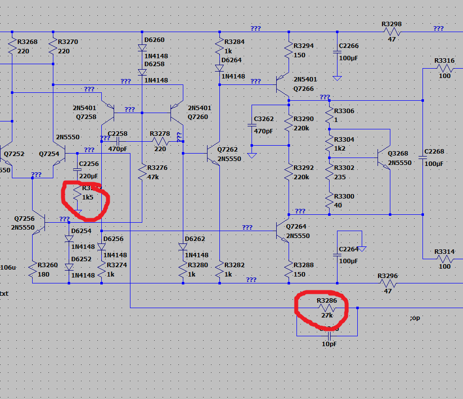

1. Ok i can quickly check that by removing the rca bridge in the back. I'm lucky because this amp has the option to run it through an external preamp.
2. The feedback resistors have been replaced. they are both new 27k resistors and if i'm not mistaken there are two 1k resistors as well on each channel.

Vin is 0.141 and Vout is 2.777. The gains is Vout/Vin which is 19.70
The feedback ratio is (27k + 1k)/1k5 + 1 which is 19.666
There are rounding errors in the calculation but you can see how the theory works. No changes to other parts including the transistors will affect the gain. Neither will the bias.

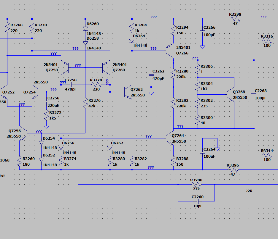

Checked the feedback resistors and everything is the same on both channels. So i bypassed the preamp and fed signal straight to the amp. Same result.
But after feeding a 500hz signal and performing a signal trace on every stage with my oscillisope i found that the signal levels are almost the same up to one end of the relays. Meaning it reaches the one end of the relay perfectly. When the relay's are on though the output from them varies a lot. whic htells me that there has propably been sparks inside causing them to develop resistance (i guess).
The problem is on both sides. out of 4 channels:
  • On speaker a : left has NO OUTPUT at all // right is low and sometimes cutting out
  • On speaker b: both have output but with volume difference
