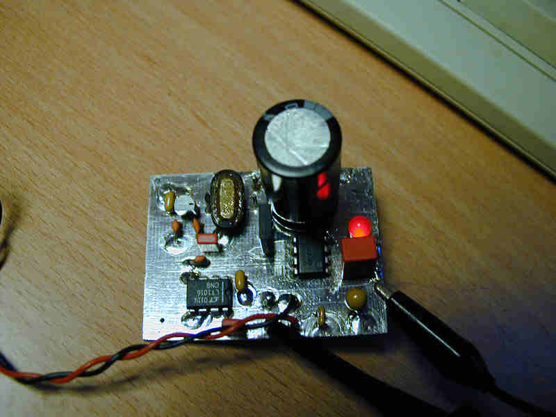

It's been a little while, but I have built one of Elso's clocks and have it mounted in a CD63 KIS.
I had chosen to add a discrete, low noise regulator to the design, since PSU noise will contribute to the phase noise / jitter in the oscillator, and jitter in the buffer stage.
The same low noise reg was used to feed the inverter stage and the analogue PSU feeds of the DAC. This reg was fed from the raw 11.5 digital supply, that feeds the 5V internal regulator.

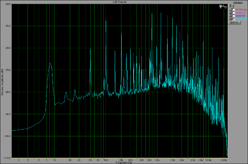

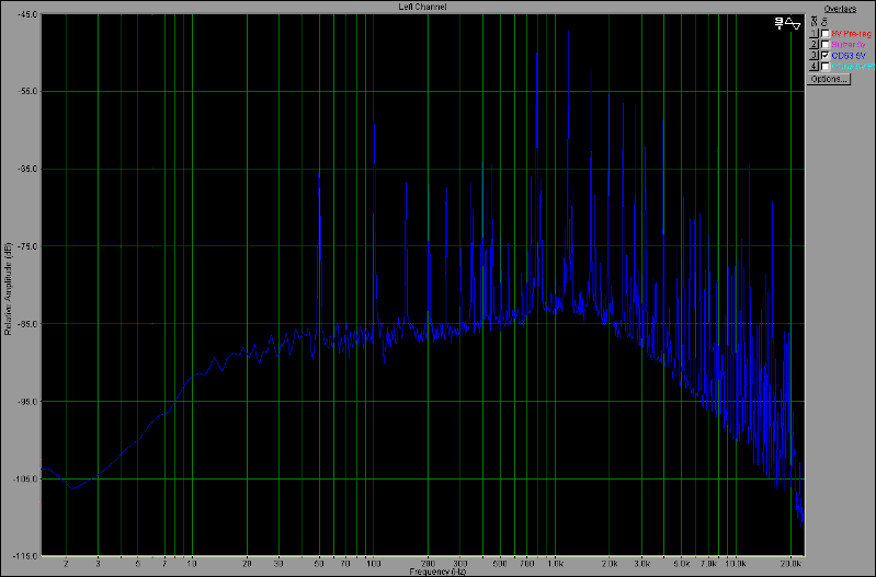

What I hadn't realised is just how horrendously noisy the internal supplies are. At idle there's a load of HF hash, along with some insidious LF stuff, at very high level, that occurs when play is pressed (presumably servo / motor currents).

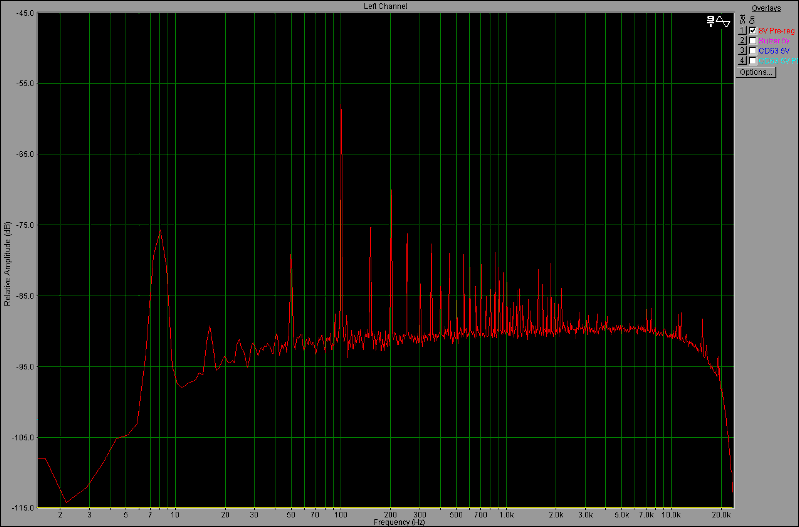

The discrete reg., despite offering dramatically better performance and noise rejection than a 3-terminal device, was still allowing too much noise through.

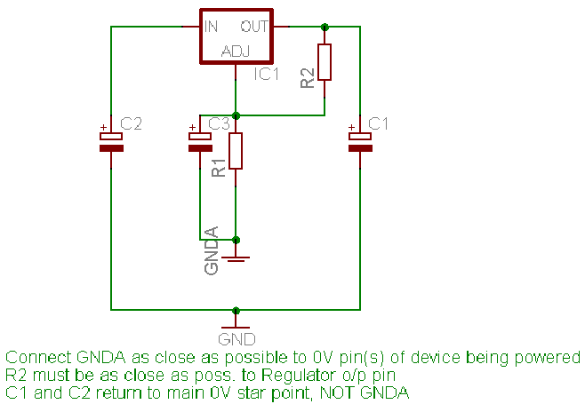

The solution was to add an LM317 pre-reg. producing 8V to feed the discrete 5V reg. Using high divider resistor values, and a large adj. terminal bypass it was possible to attenuate the LF noise significantly, to the point where it's no longer visible at the discrete reg. o/p.
I have some plots of PSU noise I'll post later - it's truly horrendous, and it's one of the reasons for the performance of the player in standard form.
The player now sounds fantastic, bass is much tighter and characterful, rythm and timing is better portrayed. and treble is more detailed. There is a measurable effect on distortion of these mods, reducing by 0.003% according to my analyser. This may not be significant in itself, but shows that the effects on the digital parts affect the analogue domain.
Mid range is still not quite as good as I'd like, and I suspect the analogue internal 12V supplies are probably very noise too, and probably the reason.
I shall be doing a side-by-side audition tonight, but in my system I believe Elso's clock (with quiet PSU) is every bit the equal of the LC Audio XO. The lower noise PSU in this player (compared to my brother's with the LCLock and 317's) may be even better.

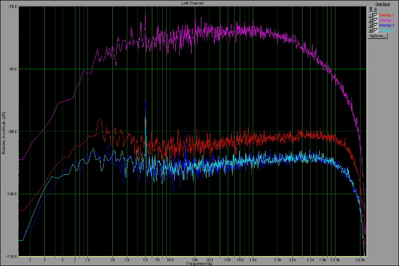

I've done a LOT of research on PSU's / regulators and noise recently (too much!).
One of the first devices I tried, in order to improve from my reference of an LM317 was the 431 shunt regualtors.
They are WAY noisier than a well implemented LM317, and have poor dynamic impedance characterstics.
Despite the recommendations of others, stay away from them -they're rubbish. I actually wonder where some people get these ideas from, it's obviously not based on actual measurements, or even sonic performance.
The noise specs in the data sheet for a 431 are usually at the min. o/p voltage, noise is amplified by loop gain - higher o/p V = higher noise.
An LT1086 is a MUCH better and quieter choice, with significantly better performance.

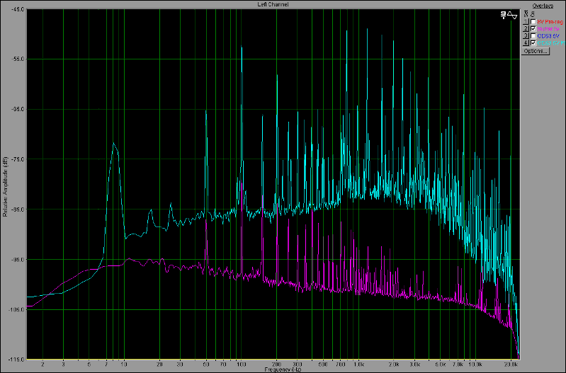

The end result
This is the clock 5V supply, vs the internal 5V, the difference is clear.
Noise is nowhere near as low as I'd like, but I'm only using a TL071 as the error amp in the discrete regulator, a lower noise amp would make a big difference.
Still, there's almost 60dB of improvement in some areas
The important thing is the sonic difference is huge, without the pre-reg, bass is boomy, and bloated, and the music is disjointed. The cleaner clock supply makes bass tighter and allows the character of the instrument to show through (i.e. how and what is being, not just a LF noise), music gels and sounds like a band playing together, and low-level detail is dramatically improved.
This player would really benefit from a good clean external PSU, feeding the internal regulators, all of that noise could be removed completely with care, I suspect the +/- 12V supplies are equally noisy, and affect the sound detrimentally.
That's one for later though.

Anyway, here's the optimal connection scheme for an LM317 / 337 / LT1086 etc.
Wire like this and you won't go far wrong, it's important too - measure the reg anywhere other than between GNDA and o/p an it will look much noisier than it should. The three terminal reg's work by maintaing their o/p relative to the Kelvin sense point - just 1mm away along a track with current flowing in it will make it look noisier - believe me, I've battled for ages before the eureka moment!
Andy.

Noise problems
There are big benefits to isolating different circuits etc. but I strongly reccomend using LM317 / 337, cost is little different to TL431, but performance is much, much better. Noise and output impedance are much lower in an adjustable 3-terminal.
See previous plot for comparison of TL431 noise vs 3-terminal reg's.
Andy.
tests on pow.supp. reg. like TL431 iam doing, because improving isolation to other stages, compared with std regs like 7805 / 317; noise is a problem...
Andy.
