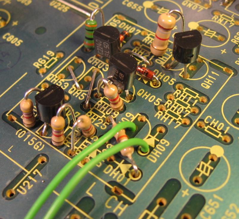

Eggzy said:I got a MARANTZ CD63se from the car boot sale last week for a tenner!
The back analogue output sockets were dented in and the machine had some scratches hence the price. Upon opening I found the PCB seemed physically ok. I salvaged an identical RCA socket assembly from an old CD player which I duly soldered into place…the result was no sound from the left socket. Visually it all seems okay so I assume that at sometime some invisible damage has been done. I hooked the player up to an amp and using a probe attached to the + of the left socket I prodded some areas of the PCB near the socket hoping for a signal, sadly not a peep on the LH channel but the RH sounds fine.
However the front headphone output works fine so using an adaptor I fed my amp from the headphone socket but it sounded too loud & distorted.
I was thinking of wiring up the 3 point (R,G,L) headphone output to the rear RCA phono sockets via a series resistor. So I would like to ask; have I overlooked something or would this be a good solution? It’s too good to throw in the bin.
Any feedback would be greatly appreciated
Cheers J
Its a simple fault mate!
If the headphones output both channels then the opamps in it are fine. The cds opamps feed the headphone opamp.
Chances are the track to the RCA socket is broken, check where you soldered it in for a break next to the pad.
Also what Simon said is correct about the resistor to take audio from to test.
Good luck
Brent

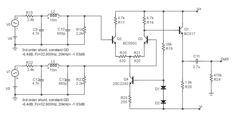

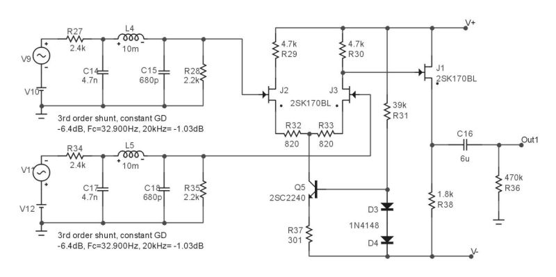

I am building a second version now, with FET's. I also tried the darlington setup, I used a BC517, works fine.
I made a new version of the schematics, with parts & placement:
Ray.

I was thinking in particular of the following :-
Replacing the output pair with a darlington transistor eg. 2N6426
Replacing the CCS pair with a CCS diode or FET
Basically to reduce the component count.
Andy
Ray.

Both of them are basically the passive filter part followed by a stage based on the Ultranalog SACD Enhancer.
I adjusted the amplification a bit, to get 2V rms output. I use the original current sink of the HDAM circuit, and it's possible to get all the components on the PCB. Here's a pic of the latest FET version:
Ray.
Ray.

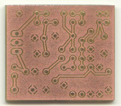

Here's the schematic & board I made. It's based on your clock, only with single supply, and Guido's XO-supply.
Ray.
Ray.

Thanks Andy! Yes, it is home-made. I used Eagle.
I also etched me some PCB's.
Why? As long as it's not commercial....
Ray.
