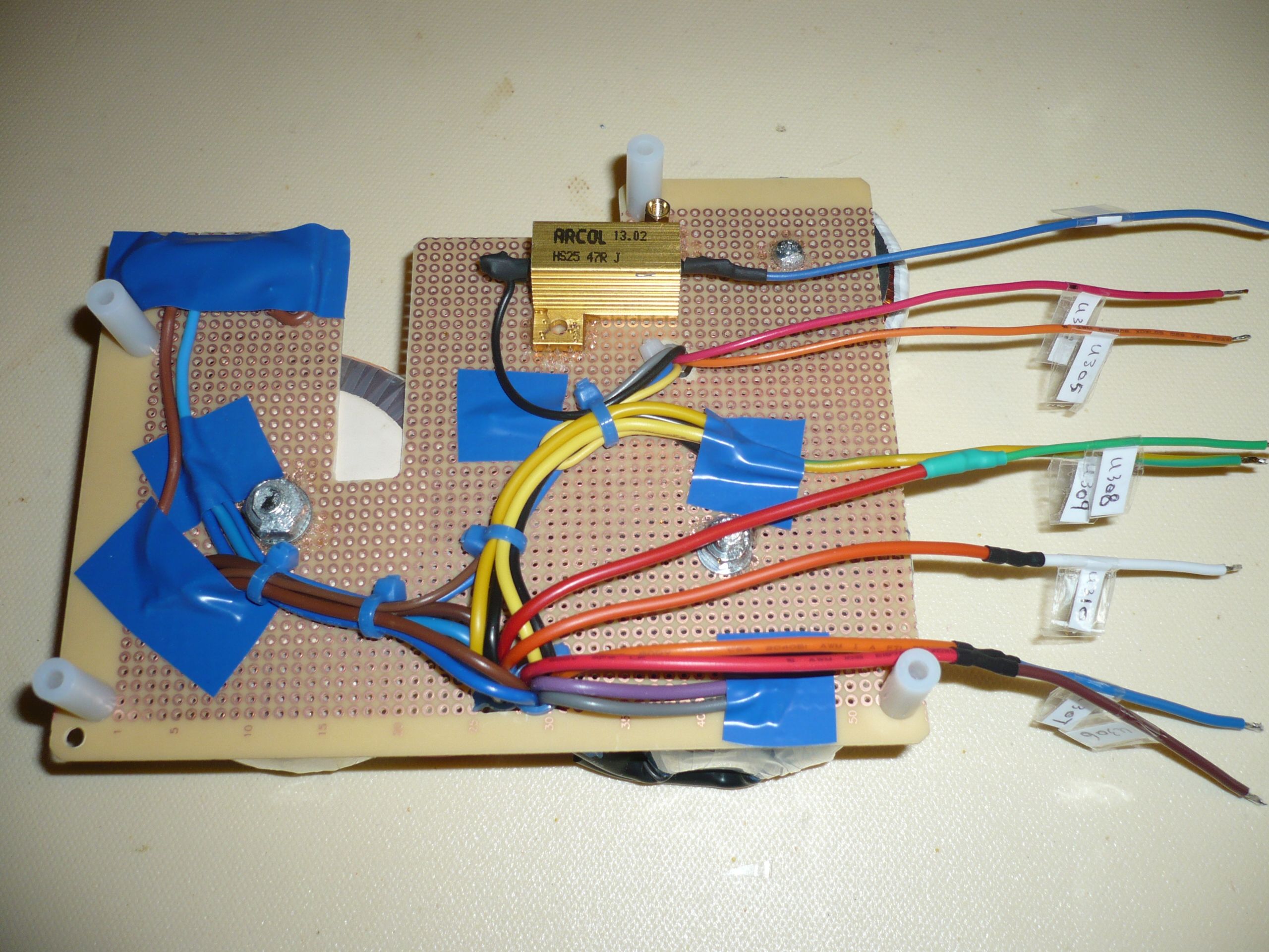

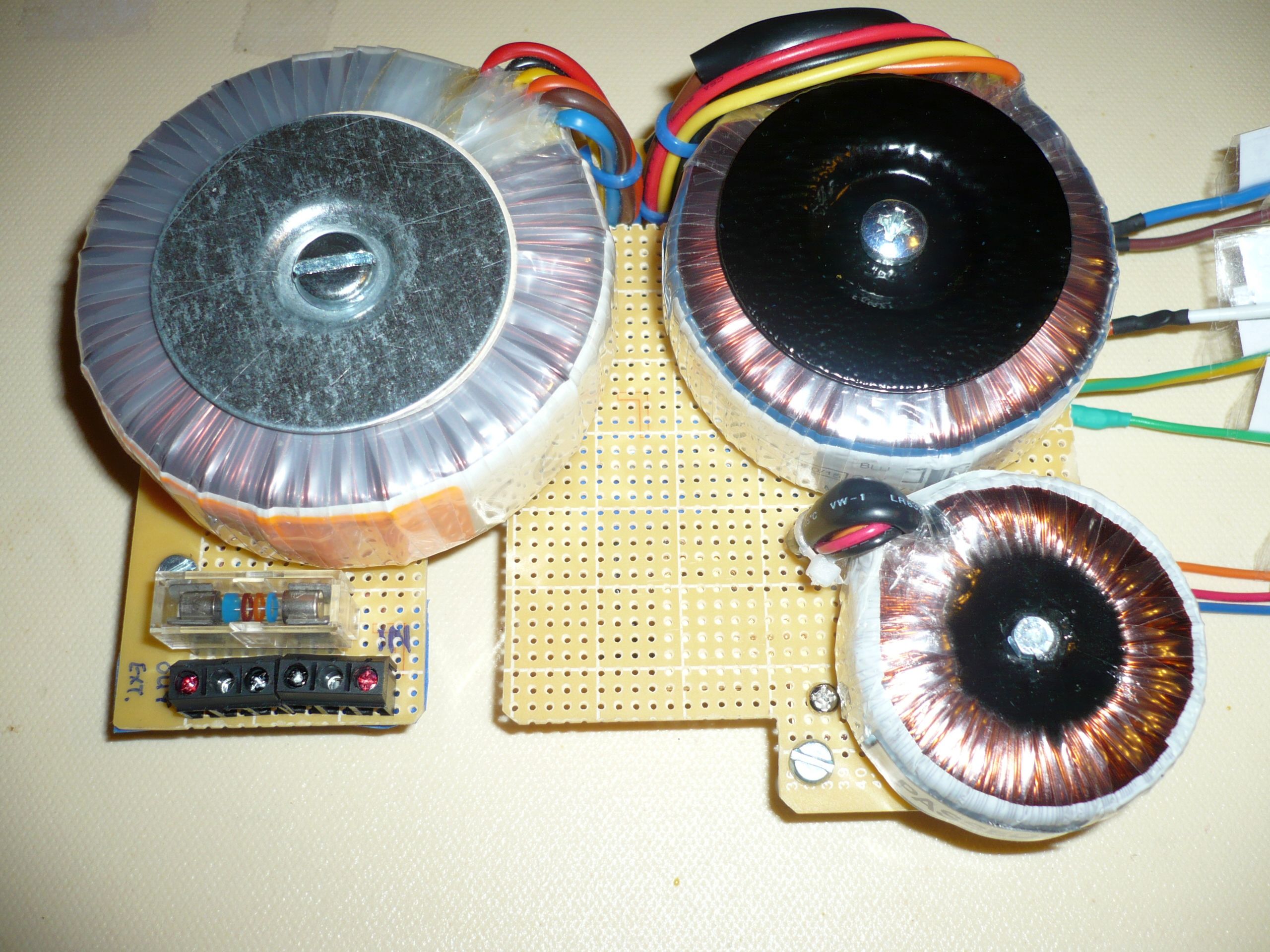

How to change CD63's TXs
The most noticeable improvement in modding a CD63 is by changing the stock TX with BIG TX to ensure a very stable voltage being supplied to the Servo and the opamps.
What I have done is using a 50VA 12Vx2 Toroidal TX for the servo; a 30VA 15VX2 Toroidal TX for the opamps (I use +/- 15V regulators instead of 12V to drive the opamps which performs better) and a 7VA 12Vx2 for the front panel display.
The circuit diagrams and its connection is shown in the diagram attached.
Two photos were taken to show how the TX unit was fitted together and is self-explanatory.
The TX unit fits perfectly at the rear of the CD drive and you can see the layout in Thread 19156 below:
http://www.diyaudio.com/forums/digital-source/54009-marantz-cd63-cd67-mods-list-1916.html
If you have a SE or KI you can still put back the bridge bar without any problem.
I have done 6 modding and this TX unit is for the 7th modding project for my friend.
Hope my experience is useful to those who would like to change the stock TX.
