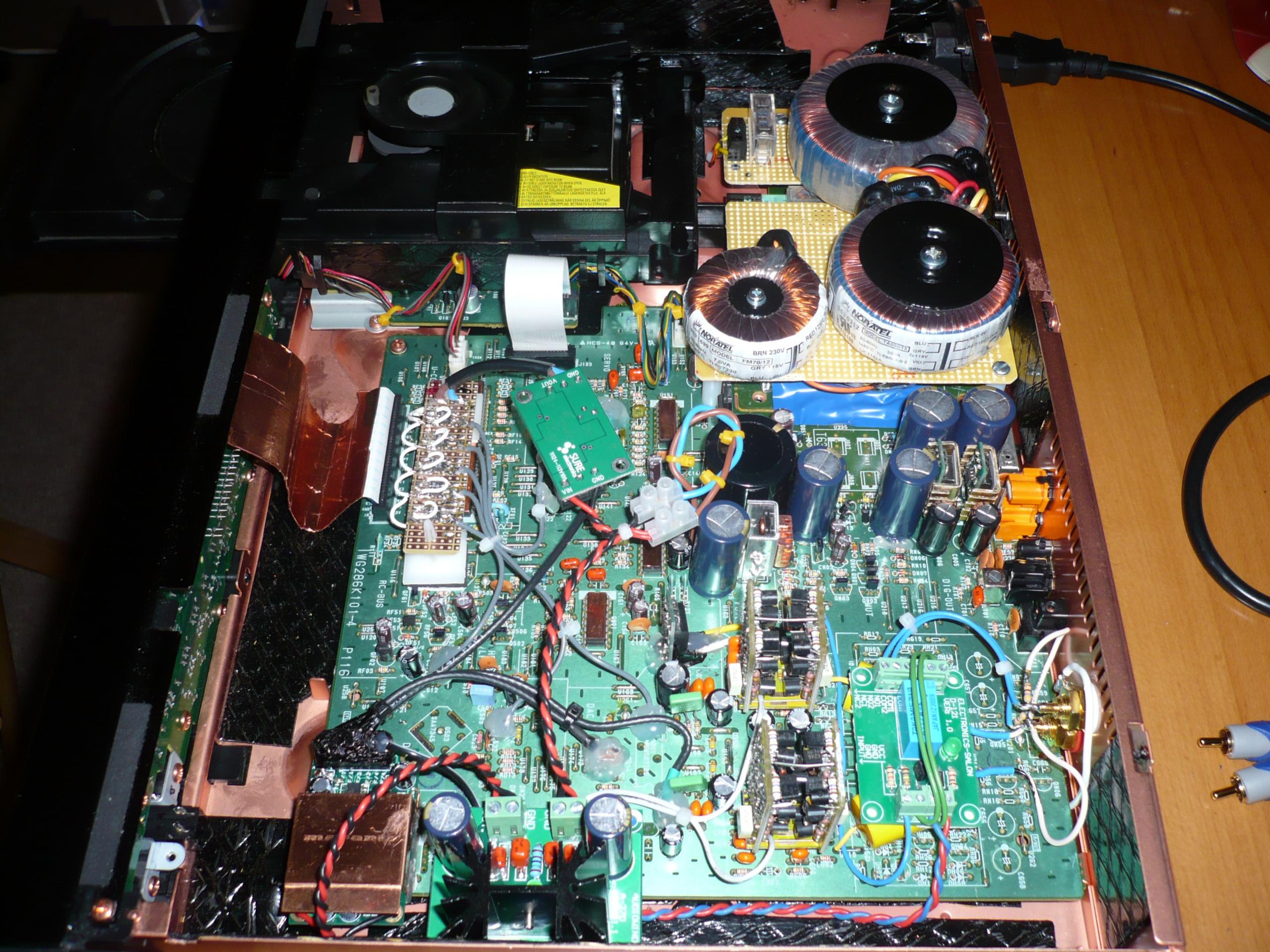

so, I've had a look today at the voltages in my machine and run some simple tests using my multimeter.
I know people like pictures, so here's a picture of some measuring happening:
No particular dig at anyone here, but I've read a huge load of this massive thread and I've seen a huge load of "improved bass", "better definition" & "brought new details to life I've never heard before" but very little actual measured or tested data. I know you can't measure everything and some kit is specialised and expensive, but some things can be looked at quite simply and without cost.
In my machine currently (standard non-SE cd63), I have a 22,000uf tsup C813 (positive 10v), and a 4700uf C814 (negative 10v) as well as basic upgrades to most of the smaller electrolytics.
I'm looking at power supply, specifically on the 10v rails too see whether I need a large 50va toroidal transformer or whether the standard one is adequate given the larger bulk capacitors on the rails as well as some additional voltage regulation further down the line. I was also basing this requirement on the fact that it has been mentioned about as much as a 4v drop at times with the standard kit.
The first thing I found was that just after pressing play, when the motor first spins up, there is almost a 2v drop for 1-2 seconds as the disc accelerates, but after that it becomes relatively stable. I don't really mind about that first second or so as there's no musical output at that point anyway.
what I measured over a couple of hours playing was:
Idling voltage on the +10v rail with the unit on, but doing nothing, was 11.58v and very stable.
during regular playing I saw:
Max
11.27v
Min
10.96v
on the +10v rail
And on the -10v rail.
Min
-11.57v
Max
-11.95v
Measured right at one of the driver ICs, taking the reading from the IC end of the ceramic cap C137 I saw min +10.63v, max +10.90v
voltages measured at the 3 parts of the dac and the display IC which I've fed using 7805 regulators fed from the 10v+ rail were all +5.00v bang on, totally stable.
What this says to me is I can stick to the standard power supply, but I should regulate the driver ICs, and 8V regulators seem like a good call there as I can guarantee more than 2.5v dropout during normal operation. A few more simple 5v regulators to other parts wouldn't hurt either as they're obviously effective.
Does that sound about right?

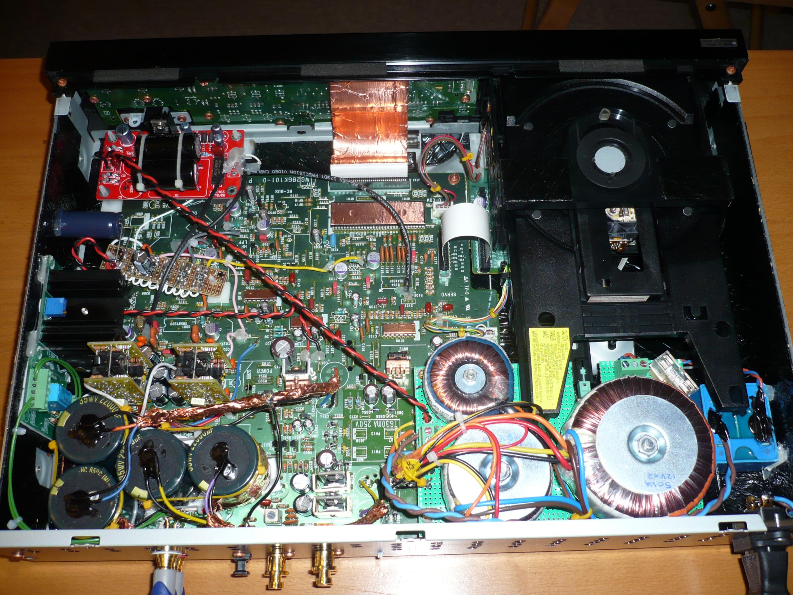

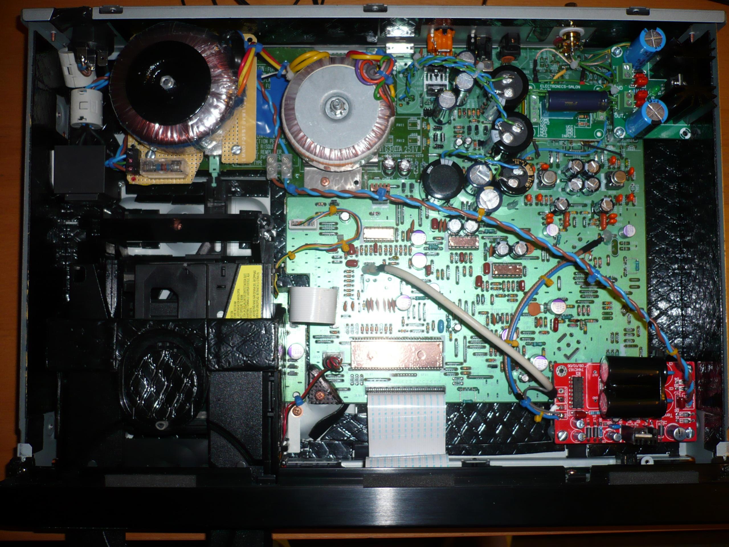

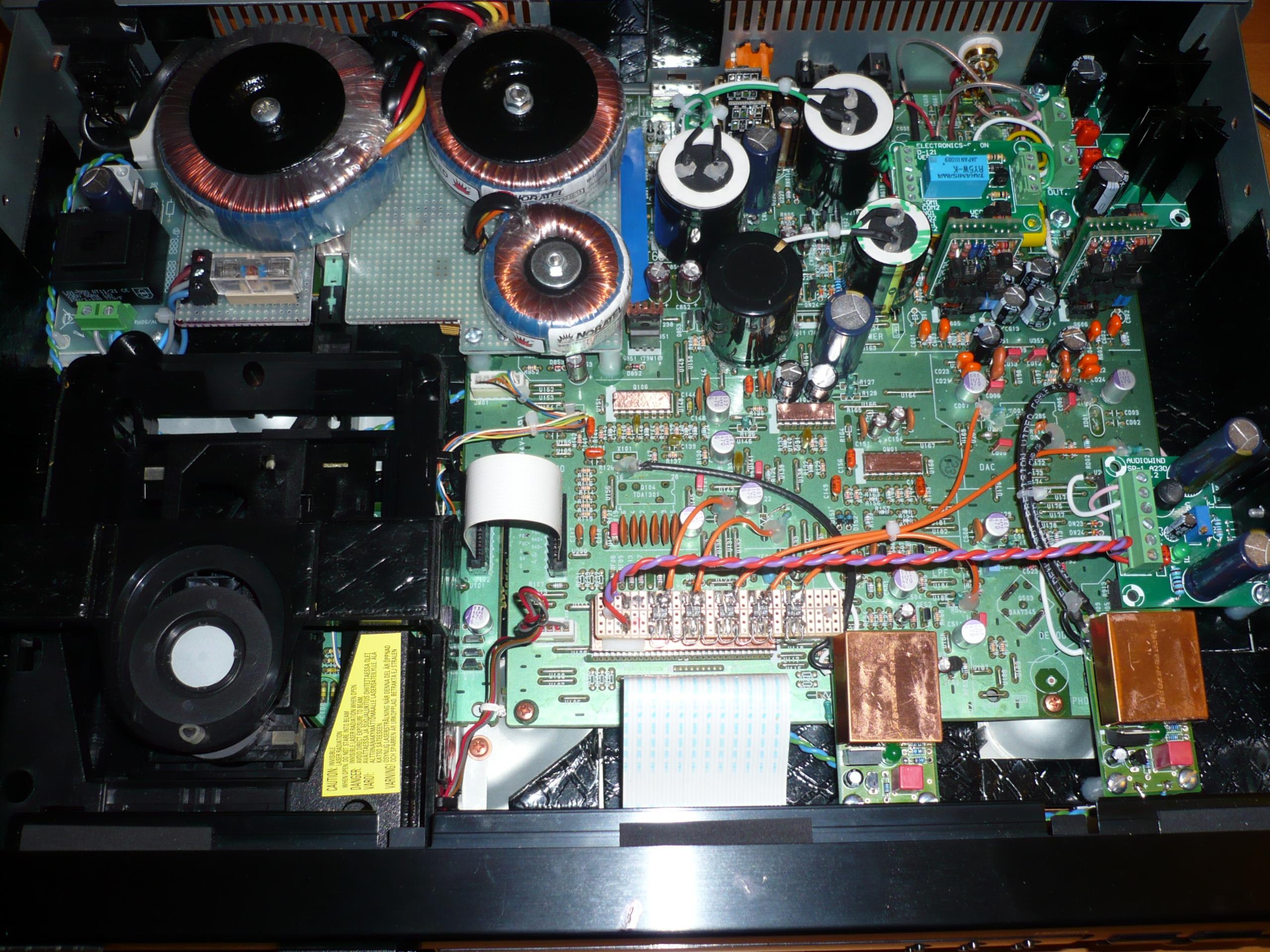

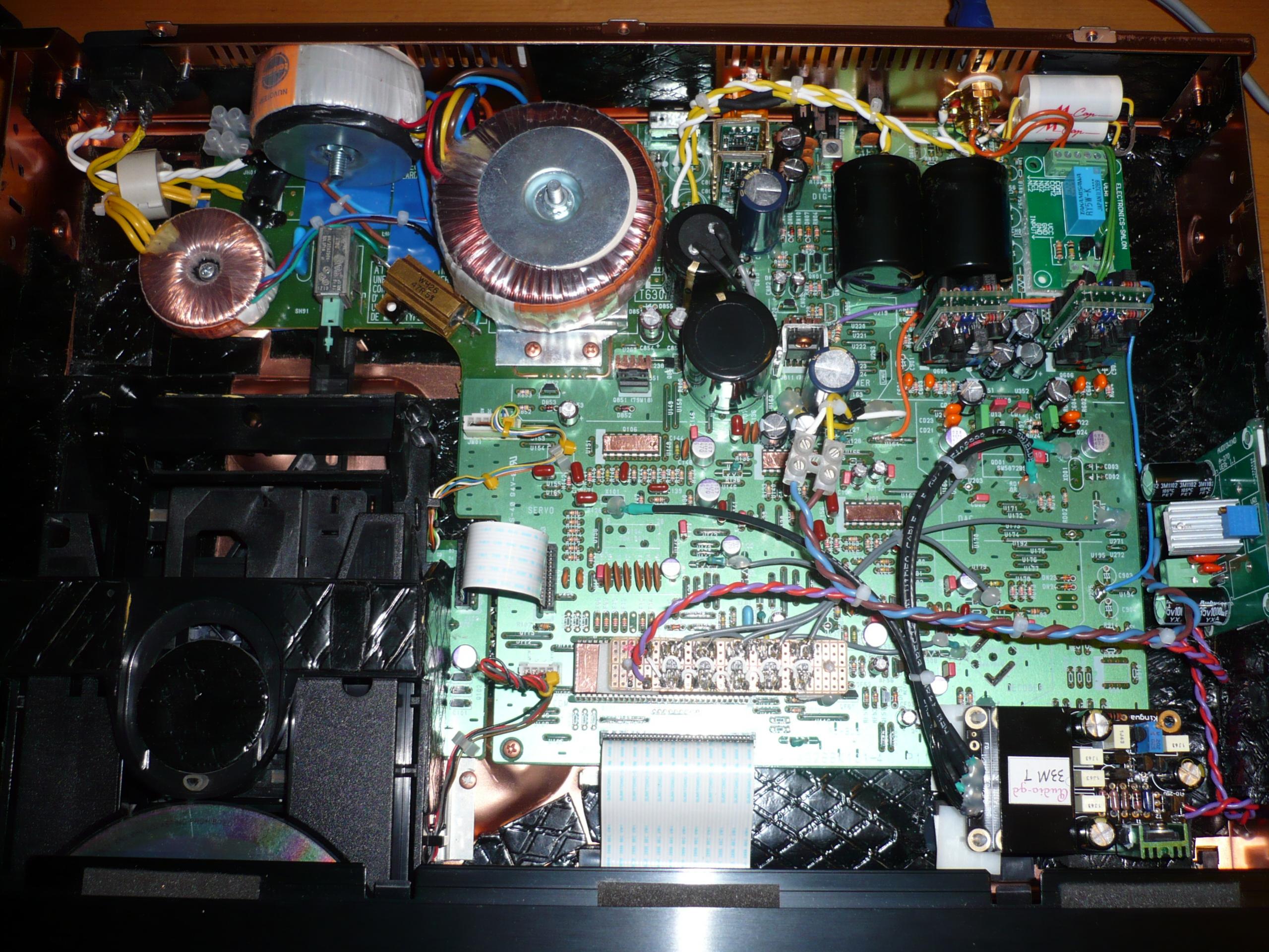

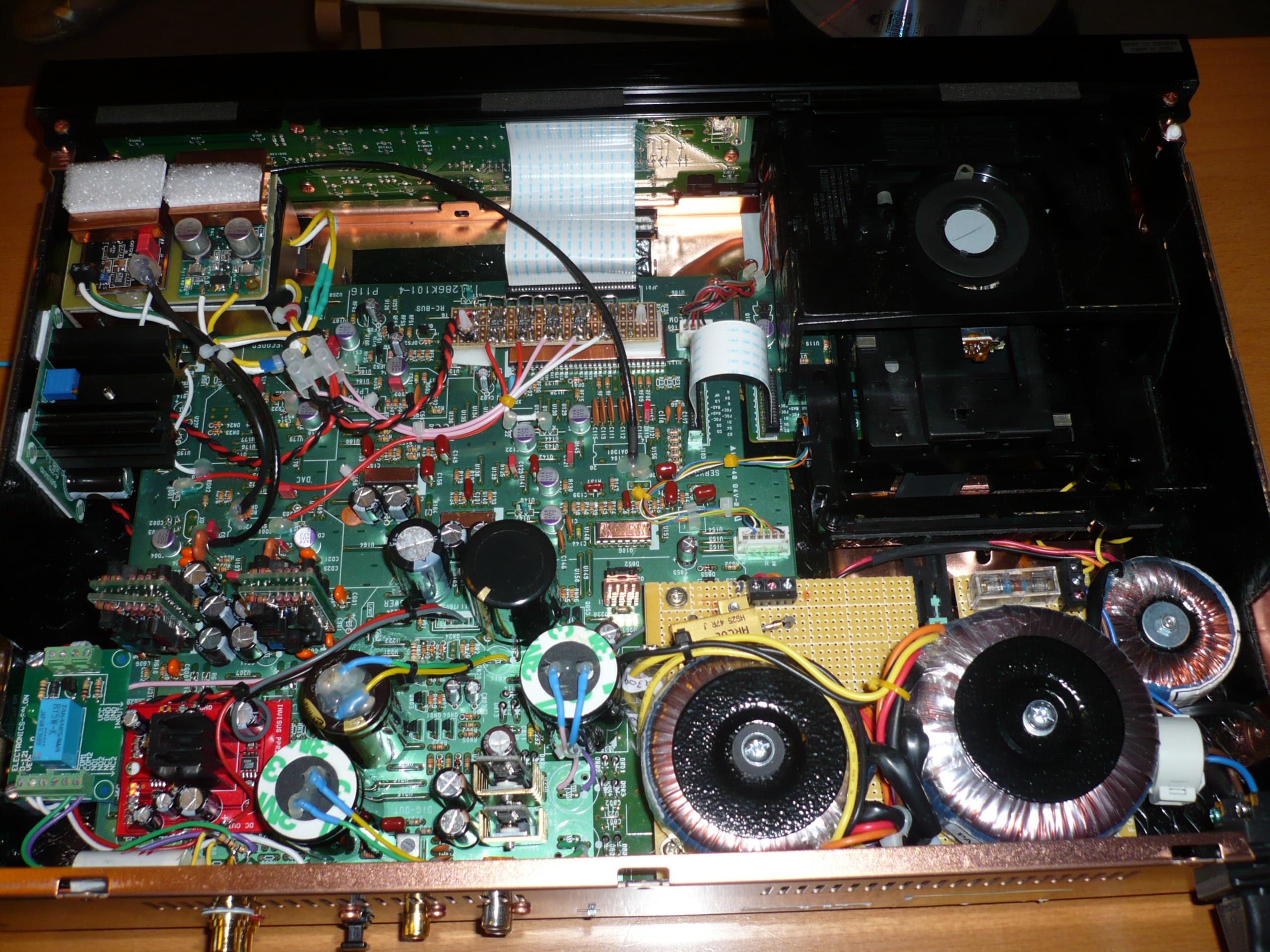

My completed works
Further to the above, I have uploaded photos of my six completed projects for your reference Please note the different clocks and opamps I used. (Remark: After checking I found out that actually I have completed modding 6 CD63 rather than 4 as mentioned above)

Hi Highlander.
Thanks for those pictures.
I'm wondering, how useful are the big caps (22000uf) you put in some of your mod ?
I guess 2 of them are C803 and C805, but which one are the others ?
What size do you think is the best suited for those caps ?
I've already changed them in my cd57 as suggested by Ray guide and I'm happy how it changed the SQ, but I've read many posts in this thread about larger ones, as you did.

BIG TX and BIG smoothing caps are highly recommended, in particular, for the servo supply. This will ensure there is no fluctuation of voltage when the CD drive is run as it draws current on starting up and during operation. I have used a scope to measure the transient voltage dip and it can go down by 4-5V in milli of a second when the stock TX is used. With a BIG TX and caps the transient dip will be less than 0.5V and with very steady supply voltage all the time to the servo circuits. What you will get at the end of the day with a BIG TX and BIG smoothing caps is very tight and extended bass.Very nice work and thank you for the response. I will read the info on the link you provided.
I also have a few other question.
What's the aim of the rca connectors swap ?
How about the iec socket ? Possibility to use a better (at least shielded) main cable ?
DAC seems always reclocked, but what other component do you often also reclock. I dont understand why a cable is going near the servo zone. (I know my cd57 has a bit different pcb, but I should get a cd53 soon too )
On the analogue rail I have changed C803 and C804 with 22000uF. And changed C805 and C806 with 1600uF.
On the digital rail I have changed C813 with 22000uF; C814 with 10000uF; and changed C815 with 6800uF.
(If you have space problem you can use 10000uF instead of 22000uF)
The purpose of Big caps is to ensure the supply voltages to the circuits are steady, in particular, if your Tx is small. Yes, don't forget to bypass the two fuses (for CD63) as they will restrict the current flow of the digital rail.
A good quality RCA socket can provide better contacts with your RCA cables.
Installing an IEC socket will enable you to change the power cables easily.
CD63 has two clocks. One for the DAC (and decoder) and the other to the servo. The cable you see near the servo is to supply 8.xxMhz clock signal to the servo circuit while the other two cables from the clock go to the DAC and the decoder. Most clock has a built in freq. splitter (divide the main freq. by half and a quarter etc). If you buy a 16 Mhz clock you may also get 8 Mhz output as well, however some clocks have only one single output and in that case you need to have two separate clocks if you want to clock the servo as well. If you look at my photos two out of my six CD63s have two clocks installed.
