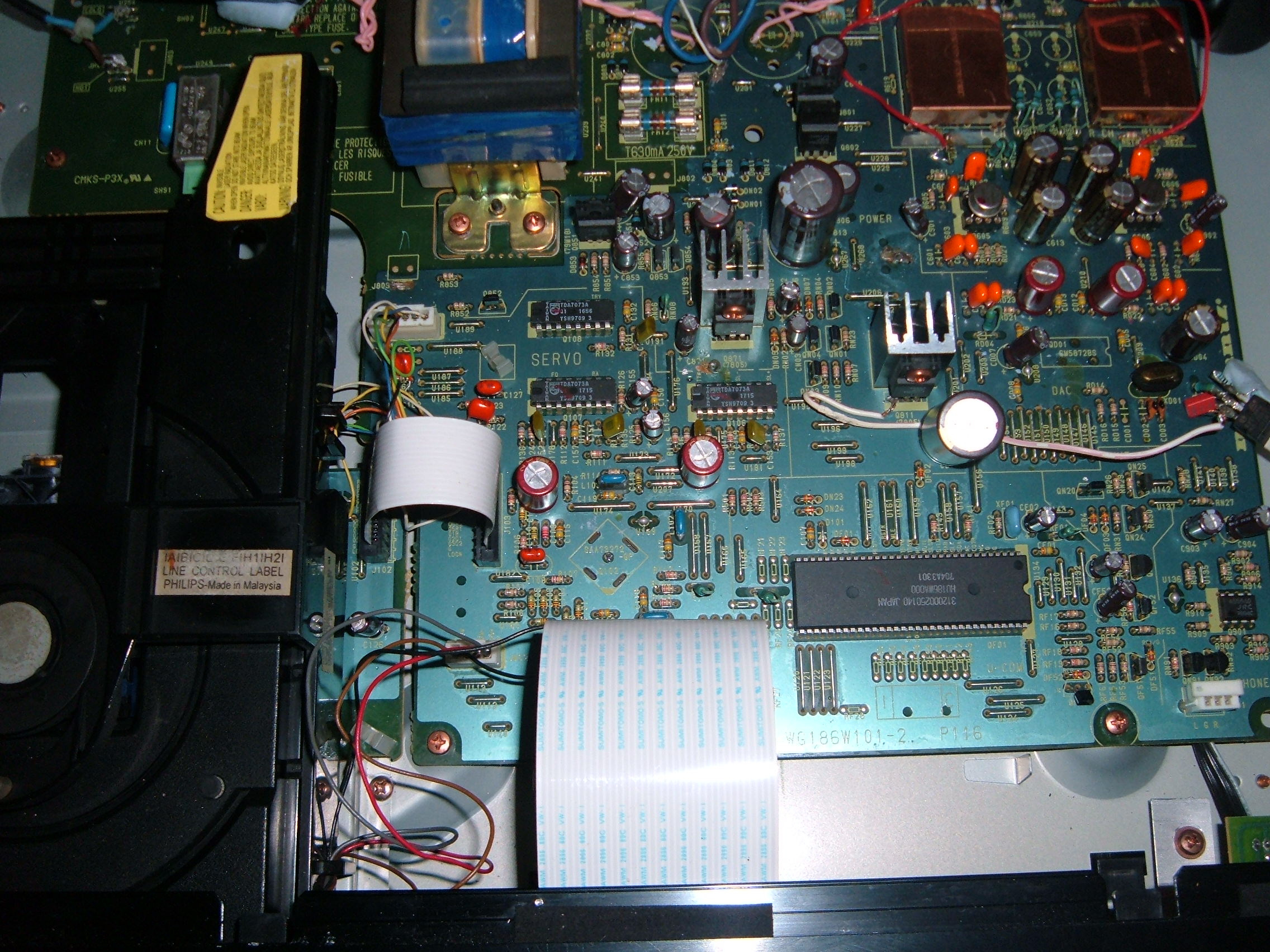

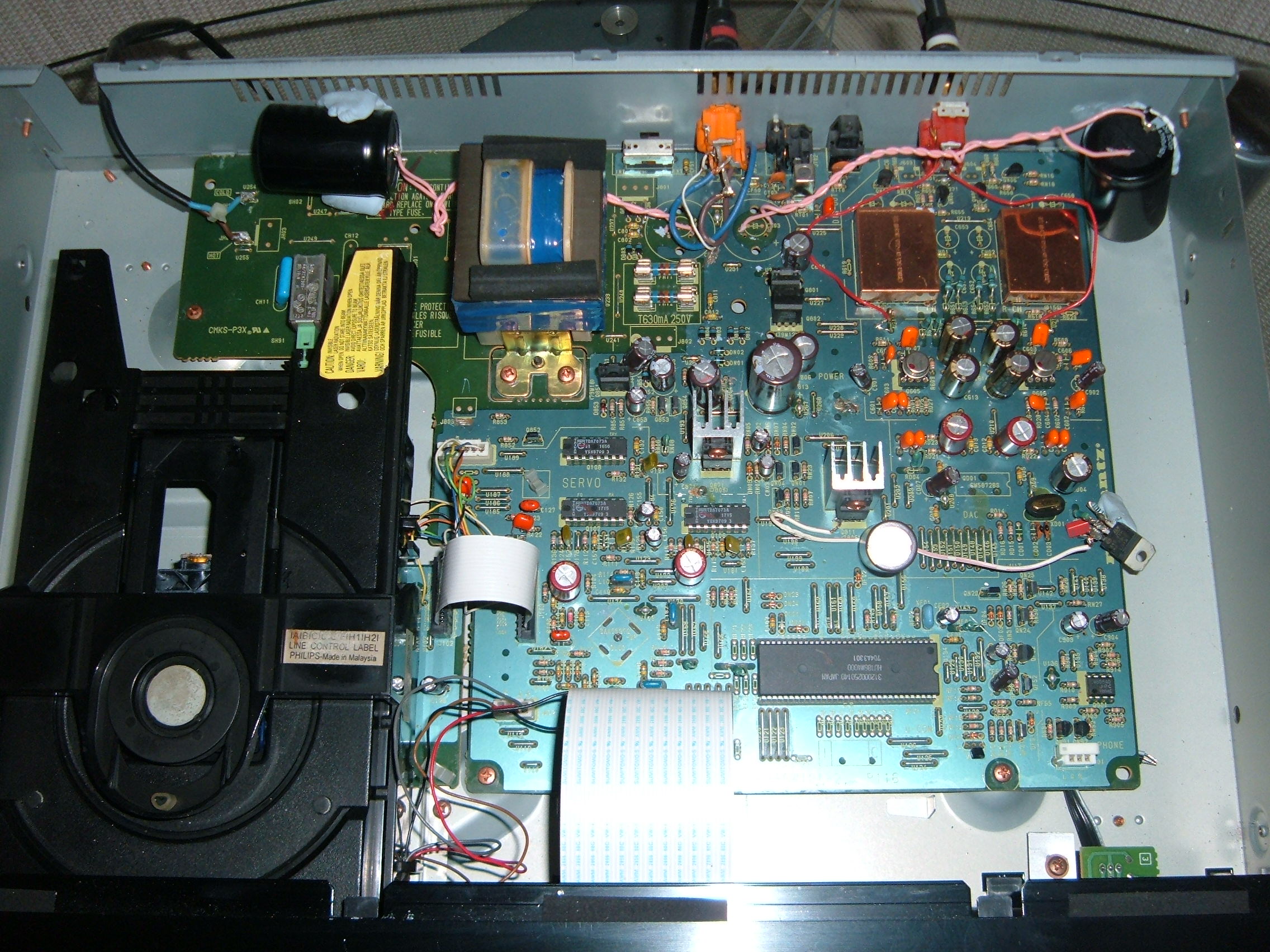

Hi all been a while since i have been on here. Im after some help with my marrantz 67se its had some mods done its had the hdam circuit by passed it as a n external power supply but not sure what it runs i repaced the opamps with the ha screened ones, But it sounds bright and harsh with not much bottom end clout. And just wondered if there was any one in sheffield who could have a look at it and make sure its been done right
Have you changed the smoothing capacitors to 10,000 - 22,000uF ?
Not sure i have done nothing only changed the opamps as electronics is not one of my strong points lol. I could post a pic of the board some regulaters have been changed and some big caps put on the voltage input but the work looks shabby to me and untidy. Just wondering if the person who did it knew what he was doing

Ok done it this is whats been done i have only upgraded the opamps rest was done when i bought the player. Detail is not bad but trebble is harsh and bass is not as deep as i would like the midrange is not so good eather. I have had a moded 67se before and i know what thay can sound like but this one does not do it
