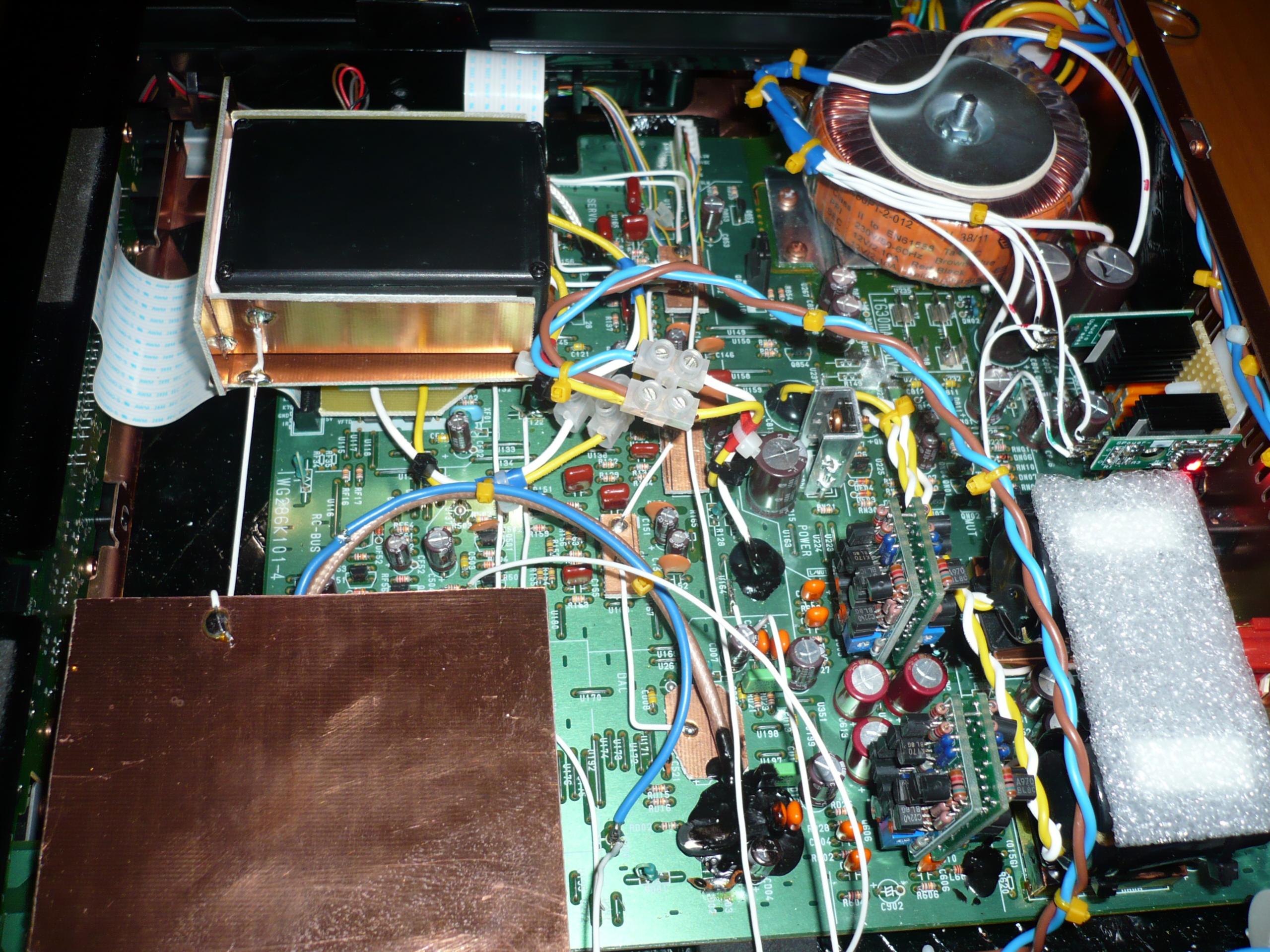

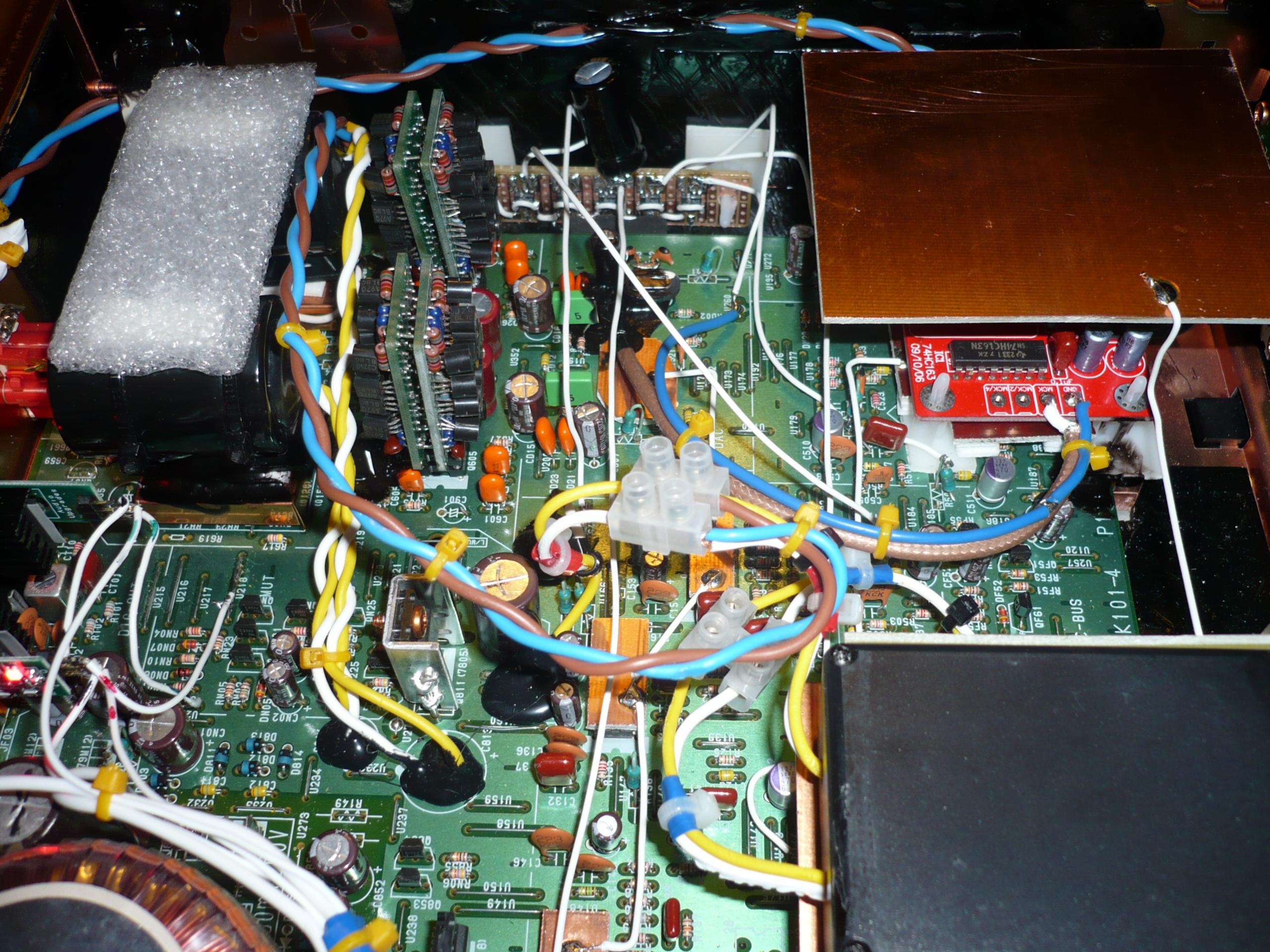

I have just completed modding my CD63 and 2 photos are uploaded here for reference.
In brief I have carried out the following changes:
Disable the entire HDAM;
Disable the phones circuit;
Replace the two opamps with two Burson discrete opamps;
Replace C813 and C814 with 22000uF caps;
Replace Q801 and Q802 with + and - 15V SPower low noise regulators;
Replace C803 and C804 with 10000uF caps;
Replace C805 and C806 with 470uF caps;
Replace CD15 & CD16 with 470uF caps;
Replace CD04 and CD07 with 470uF caps;
Fitted 5V low noise regulated supply to DAC;
Fitted a 16.934MHz low jitter clock (with own filtered power supply) to DAC;
Replace C510 and C511 with 470uF caps;
Fitted 5V low noise regulated supply to Decoder;
Fitted a 8.46Mhz low jitter clock (with own filtered power supply) to Servo;
Replace C120 and C122 with 470uF caps;
Fitted 5V low noise regulated supply to Servo;
Fitted 5V low noise regulated supply to RF section;
Fitted 5V low noise regulated supply to HF section;
Shielded (and earthed) all the ICs and the two low jitter clocks with thin copper sheets; and
insert an IEC socket for the main power supply.
(The 5V independent voltage supply to the DAC; the Decoder; the Servo; the RF and HF sections are being sourced from five low noise LT1763-5 regulators.)
Now the CD63 has transformed into an excellent CDP. The background is extremely quiet; the bass is extremely tight and extended; the SQ is very analogue with excellent transparency and soundstaging; the mid range is particularly warm and pleasant to hearing. The CD63 can now reproduce all the very minor details in the HF range but will not cause any hearing fatigue.

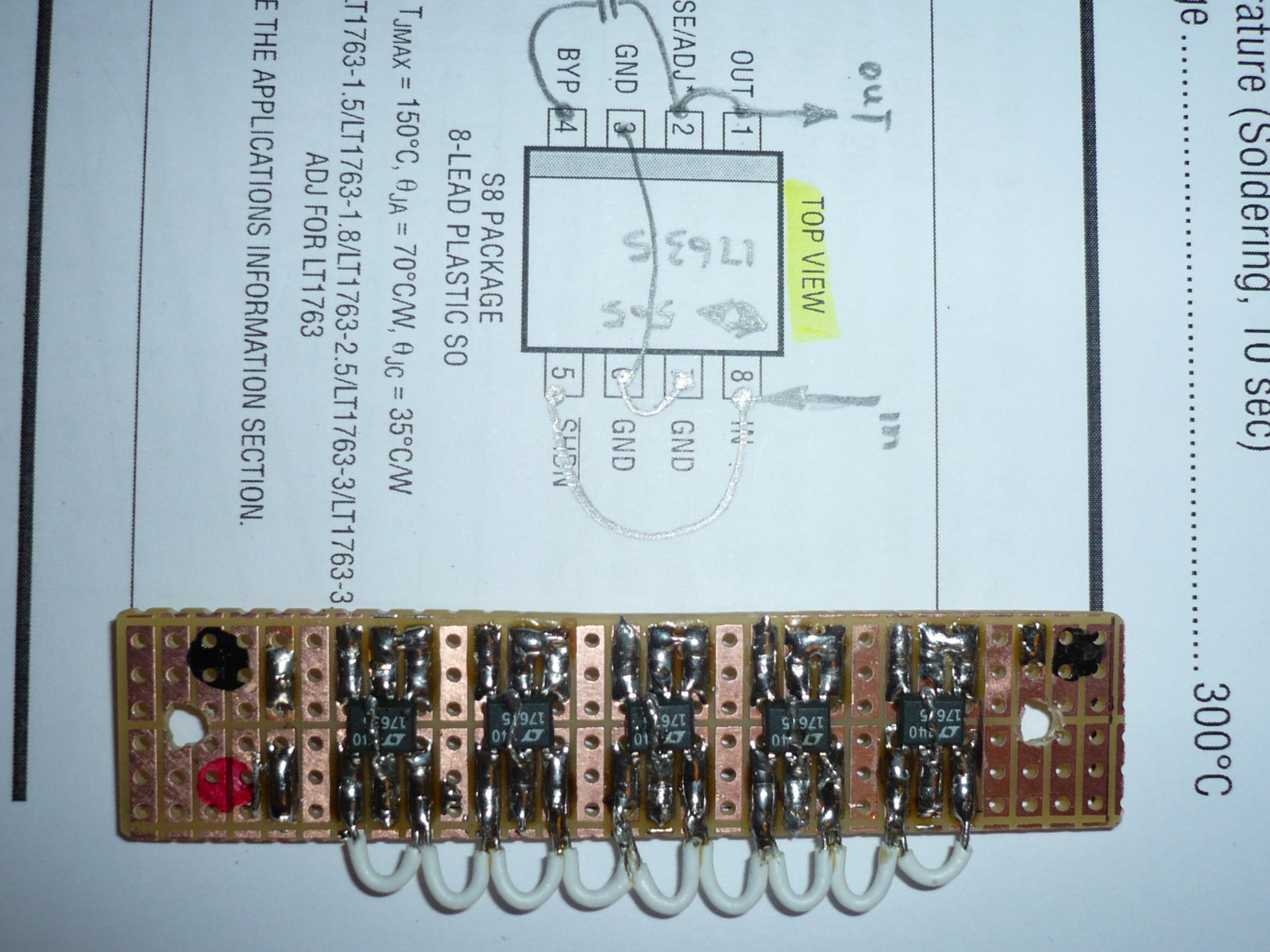

Yep....me too. In the end, I designed my own PCB and started making my own regs using the same principles as the SPower. I've not tried the new discrete version yet, but as I now have a new toy (sa7001) to play with, I'm sure I'll try them very soon.
Generally, you get what you pay for so the cheapest option is to built it yourself.
Do a google search for Opamp regulators then the same for a l weekes and you will learn something about how regulation works.
Personally, I would doubt that the claimed specs (whatever they are) are anywhere near accurate. Continue to separate supplies and look to use decent regs where you can afford to. I would say that spending £30 on a reg instead of £50 was a false economy. Some would say to spend £50 on a reg was also maybe not worth it. I would disagree and that's why I now build my own, it's the only way you will get decent quality cheaper!!!!!!
Of the eastern sourced electronic items I've purchased, they are normally by good in some area's and very poor in others. I.e. I has some LM3886 amps on my rear channels. Both output devices failed and were replaced with items sourced from Farnell in the UK. The new chips have lasted several years now! My green DAC lost the cs8412 which I replaced sourced via this forum and again no trouble since.
I think they say "buy cheap, buy twice????" Having said that, I'd be interested to try one of those regs just to see what they are, how they work and if they are any good!!
Actually in my mod I have used two SPowers on the analogue rail, ie. + and - 12V but they are not cheap at all. They costed me £100 :whacko:

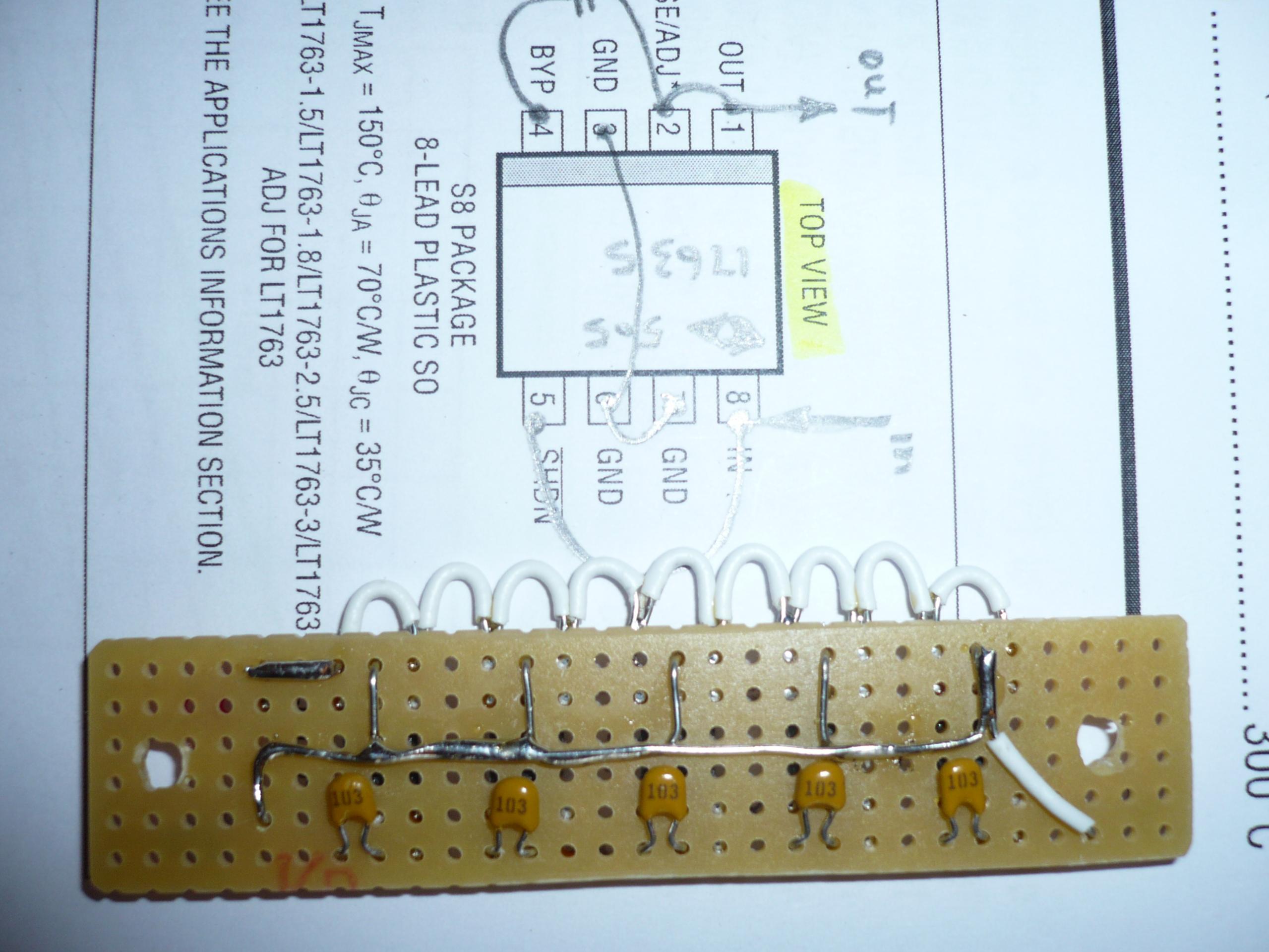

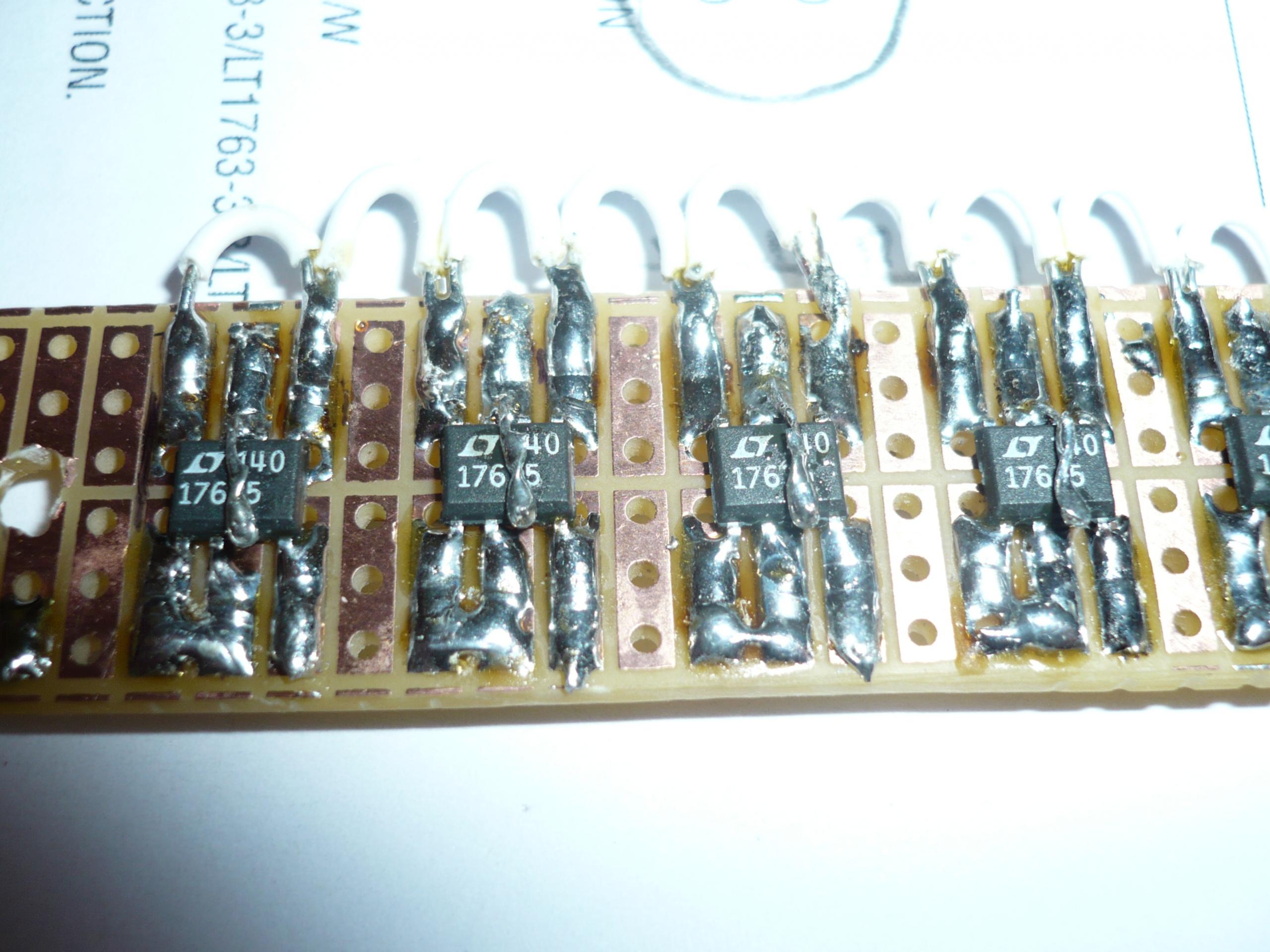

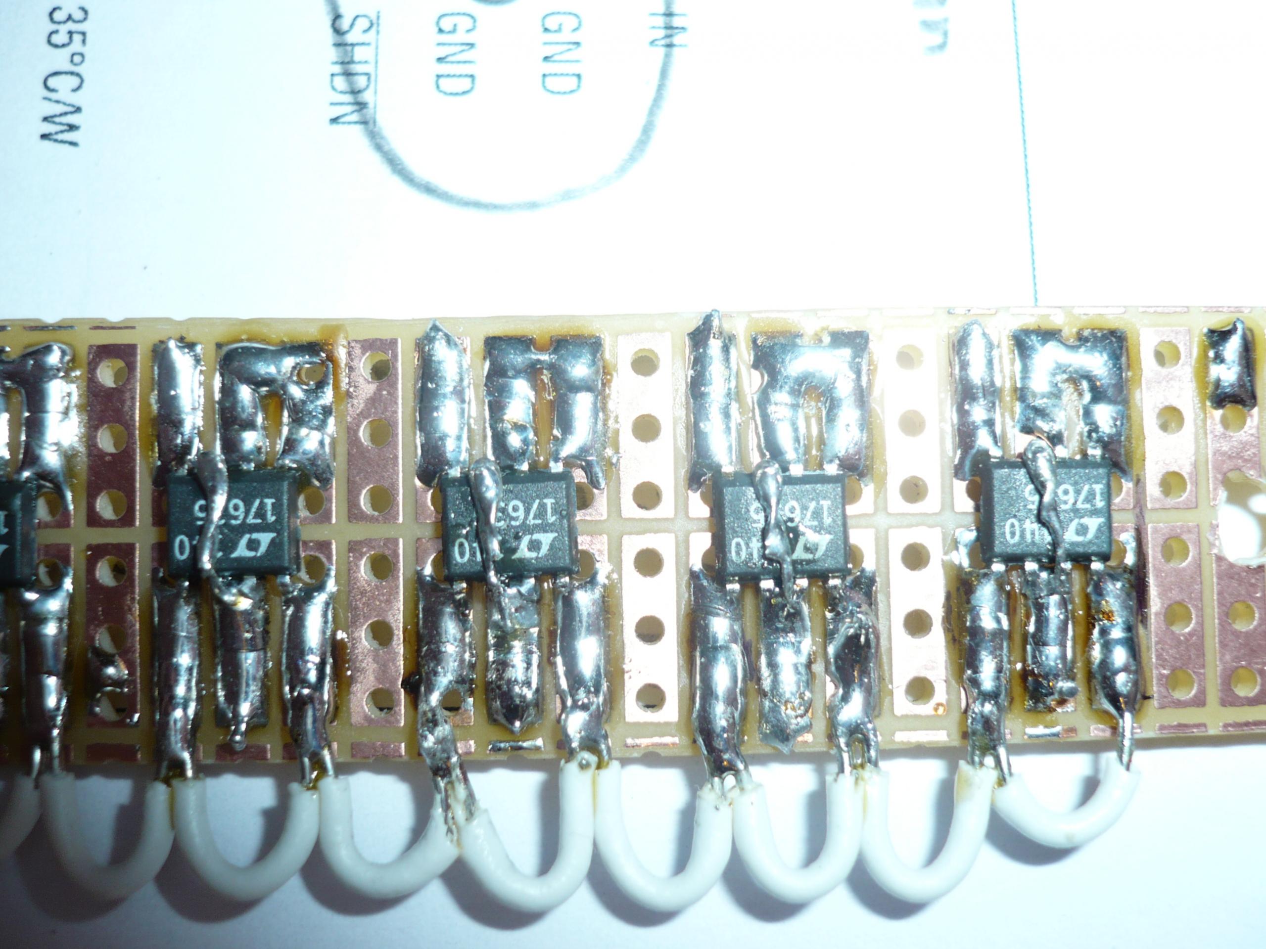

That is why I built my own low noise regulators for the servo, the decoder, the DAC, the RF and HF section providing independent power source to them.
What I did was using a cheap but effective low noise regulator chip LT1763-5
http://cds.linear.com/docs/Datasheet/1763fg.pdf
This chip gives 20uV(rms) low noise output and 500mA current which should be good enough for the different sections of the CD63.
You may wish to have a look at the few photos of my DIY work.
The total cost of five chips and five 0.01uF caps is £10 but the result is stunning after fitting them onto the CD63. May be it is not as good as SPower but in considering the money spent I think is extremely cost effective.
To make this cheap but effective regulators the only thing you need is a pair of steady hands and good eyesight. The chip is surface mount having a size of 4mm X 3mm.
This photo shows the location and connection of the DIY voltage regulators (on the right hand side of the photo). It supplies +5V low noise steady voltage to the Servo, DAC, Decoder, RF and HF sections of the CD63.
On the top are two SPowers supplying + and - 12V to the opamps (with heat sinks added). The BIG capacitor (1000 uF) is connected to one of the outputs of the DIY regulator supplying source power to the HF section.

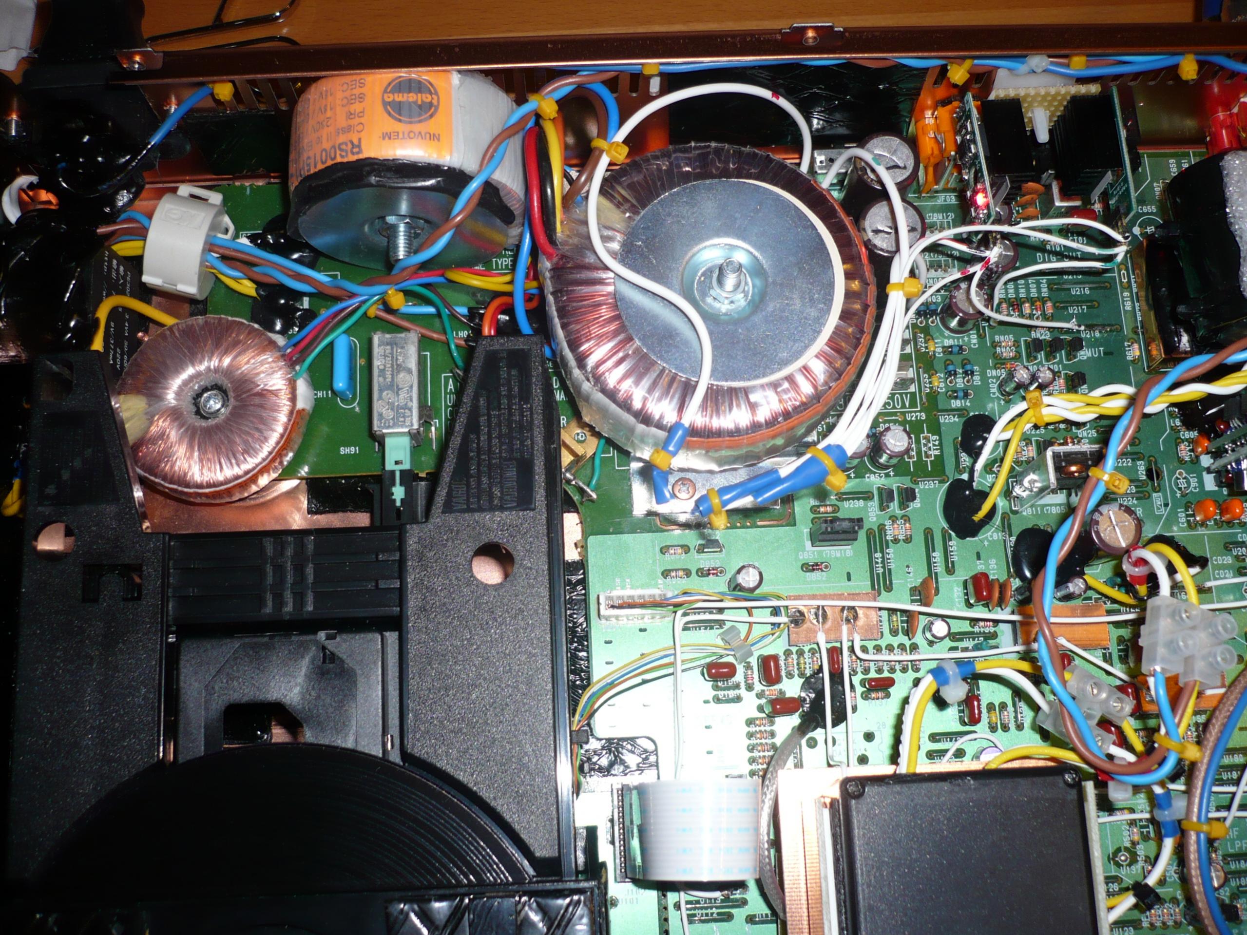

As promised this is an update on my mod. I have completed replacing the stock transformer to three independent transformers. See the uploaded photo.
You can also see a small square encapsulated transformer on the left hand side which is used to supply power to one of the the low jitter clocks (for Decoder/DAC).
You may appreciate the difficulties of placement of the 4 transformers in the very limited space. Now the CD63 sounds really GOOD to my ears !!!
I have just purchased two 10,000uF 35V good quality Panasonic capacitors to replace the low quality (cheap) 10,000uF caps I previously installed on the analogue rail. I hope this will make the bass even more solid, tight as well as making the overall SQ more analogue from the Burson opamps.
