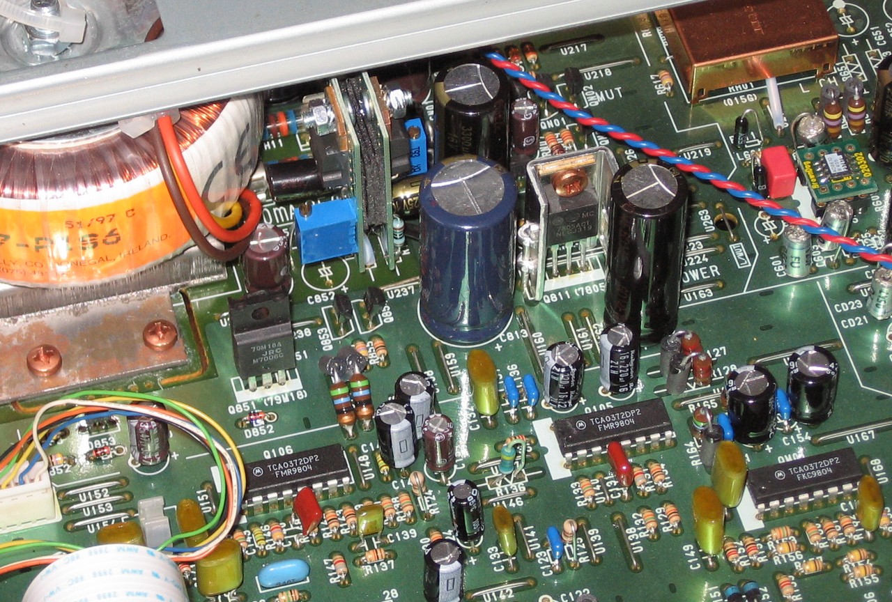

Hi guys,
I'm gonna try and regulate the Servo drivers on a 63KI.
It looks like I want -12v to pin 9 and +12v to pin 2 on Q105 and Q106. Am I right?
What does QM 01 do and is it worth regulating.
Steve
Hi Steve,
+/-12V is a bit too high. You won't break anything, because the drivers can handle 40V, but the motors don't need such a high voltage. The voltages that are listed in the service manual are measured at no load in STOP mode. When the player is working, it's more like 9...10V or so, depending on the size of the buffer caps C813/C814. You can use standard 7808/7908 regulators if the voltage under load is at least 10V. They need about 2V voltage difference between input and output. If you enlarge the two buffer caps you can crank this up a little if it's a bit too low. If you use an external supply, this doesn't apply of course :D.
In my CD63-KI I used LM317/337 regulators and tuned the output voltage with a trimmer to about +/- 7.5V and used my scope to check if there weren't any dips in the output, works equally well! I used only two regulators for all drivers and put them where R149/R150 are. I moved C852 to the back of the board to make room. U161 and U162 were removed to disconnect QM01 and Q105 and I wired them to the new regulators under the board.
Here's a pic!
Ray

Thanks Ray,
seems simple enough
I assume pins 2 and 9 are correct ;)
