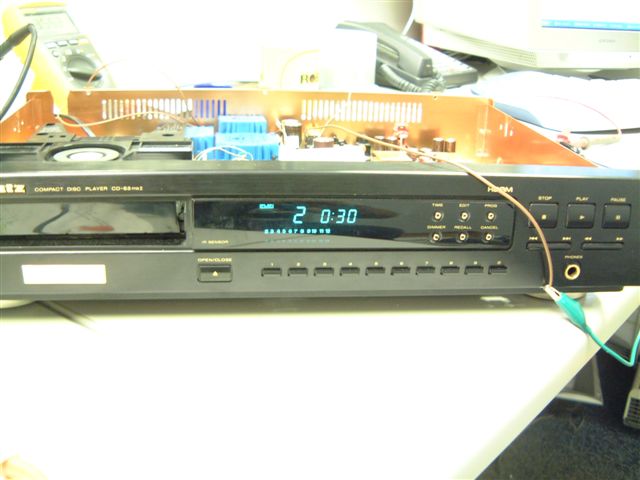

Well after a quick mess about with resistor values I have a display now too.
12V ac divided with 10ohm and 100ohm resistors. Ohms law does not equate due to current draw but it now runs at 3.4V.
Im going to run all day to check for thermal problems but as yet everything seems fine.
rowemeister said:Well after a quick mess about with resistor values I have a display now too.

poynton said:
Hi. How much current is drawn by the heater??
Andy
Not checked but I will do....stand by....
Hi Brent,
Well, there's must be at least one thing that doesn't equate .
Why don't you use just one series resistor?
Like (12V - 3,4V) / 0,2A = 43 ohm ?
The 100 ohm you have in there now only increases current draw. The display needs about 0,6VA, so 0,8VA seems to be enough at first. But total power is 12V * 0,2A = 2,4VA and not 3,4V * 0,2A.
Ray.
poynton said:Hi.
Something doesn't add up ?
To drop 8.6v across 10ohm = 0.86A !!
V = I x R and all that ...
It suggests that you are really overloading the Tx to get the nominal 12v to drop to an on-load voltage of 5.4v.
200Ma x 5.4v = 2.7W
Andy
Your right and the tx is running pretty hot, its with in its max temp but I dont like it.
I used the 12v winding as it was spare on the tx to see how well the display would run etc
I was about to order a 6v TX so the volt drop would be less.
6h5c said:
Hi Brent,
Ray.
Not tried the one res approach yet, I just banged it all together in my lunch whilst eating and ran it.
Coffee break coming up so ill give it a whirl.
Brent
