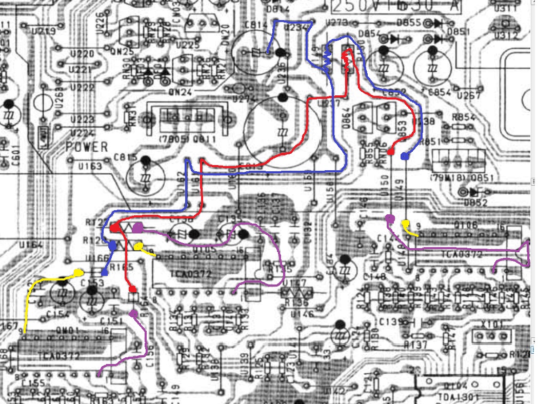

Okay, I had a good look at the service manual and I'm left with a few questions:
What to do with the resistors? Do I replace them with the regs or do I add the regs parallel with the resistors?
Also, on UV101's picture I see there are 2 regulators in place of jumpers U149 and U150. I couldn't find these jumpers in the schematic. I did find R149 and R150 which are connected to the power rails, but I can't find these resistors on the PCB... So is it correct to replace jumpers U149 and U150 with regulators?

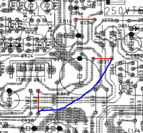

Thanks brent,I do bang on about this a lot but C813 needs swapping for a massive uF cap (10000uF min) we use 22000uF + short the fuses out. Bass is improved along with the whole sound

RS do a panasonic 22,000 uf 25v that do the trick then short the fuse holders .
cheer alan.
ps copper bar you know where
Alan those panasonics are very good vfm
Panasonic 22,000uF 16v
Get 2 and do the C814 as well!!! they are only.
If you really feel like pushing the boat out, get 2 of these for the other rails and replace C803 and C804
Panasonic 22,000uF 25v
You will need to be creative with placement but it'll be time and money well spent if you ask me!
My pal has my player at the moment so I cant check but the mod is to basically look for the rails to each of the driver IC's. You need to trace to a point that you can disconnect its own individual supply. From memory, 2 of the driver ic's have resistors in the supply's and one doesn;t (even tho it is shown in the SM).
All I did was to remove the supply resistor or link and put the supply pin of the reg into the supply side and the output side to the the driver ic side. Then you can solder the gnd pin directly to top of the board which is gnd.
Not sure if this will help or confuse!!!!
Red lines are the +10v supply, the red dots are where I connected the "in" pin of the 7808 reg. The purple lines are the regulator +8v output to the driver ic. The gnd pin of the regulator is connected to the screen layer on the top of the pcb.
The Blue lines are the -10v supply and the blue dots are where I connected the "in" pin of the 7908 reg. The yellow lines are the regulator -8v output to the driver ic. The gnd pin of the regulator is connected to the screen layer on the top of the pcb.
The 2 resistors at the top of the pic should be removed and linked out.
If you are doing all this, you should also change the local decoupling caps for rubycon ZLG 220uF or 470uf which I didn't do!!!
C153,154 C135,136 & C146148 (not sure about the last 2)
Edit last 2 are ceramic - replace with the ZLG and remove the other 4 ceramics that bypass the new ZLG's

Fit them instead of the wire jumpers, remove the third one and put a wire to get the regulated DC there. And yes weak PSU players like my CD43 are at pain with this mod, calling for a new TX. BTW a cheap and effective mod!
