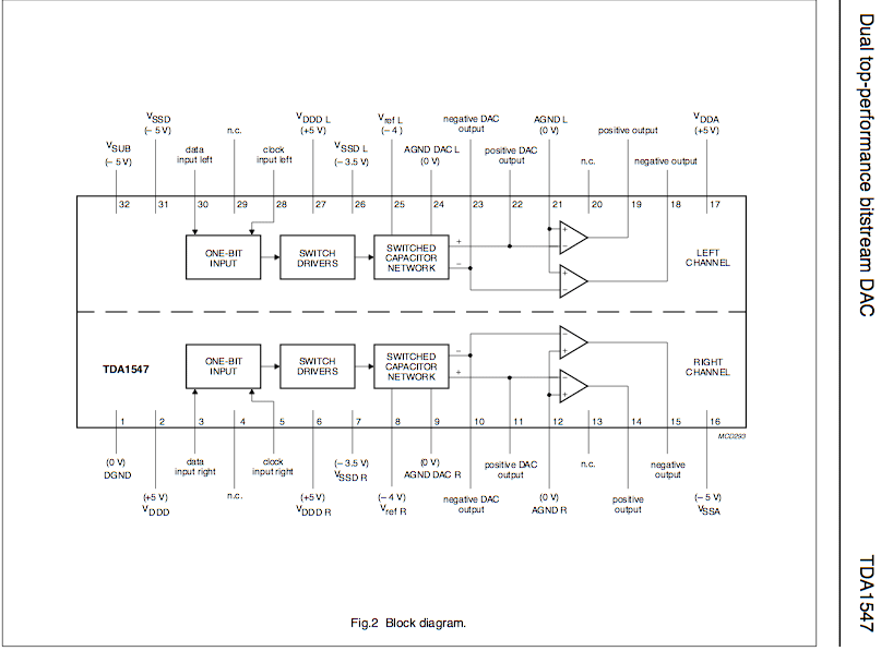

I need to place a dos in a DENON DCD3300....
It is an old player built like a tank and surelly worth the work.
My first issue is related with some errors I am getting while trying to read discs... it does not read them all and most of the times, when reading, it produces a scratching noise (directly related with the CD spin speed).
Can you please tell me if I should replace the lens and if after that I could install the dos ?
Ricardo

DENON DCD3300, PCM56 dac Ricardo. Very nice indeed!
I expect you'll need more gain from the dos, unless it has higher output than the TDA1541. You may also be better with a transistor version as opposed to fet as they're reputed to be better for current/voltage conversion, although I didn't try this.
Lee.
Lee.
Yes a DOS is probably not what you need. It's for balanced voltage output DACs.
This DAC has unbalanced current output and an internal I/V op-amp for unbalanced voltage output too.
The player may of course have two per channel for differential signals, I don't know.
If you use the internal I/V op-amps for v-out, and there are two per channel giving balanced voltage, you can use the DOS. (You could use it for unbalanced too but there wouldn't be much point.)
Maximum performance would be to use the current outputs and a discrete I/V stage.
But remember the DOS does not perform I/V conversion.
How do you know if it's balanced or not? I think it is as it looks symetrical...
Right now I plan on using an extrenal single opamps like top Analog Device or National Semi to do the work of the internal ones and the DOS it.
Again, I'm begging all you even if have different points of view (that makes us more rich!) on my http://www.diyaudio.com/forums/digi...7-tda1547-vs-tda1541a-r1-vs-sm5872-story.html ! Promise I won't do (too soon...) commercial break for my church again :D
