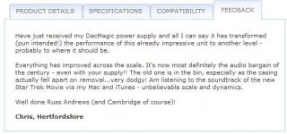

rowemeister said:Glenn I agree it's a bit clinical mainly due to the rubbish caps used. Yes the original psu gets red hot and I have had a few customers say the psu has come apart.
How much was the 36VA mappo tx and do you have a part number
Brent
The Maplin part number is L54BR.
It's twice as big and twice as heavy so is one of those that's in the middle of the cable. Too big for a plug-top. 12VAC@3A.
I measured the output voltages for both units, open cct and under DM load (remember at 250VAC input in my flat).
Stock: 15V / 14.5V
Mappo: 14.9V / 14.6V
So no danger of the DM running any hotter due to higher rectified voltage. It's a safe fit-and-forget purchase at only £15.99. I unclipped the ferrite from the CA one and put it on the Mappo one.
Or you can pay Ru$$ Andrew$ £99 for one the same size as the original!
rowemeister said:Nice one. I was looking at building my own for them with iec socket etc and better cable. I'll see what this one sounds like.
RA is a rip off merchant as we know
Brent
Interesting testimonial though. Cambridge should be recalling these PSUs surely?
