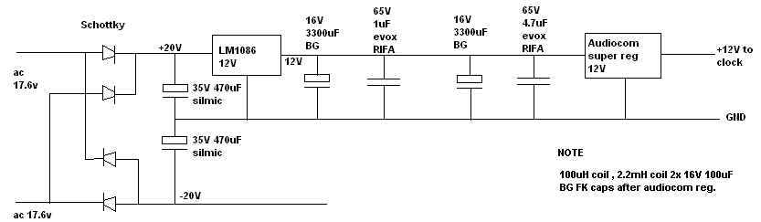

My clock currently runs from +20V rail to an Audiocom 12V reg with 2 coils and 2 16V 100uF Black gate FK caps.
Im going to take the supply from the raw ac and regulate it to the Audiocom so its isolated from the +20V which supplies my regs for opamps.
Here is the proposed diagram, any advise would be welcome.
for 12volt out of the audiocom reg
i think it may need more than 12volt in?
do a search for info on the LT reg, I read they can be difficult on layout.
allan
ps also how about a inductor (coil with beads) before the super reg.
Yeah that was an error awpagan. You can only get the LM1086 up to 5V and then you add zener diode to gnd for its ref. It will actually be 15V.
Brent
Hi Brent,
Why don't you use the adjustable version?
I don't like the idea of lifting the regs reference with a noisy zener :bigeyes:. This will be transferred to the output.
It will also enable you to decouple the adjust-pin and get better rejection ratio :yes:.
Why do you use two 3300uF BG's and two MKT's? Is there a lot of wire between them?
Ray.
