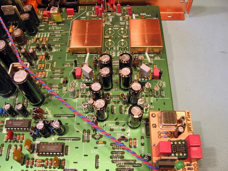

DOS DOS DOS
It seems I finally have enough courage to dismantle my CDP to place the recently built DOS.
Wish me luck guys.
1 - Open the top lid, remove the back,
2 - Disconnect all the wires from the 4 additional PSU´s and remove them
3 - Disconnect the "Evil" ribbon from the mech
4 - Lift the pcb and turn it over (carefull with the display ribbon)
5 - Remove the +-15v pcb that feeds the opamps
6 - Remove the opamp caps
7 - Remove the DAC digital srayreg to be able to access the DAC output resistors.
8 - Place the pcb back again and fix/glue the DOS
9 - Place the four wires from DAC to DOS input
10 - Turn the PCB over again and solder the DAC -> DOS input wires
11 - Place the DAC digital srayreg and cap and solder again.
Etc Etc

Thomo said:If you need specific help with these two stages, Simon is an expert and is usually only too willing to help.
Auw, sarcasm detected...
Good luck, Ricardo! May the force be with you...
Ray
