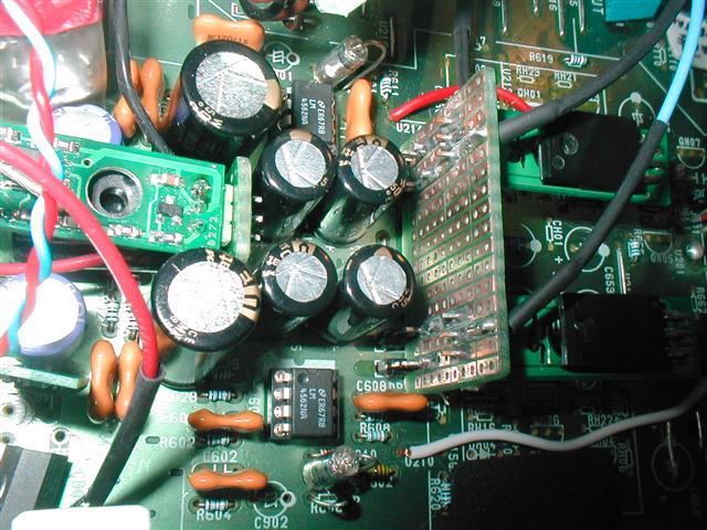

I have just finished building this DOS.... Did you test the DOS before installing it on the CDP or did you connect it inside the CDP from the beguinning ?
I would like to test mine before it replaces the CD53 opamps and would apreciate some guidance.

Just finished my DOS for the D53.
As I will have to do major surgery in the CDP just to be able to locate the DOS inside, (I will need to remove the opamps, opamp PSU and caps to free some space, drill the back panel to fit some RCA´s, fix the big output caps)...:smash: :smash:
So I would like to test it before instalation.
I just built a bench regulated +-15v psu to fire the DOS before instalation, but I do not know what to feed in the input and what to expect in the output.
Would you explain a simple procedure to test the DOS ?

I basically just hooked it up and hoped it would work.
Hi Steve
This is a bold move that I would like to avoid.
Removing the resistors after the dac can only be done after removing the spower feeding it.
I must also rearrange some internal psu´s to make space for the DOS.
All this involves a lot of work so I would like to be sure the DOS is working before instalation.

You can simply take the input to where it goes without disconnecting anything else and run a temporary power supply and output connection.
This will enable you to test the DOS without destroying your cdp.

Hi Glenn
So this means I can have two outputs, one from the DOS and the other from the opamps.... and compare the results. :devilr:
Nevertheless I will have to major surgery because the pesistors after the dac are now covered with a rig containing the dac analog spower and another cap (moved on top of the resistors to free space for the dac digital srayreg.
Can I make some kind of experiment with the DOS before I install it.... just to be sure it is working ?
My pcb is so modded that any transformation puts everything at risk right now..... (I am specializing in padlifting :angel: )

As a temporary measure, you can use long leads tacked on.
When I was experimenting , the leads from my CD63 to my breadboard were about 40cm long!
Don't forget the DAC output is not analog but 5v PWM signal.
Thank you Andy
I will fire it up before connecting to the CDP and will verify if the voltage before the output cap is +7v.
Then I will dismantle the CDP, make room for the DOS, be bold like Simon and hook everything up....
:smash: :smash: :smash:
With luck, it will work the first time.
This will be fun !!!

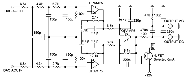

The NPC DAC used in the CD 43/53/63/1010/1020 family is a slightly odd beast regarding it's requirements for a filter, but some of this is applicable to other DACs as well.
Basically, the NPC DAC output is a 13-position PWM signal running at Fs*32, which is a fairly low frequency regarding filter design, but still high enough that careful attention has to be given to the OPamp used if the filter is active.
The problem with the original circuit is that the impedance the + and - differential PWM outputs see, is different at audio frequencies, and one of them is also highly dependant on the OPamp's open loop gain characteristics. This is because in an attempt to save on one OPamp per channel, the first two filter stages and differential to single-ended conversion have been merged into a single circuit. As a result, filtering for the + input to the OPamp is 'passive', while for the - input it is passive for the first stage, and 'active' for the second. 'Active' because for this particular circuit, a capacitor that goes to ground, forming the second stage of the filter, for the + OPamp input, ends up in the feedback loop of the OPamp, for the - OPamp input.
The effectiveness of this cap in the feedback loop depends heavily on how much open loop gain the OPamp has available at the frequency of interest. In general, the open loop gain is frequency dependant and falls with the rise of frequency, whereas the effectiveness of the cap should rise with the rise of frequency - after all this should be a low-pass filter. To make matters worse, the actual impedance of the cap is in series with the output impedance of the OPamp, which may be highly nonlinear at high frequencies. If one further looks at the actual OPamps used in the original circuit, one has to wonder how much open loop gain there is available at over 1Mhz, and the answer is a most emphatical, not enough.
The fact that the + and - DAC outputs do not see the same impedance at audio frequencies (and beyond) also contributes to PWM output edge asymetry. Because of the particular 'pseudo-differential' way the NPC dac works, this can translate into a form of noise similar to jitter.
To correct this problem, the putput stage was re-designed so that both + and - outputs of the DAC are passively filtered by a 3-stage filter (so, third order). Then, they are buffered by a sufficiently fast OPamp (one for each differential side), the idea being that the fiter characteristics are not altered by OPamp open loop gain (or indeed most characteristics) and the OPamps get a signal to work with, that has the HF component dubstantially filtered out already. Finally, a third OPamp is used as a differential to single ended converter, which is also augumented to form a first order filter, so the total filter order is 4. The DAC outputs see completely balanced impedances, the actual Opamps see a signal with an already substantially attenuated HF component.
Now, because the NPC DAC runs at a fairly low output rate due to it's PWM outputs, the filter corner frequency has to be set fairly low. Also, the PCB layout leaves a lot to be desired - >1Mhz signals are routed very circumvently by windy tracks several cm long, which form substantial inductors in in series with the filter caps, reducing their effectiveness. In an attempt to ameliorate this problem, the first stage of the filter is deliberately tuned lower than normal, and it is made differentially (cap is between + and - outputs of the DAC), so that most of the RF energy stays within a small loop area near the DAC. However, this results in about 1.5dB attenuation of the signal at 20kHz. The original filter had similar constraints, an attempt was made to correct this with the second OPamp which is also set up as a filter, with a notch at 32*Fs, as is well documented in this thread, INCORRECTLY. In the redesign, the buffer stages after the passive 3rd order filter have a suitable configuration so that a slight correction in form of a shelving filter can be added easily. As a result, the compound response stays within +-0.15dB right to 20kHz.
The final tweak is the addition of current sinks to the OPamp outputs to set the OPamp into class A. I have made this defeatable by jumpers, because not all OPamps work well set this way. All OPamps are on zero-length sockets (turned pins that fit directly into the PCB so the length the signal has to travel remains unchanged), and several OPamps have been tried, with quite surprising results. Also, there is no DC servo, but luckily, the CD1020 has two pairs of output connectors, normally connected in parallel - after the mod, one set is DC coupled to the OPamp output, the other is AC coupled through a capacitor.
Of course, more modifications were done to the power supplies and ground routing, this only covers the changes to the analog output section. I will post the svhematic for the new analog section later today...

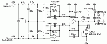

Schematics of the output stage...
OPamps are not labeled as they are socketed (duals are used due to the existing PCB design). Also local decoupling for OPamps is not shown (RC filter off of + and - 12V lines, R=10ohms, C=470uF in parallel with 0u22 foil, also there is a 2n2 non-inductive foil between + and - power pins of the OPamp, given the layout, without it say, an OPA204 will oscilate).
If you look carefully, you will notice that t he elements of the passive filters form a resistance close to 12.1k at LF, balancing the 12.1k in the feedback loop of the buffer/shelving filter OPamps. This solves 3 issues:
1) Balanced load on DAC PWM outputs (AOUT+ and AOUT-).
2) Feedback resistors are mandatory for the shelving network anyway
3) A bipolar input OPamp can be used without causing undue offset problems, even though it is not an ideal choice for the job.
The 100p + resistor (39k shown) in series, between the - inputs of the OPamps is a part of the shelving filter network designed to correct excessive response droop at 20kHz. The resistor can be varied between 33 and 47k for minute adjustments to the actual frequency response over about 5kHz. The range of adjustment is about +-0.3dB, with 33k the response drops monotonically and has about -0.3dB loss at 20kHz, while for higher values there is a slight peak at 8-11khz (up to 0.15dB when the resistor is 47k) before the response drops, but the loss at 20k i sless. With 39k, the peak and drop are about balanced at around 0.1-0.15dB depending on component tolerances. While not obvious, the character of the sound does change quite perceptibly by varying this resistor, and can be used to 'offset' the character you get with various OPamps.
The current sink formed out of a single FET, selected for 6mA Idss, forces the OPamp to work in class A into loads as low as 600 ohms (with some current to spare). It reduces the maximum voltage swing available from the OPamp but the 12V power supply insures that t here is ample reserve over the 2V RMS output for 0dB full scale digital output. The current sink has a jumper so it can be disabled for OPamps that do not like this sort of thing.
I dod not try any exotic OPamps here, more what i had in storage - the usual NE5532 by TI (Originals are NJM4560), LM833, AD712, OPA2604, OPA2132, LT1022, LT1057. Quite surprisingly, the most pleasing and balanced sound was obtained by using AD712 for the buffer/shelving filter, and LM833 with current sink enabled, for the output.
