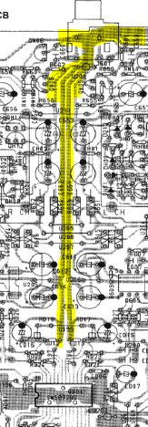

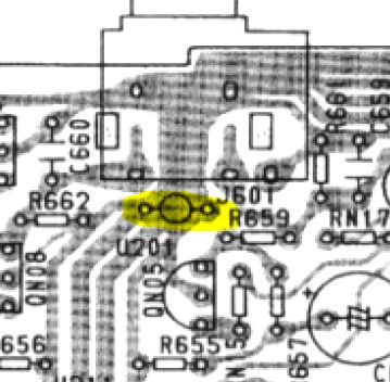

No, I can tell why the layout is done this way, but it's surely not following the textbook.
I would concentrate on mainly two, the analog under the RCA, and "the rest" which are digital. The DAC is an obviously and possible separation point.
If you look at this picture, you can see, that the agnd pins from the DAC links nicely to the analog starground.
If you do follow the agnd starground, it's possible to remove U201 which connects the analog starground to the top plane.
You must check yourself, if this is the only connection.
Your analog PSU must conncect it's gnd to this agnd starground.
That's why I says, it's much more easy to do, when you have a separate outputboard. My agnd is mainly my gnd on my discrete board.
Ohh, and pls. do remember, the standard RCA connector connects the agnd to the chassis. I can't remember whether the chassis is connected elsewhere in the standard machine, check with a DMM.

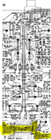

Following the digital star gnd near Q811 +5vreg, I can see it links to the servo and drivers below, to the analog psu between c803 c804, but also to the analog star near U201.
From here, the lines go to the analog dac gnds but also to the digital ones (using independent lines).
So analog and digital gnds are all linked together.
Should I try to isolate the agnd from the dac and opamps from the star near U201 ?
Ricardo

Yes, it's a mess.
You could try to isolate the agnd, the star near u201 from the rest. This should give you a clean agnd including agnd for the DAC, (pin 19 and 24), gnd for the OPAMP's, gnd for headphone (?, I don't have this in my box anymore) but remember, the DAC has analog power lines on pin 17,21,23,26 (combined in u200) that's reffering to agnd. I'm supplying this from a separate PSU incl. tranny, if you don't have this, take care of that gnd reference.
Don't do anything that you sure about.
avr300 said:
Yes, it's a mess.
You could try to isolate the agnd, the star near u201 from the rest. This should give you a clean agnd including agnd for the DAC, (pin 19 and 24), gnd for the OPAMP's, gnd for headphone (?, I don't have this in my box anymore) but remember, the DAC has analog power lines on pin 17,21,22,26 (combined in u200) that's reffering to agnd. I'm supplying this from a separate PSU incl. tranny, if you don't have this, take care of that gnd reference.
So I should feed the analog dac and opamps via a separate psu.
This psu can use a reference gnd linked to my "floating" star gnd.
Is this feasible ?
Ricardo
