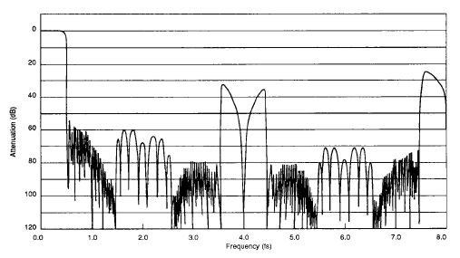

That's not really the problem, the noise is wider-spectrum and higher up the frequency range, because the PWM output is unfiltered. Remember, square wave = lots of harmonics.have you done any measurements as to the 44.1kHz output from the dac.
Apart from that, there is a lurch upward in the DAC's noise floor about 340Khz (8Fs) if I remember correctly.

The datasheet states a 53dB attenuation at Fs, the sample frequency is already suppressed in the DAC. The passive filters attenuate about 7...8dB at this frequency, so overall there would be at least -60dB at 44.1kHz.
martin clark said:That's not really the problem, the noise is wider-spectrum and higher up the frequency range, because the PWM output is unfiltered. Remember, square wave = lots of harmonics.
That too!
Would that be the source of the 22mV noise I measure with my poor 20MHz scope at the output?
