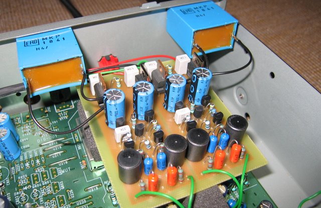

Just a little update
Hi folks..
Here's just a little update. I changed the coupling caps from el-caps (the old Silmics fitted perfectly :clown: ) to these films. MUCH better resolution now. It's really like night and day.
