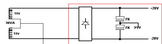

Hi
My nuvotem +-18V just arrived.
Can anyone suggest a good way to set it up inside my CD53 ?
The whire collors are a bit confusing... Can you help me sort it out ?
Can I use the following setup?
Red + 18V
Black // Yellow Common Earth
Orange - 18 V
Best Regards
Ricardo

Linking the datasheet might prove helpful:
http://docs-europe.electrocomponents.com/webdocs/0030/0900766b80030cb8.pdf
The primary should be self-expanatory... brown to hot and blue to neutral (I'm from the US, so if I say something wrong for UK, rest of world, someone step in ).
For the secondaries, you have 2x18V and it appears your PSU is set up for center tapped. Per A,veco's datasheet (http://www.amveco.com/pdf/Amveco_Catalog.pdf#page=25), the secondaries should be wired as you noted with the black and yellow tied together for the "center tap".

Andre Visser said:I believe the 2 x 18V, 30VA with good capacitors is more than enough. Good to hear about your sound improvement.
Hi André
I need points to input +-18V from an toroid 30VA I recently bought as you suggested.
If I remove U306 and U307 will I isolate the stock TX and can I use these points to input the new AC ?
I must know this because I can not remove the stock TX.
Regards
Ricardo

I believe U306 and U307 is only fitted to strengten the pads, you will either have to cut the tracks or the pins on the transformer (if you are sure you wont use that winding again).
