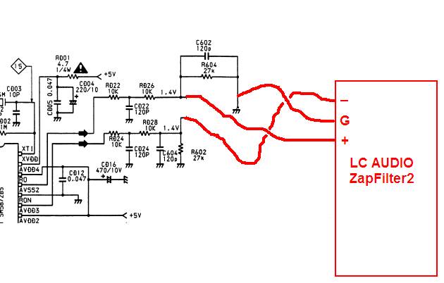

Glenn, what filter did you end up using before the zapfilter? Also what sort of offset do you get from the zapfilter? I had over 200mv on the left channel before I installed 1k resistors over the original 100r's in the current mirrors. Here's a pic of were to add the new resistors, the ones circled in yellow.

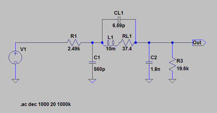

i found a nice little filter for the discrete output stage.
for use after LM317/337/..78/79's
allan
Mags.
No offset. Well it starts at around 50mV and the DC servo quickly drags it down and it hovers at +/-1mV.
Filter - I started with the 10k->120p->10k->120p//27k that was already there. With the op-amp gone, you have to ground the o/p pin of where diff amp was. This makes the circuit symmetrical. Remember the 2nd op-amp was inverting, so what went to -ve input of first goes to positive input of Zapfilter.

A word of warning - my inductors pick up hum! It's negligible now but I had to mount them underside of PCB and I think orientation was crucial to so hum is common mode.
I'd say let it settle down and only tweak if you're unhappy. The funny resistor values are because I used Welwyns, by the way.
One of the strange differences after installing the Zapfilter is that when I play music late at night at low levels, it still has enormous impact and detail. You don't have to play loud to really feel the music. Odd!
