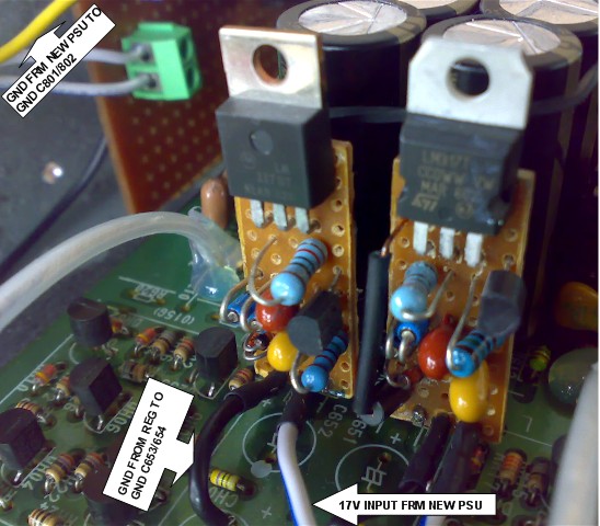

Hi Ray,
3 days ago I fitted +12V/-12V Raygulator on small pcb with independent new PSU (1Amp 12 VAC....= 12VA ???).
The regs inject to op amp via R651/R653, ground from regs going to star gnd (output RCA) via C653/654 and ground from psu wired to C801/C802.
Before fitted, I have checked output regs and got +11.96V and -11.68V, but after sitted in the CDP I got ((+9.69 V), (-11.67V), standby mode) and ((+9.60V), (-11.67V), running mode), what happened??....(raw DC supply from new psu (+16.10VDC), (-15.96VDC)
After 10 hours 'break in' I have noted that sound more open, more smooth and more dinamic especially in the mid range area also more deep and weight bass but I don't yet satisfy with bass resolution, I need more. What can I do?, replace dioda with fast recovery ? (1N4937), release snubber circuit?,bypass caps tank in the new PSU? or replace + regs?, others?
Note: PSU with 2xBG 1000uF/35V, dioda (1N4007) and snubber.
Regards
aquar
Regards
aquar
