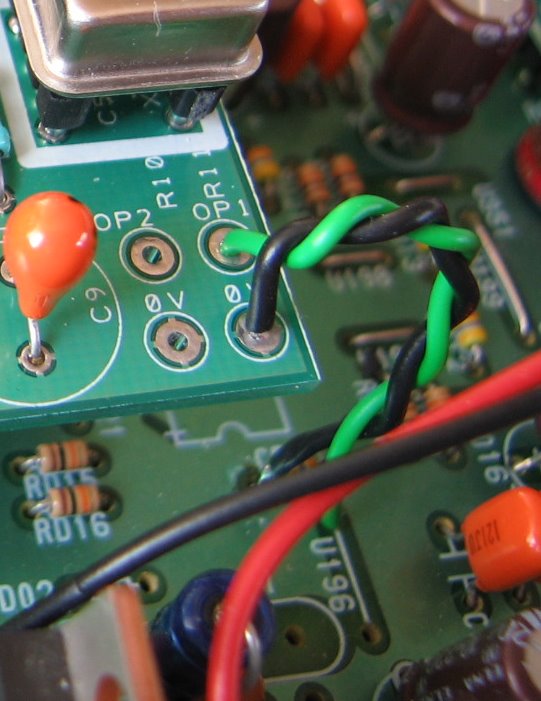

Flea output
Hi there,
I've in hand my XO from Tentlabs.
Is it safer to fit the socket? I've no other purpose for my XO but the Flea, if no danger for the XO I'll fit it direct on PCB.
How about wiring the clock? Flea's manual (Martin please
) says we should use a resistor. What's the deal with my CD53? Just remove the 2 cermaic caps and fit it like this or need a R?

Re: Flea output
Solder, but do a quick solder!
I have a (by memory) 39R SMD (on the pads on the Flea) in series with clock out.
Yes, remove RD02, CD02, CD03 and XD01. Inject the clock from the Flea on pin28 at the DAC.
Sorry, crappy picture, but it gives you an idea. It's from the past, before I did solder the XO onto the board.

Malefoda said:Thanks for the answer, but the 0V goes where? Pin 1?
No, pin 2. Pin 1 should have nothing connected to it after the external clock is added.
Use the two holes vacated by CD03.
Clock input to the hole nearest to the DAC, ground to the hole nearest to the side of the board.
Alternatively, you could connect to the underside of the board. Remove U196 and connect to the DAC side of this and the ground of CD05.
I chopped up a turned-pin op-amp socket and put pins in the holes and pins on the end of the wires. Easy to disassemble the unit if your mounting the Flea on the side of the case. If you're fixing it to the main board then not a problem anyway.
If you're powering the Flea from the main transformer, make sure the clock ground is the only ground. I.e, there must be three wires - supply in, clock out and ground.
