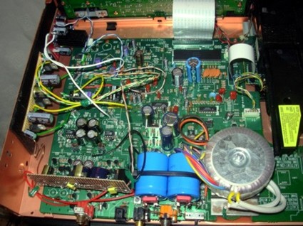

SimontY said:
It only works if your wiring is neat.
Does this qualify as neat enough? lol.
Thomo said:Does this qualify as neat enough? lol.
Ooh, quality. I especially like the big blue smoothing caps!
I said it needs to be neat because the thing doesn't work if the wire is too long from the divider to the servo clock input. Also it only works with certain coax wire, lol. Brent saying it's easy was giving his view as an expert, not a novice!
I bit blured but you can see the servo clock fitted with its nice regulator + a more moody shot where you can see the coax coming off the clock (also superclock 2).
The other wires are for all digital signals to and from dac / decoder / servo)
