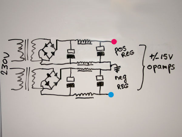

12v Psu
... and connection.
Note I wrote 15V in the picture, this should be 12 volt, and the diodes are incorrect. Kathode (indicated on the diode) should point towards positive of cap, anode to negative of cap.
Greg3333 said:
Jaap,
Thanks very much for that. If you really recommend the PSU upgrade that much I'll go for it.
On the parts list I assume that you mean 4x caps rather than 8x caps?
Greg
Greg,
Assuming the secundary winding of the tranny 5 ohm, a load of 10mA results in a ripple of 60mV with 470uF caps. With 940uF only 15mV.
The regulator will reduce ripple further and a small cap on the opamp (100uF) will wipe out ripple to almost zero. Use for this 100uF one with good HF response (BG).
Ripple on your power rails interferes with music, very faint but noticeable.
Regards, Jaap

Sorry to ask such basic questions in this post but I'm terrible at speccing components. :bawling:
I figured I might as well order a few more parts from Rapid while I was ordering the 12V PS parts.
Are the SB330 Schottky diodes also suitable for D801-4 and D811, D812?
Is there much improvement to sound quality from adding a filtered IEC socket in place of the original power lead? How about this cheap type?
How about a varistor across the power inlet? 20N391K?
I'll have to order opamps (probably go for OPA2134 until I can afford to go down the Browndog and 627 route), maybe new regulators and fancy caps elsewhere.
Does this sound like a reasonable upgrade path? I'm looking forward to hearing the player with slightly better opamps then I'll probably do the Acoustica clock hack once I've figured out what parts I need to order for that one.
Thanks for your help. I've read a lot of this thread now but the huge amount of information's a bit overwhelming so I apologise for inevitably repeating questions that have already been asked somewhere in the 367 pages!
Greg
Looks fine to me, I've used 100V/1A ratings. You might aswell replace all the power supply diodes as the inferior types radiate noise into the player.
Probably not much, no, but then the price is small. Alternatively a good sized X-rated (safety rating for across the mains) capacitor will do some good for it. The main reason to use a socket is to try a different power cable and have the convenience of detaching it easily.
Well you could but bear in mind they can 'wear out' and are perhaps detrimental to sound quality (some have said). An isolation transformer works wonders though! Search Ebay for "site transformer" or "isolation transformer". There's nothing good right now, but you can get lucky and buy an "untested" 500va rated 240 to 240v job for not much money. Don't pay more than £20 or so.
2134 is a lovely op-amp. 627 is better but not quite in line with the price difference, and more complicated to install.
Greg
Yeh, I reckon so!
Simon
