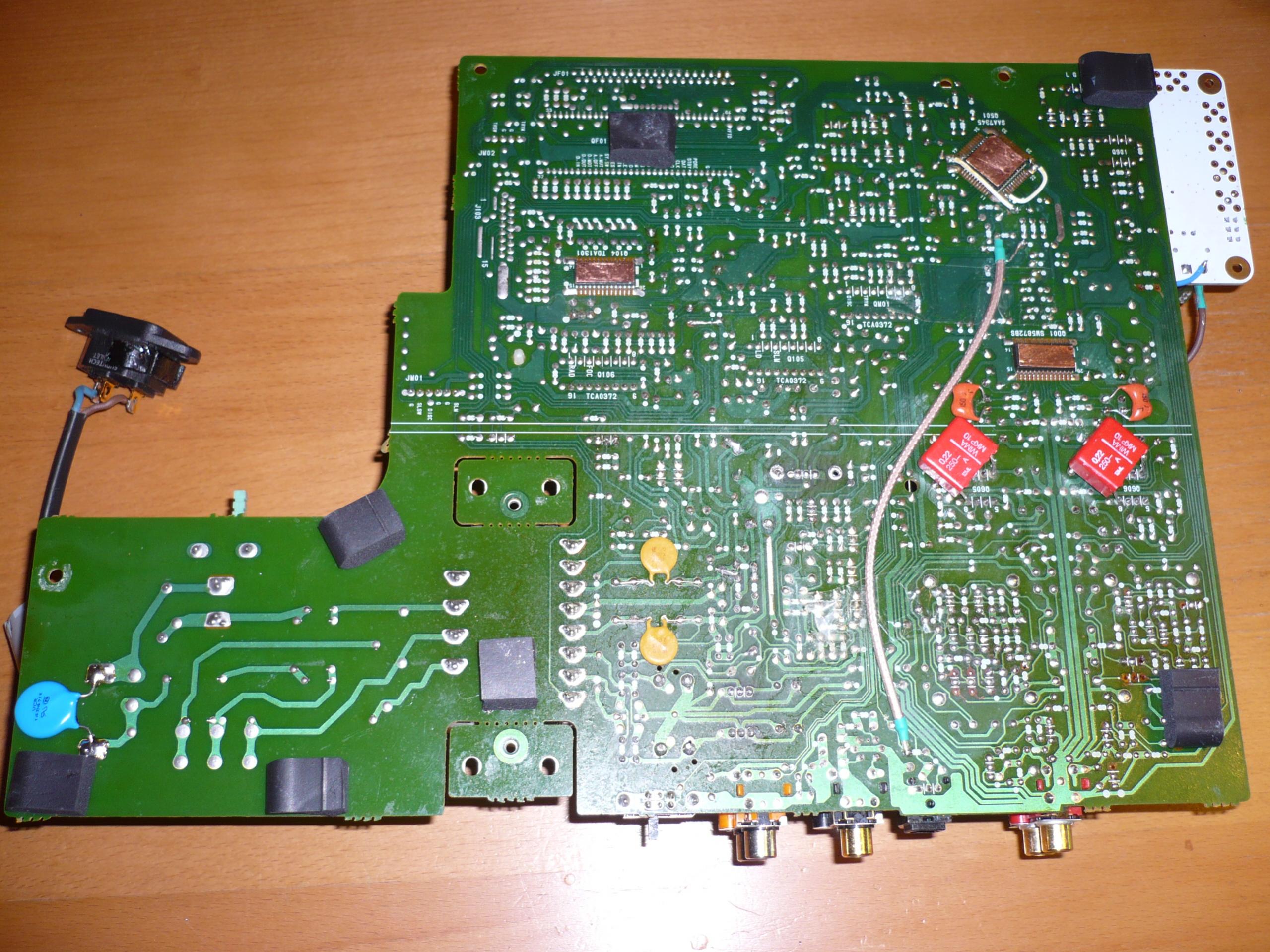

I'm still searching the thread; Ray did you coax all your digital signals in the end? Was the improvement as dramatic in your CD67 as Bob Noriega suggests in his article on CD63?
Just rationalising things
Think I'm going to install one additional tx but no more.
You only have shielded cable for optical out? Or others on top of the board?
I was talking about coax for HF and RF signals from the laser IC to the decoder and the data and click signals from decoder to DAC etc
IMHO the use of coax only benefits when the distance between input and output are far apart where noise and interferences may be pick. That is the reason I only use coax for the digital outputs as the path is quite long.
Either far apart, or if the signal travels through a particularly noisy/busy part of the circuit perhaps?
