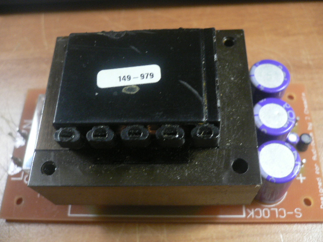

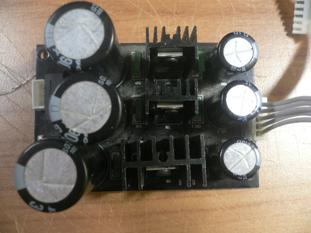

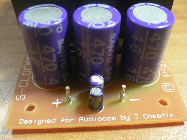

Ok,here i have some parts from previous projects that never finished and i wonder if they can be used in the cd-63 player.Problem is that i have no idea where to connect them if they are any good for the mods,so any help will be apreciated.
1.Power supply with transformer for the s-clock(very old but work as it should)which gives 13.02 volt output measured with a multimeter.
2.Regulated power supply from a lampucera dac without a t/x and it has on the big heatshink a l7805 and on smaller heatshinks l7912 and l7812.
Can those parts be usufull for the cd-63?
Thanasis.
Thanasis.
The power supply for the s-clock is of basic design that has no voltage regulation and prone to be noisy. If you want to use it for your future low jitter clocks you need to add some low noise regulators to it.
The regulated power supply circuit is also of basic design using cheap 7805 (supply +5V output) and 7912 and 7812 (providing + and - 12V output). Your CD63's analogue rail is also using 7912 and 7812 for the two op amps. Therefore this unit is of not much use when you mod your CD63. Actually in order to improve the performance of the analogue rail what you need to do is to replace the two on the board 7812 ans 7912 with two very low noise voltage regulators such as Fidelity Audio's S-Power.
