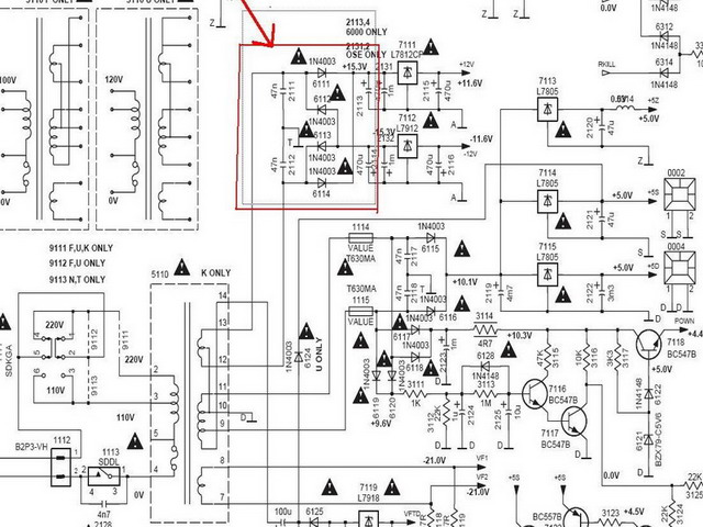

Another problem question: I freind with the CD6000 gets only 0.6 Volt at the positive pin of the 2119 Capasitor (it is a 4700uF 16V ELNA). Now i got his CD player here and i see that mine has there 11 or 11.8 volt IIRC.
He said he tryed to pull current from the 2111 chokes beside the diodes. They are 47nF value.
What is wrong there?
