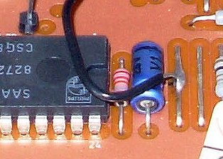

Right, I think I've solved my reg problem.
I removed the wrong resistor from the 5v line
I have now lost said resistor and really need to know the value. I've attached a pic, so is the nice fellow who also has one of these players could kindly tell me its value, it would be very much appreciated.
It goes from the 5v input to ground, any ideas as to its purpose?
Lee.
Lee.
