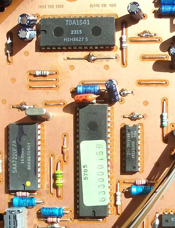

Hi Folks,
i would like to tun-up my Marantz CD-60 and i need some
assistence to build it to a NON-OS by using the TDA1541A !
I read a lot about the 1541A here in the DIY-Audio
Forum but i can´t apply direct to the PCB !
I got the Service Manual and I want to change a lot of Part´s
like exchanging all Resistor where Sound passes to NON-Magnetic by Vishay-Dale or all standart CAP´s relaced to bigger ones by Nichicon MUSE and Panasonic FC Gold Series !
Normal Foil CAP´s out and MKT in.
DIODES like 1N4002 kicked by Schottky or IXYS-Diodes !
But the MAIN-THING is to make a NON-OS Player !
Does anyone got experience with the CD-60 and can help me ?
Also witch one is better Nichicon MUSE, Rubicon or
Panasonic FC ?
Vishay-Dale or TKD Resistor ?
best regards Carracho

Carracho said:@ aparatusonitus
did you allready disabled the Digital Filter by cuting
3 lanes ?
As I've already stated in the link above, I did a nonos mod by cutting a 3 lines from SAA7220 to TDA1541A, bypassing 3 lines from SAA7210 to TDA1541A as in image.
Carracho said:sounds a little bit more stable ;-)
I'm not shure what you mean by that...
