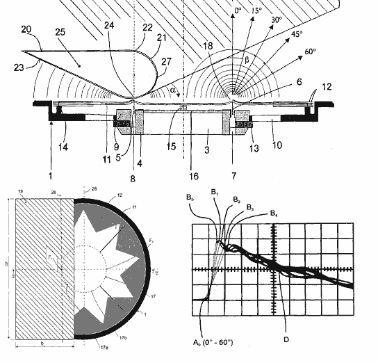

Here is the example of optimal enclosure for MSW. We made it from MDF and various damping. It is like very heavy dinosaur egg. Sure the capacitor must be high-quality. We will use Mundorf Supreme Silver/Gold.
