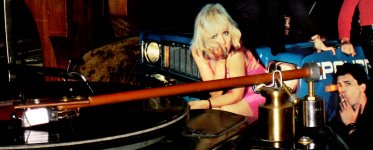

"Man on Wire" unipivot tonearm.
Regrettably, I have nothing decent here to compare to and I am new to analog, so to speak...so I have refrained to comment about sound.
I will say though, that the last arrangement opened up the sound quite a bit and that increasing the equilibrist bar's weights seem, until now, to make images more dense and increase dynamics... :cool: I need further listening sessions because one can easily fool oneself.

As projects go, this is a great learning experience. As far as unique or creative, it's been done before. Simple unipivot designs have been done (see Altmann's simple tonearm which is the basis for my "219" tonearm), as well as "outrigger " type weights to balance the zenith angle.
I bring this up because I've "been there, done that". In no way am I trying to take away from maxlorenz's efforts, which are worthy for self edification.
Considering the amount of lateral and vertical inertia, one can have too much of a good thing. Tonearms need to be able to allow the cartridge to track the groove. If too much vertical inertia in the arm, as the cartridge traces the groove the cantilever can flex towards the inside of the record groove. This was a consideration when I was reminded by a reader about the Audio by Van Alstine's "Longhorn" modification. That's why I consider the Longhorn approach to work well (at least for me and my tonearm).
I encourage anyone interested in improving the fidelity available to them via the LP playback system to try either maxlorenz's approach or the Longhorn. I'll keep my observations to myself so as to not influence others via the power of suggestion.

I am not claming "uniqueness". I went tired after visiting a few threads here to see if this kind or arm was published before, as the forum rules recommend, so I don't know if the aproach is known or not. I can asure you that it came to my mind with no external influence. As if this is panacea or not, I'm inclined to think that it is not, but since I won't pay hundreds nor thousands for a hifi arm, I will probably never know...unless some more experienced guys make something similar.

maxlorenz: I guess I was just clarifying that similar designs have been done. I never claimed my "219" was anything more than a refinement (perhaps) of Altmann's design. On his site there is a link to a tonearm made with a violin bow.

max: it certainly appears that you are moving along in the right direction
On 90º turntable rotation: Yes! Of course this depends on the cartridge and turntable, but generally if a motor can be placed furthest away from the cartridge noise (induced hum from the motor , etc) the better. This is why I think re-clocking the LP-12 has many fans.
No doubt the magnet wire is picking up hum, and the cartridge could be as well. Certainly turning the tt in relation to the tonearm is a smart thing to do. When this is not practical (for whatever reasons) magnetic shielding can be accomplished using "Mμ-metal" foil. It is quite expensive, but is a good solution. Make a cover for your motor (without touching any wires;) ) out of some sort of non-conductive material and apply the shield to the cover. Remember any moving current can induce a magnetic field.

the Debbie looks gorgeous...
...and the tonearm too ;)
Actually very similar to the "219" and Altmann arm. The angled outriggers will work for setting both azimuth and resistance to lateral inertia. I just like it (the inertia resisting mass) to be closer to the stylus tip, that's all.
