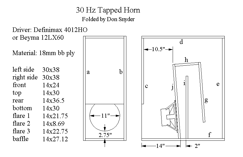

Zobsky, I think we have a misunderstanding, I want to build two enclosures with one driver in each. That way they will be in stereo and each will be smaller. I'm in the process of rebuilding the 2.7's (both frames and crossovers) which won't be cheap.These will be to supplement the lower end because with the rebuilt Maggies they should have much better bass. I'm not expecting them to go as low as the huge SDA-SRS 2.3tl's in my theater but the 2.7's have unreal clarity and accuracy just a little light in the lower end. I've got a diy vented passive using my old SVS 12" driver which is being driven by one of the 565 monoblocks which has clean deep bass but I need to figure how to increase the lfe signal coming from my avr because even at the max setting it is not pushing the sub hard. I'll try and work up some sketches and I'm sure I'll have more questions- here's one now! Any pics of these builds in progress and then completed? Thx Dean
In that case, halve S1 and S4 (length remains the same ) and adjust the design accordingly. Increasing the overall length (and maybe the cross sectional area) gets you lower bass, at the expense of a larger box. Hornresp sims will tell you the rest of the story. It shuoldn't be hard to install and work with on a windows XP , vista or 7 machine.

Here's a guide on how to double fold a tapped horn, if that's what you want to do. http://www.volvotreter.de/downloads/Folding_a_Tapped_Horn.pdf

I don't really have the time to go into a detailed lesson here, but it can be broken down pretty simply. Once you have a model you can translate it to the real world pretty quickly.
For the simplest tapped horn/TTQWT, we are worried about areas in a tapered enclosure at four places and the lengths between those areas.
S1 = Throat (small end in a TH, large end in a TTQWT)
S2 = Driver entry 1 (Center of the driver cutout in the baffle)
S3 = Driver entry 2 (Center of the driver cutout on the other side of the baffle)
S4 = Mouth (Large end of a TH, small end of a TTQWT)
L12 = length from throat to center of driver
L23 = length from driver center to driver center
L34 = length from center of driver to mouth
In hornresp, numbers are metric - square cm for areas, cm for distances.
What I do for a single fold layout:
Divide L23 in half, then add the larger of L12 or L34, this is your total baffle length.
Set the width of the baffle to a convenient number (large enough to fit the drivers width-wise, small enough to fit the drivers depth -wise)
With this internal width - I determine the cabinet width and establish the layout of the tapered path. Though not exact, the rate of expansion for a conical enclosure is closely approximated with a simple slanted baffle in a rectangular enclosure, certainly close enough for our needs. I lay things out full scale on one of the cabinet sides (usually takes me several tries).
Then- it is simply a matter of cutting out the parts, cutting the driver holes, and putting it all together. Bracing is a good idea when panels are wider than a foot or so, especially with 1/2 inch material.
