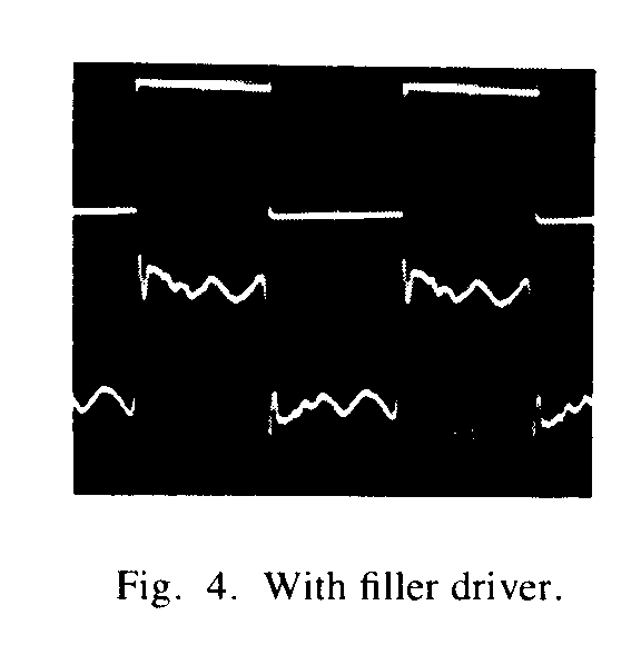

B&O was very big on this when they were promoting their filler driver, "the missing link" innovation....The paper is in the AES "Loudspeaker anthology".....title "A Novel Approach to Linear Phase Loudspeakers Using Passive Crossover Networks" Erik Baekgaard
There are oscilloscope traces in there, they're square more or less, much better than most speakers but nothing like an amplifier.
Pete B.
For those interested, I have that paper scanned. Nothing fancy-no pdf. Each page is in GIF, as if it had come from a copy machine. Anyone who wants it sent to to them just Email me. :)
Here are some oscilloscipe traces for on axis response. As you can see, they are very good.
The article also gives the method to make a third order crossover with the same qualities.
Here is the second order square wave response. This wave form is for a second order crossover at the crossover frequency.

Hi Tom,
Good to see you again, last time was 5 or 10 years ago by e-mail.
B&O was very big on this when they were promoting their filler driver, "the missing link" innovation. There was a large white paper from the company and an AES paper. The paper is in the AES "Loudspeaker anthology" Vol. 1 - Vol. 25 (1953-1977) with the title "A Novel Approach to Linear Phase Loudspeakers Using Passive Crossover Networks" Erik Baekgaard
I was impressed with the innovative thinking in this project, but it's rather complex for what you get in the end.
