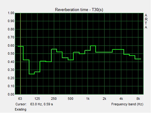

Here's the T30 response in my room. The T60 reverberation time (shown in the Energy Decay window) is 0.430 s. This is with both speakers playing and the mic in the listening position pointed upwards. Input is swept sine.
I don't really know what to make of this. What do you guys think?

ra7> Here's the T30 response in my room.
The wobble from 0.4 to 0.6 is "nothing". (RT has only marginal effect on frequency response.) The dip to 0.25 at 100Hz sucks important bass. My guess is that this is drywall on studs(?). Pound on the wall, does it boom 100Hz? There's no easy fix for this. A second thickness of drywall would shift it down to 70Hz which is still important bass. Four layers would shift to half, 50Hz, which is perhaps more important since speakers are working hard down there. Heavy stuffing *might* reduce the resonant suck-out, but not much, and is hard to do after the fact. While open: Doubling the studs shifts the resonance up to 140Hz, still not a happy point. Spacing studs randomly 8" 16" 24" might spread the suck-out but drives the drywallers crazy and leaves weak spans, easily damaged. What would work is 8" solid concrete, strapping, and then drywall; again this is not usually practical in domestic work.
Aside from some carpet and thin panels to suck-down mids/highs a bit, I think what you do is have plenty of 100Hz in the system (speaker selection or EQ).
